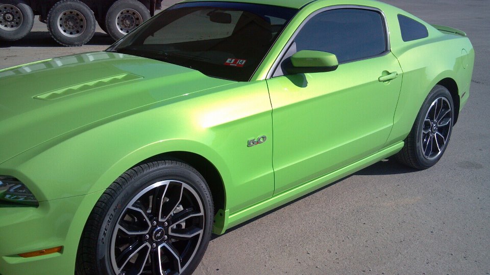

I know this is an old post-but i used your springs on my car and thought id post a pic . I have had 3 gt's and always lowered the back back for that level look. I really like the springs . In past ive used roush ones and a pair of suspension dynamic shocks to soften ride a little. This time i used your spring and the sd shocks. When you drop the back it gives car thay nice levell stance. At shows i get asked all the time did i lower whole car. My car isnt a brembo car. They are a lil stiff for my tastes even with sd shocks but they are livable. On a non brembo gt though you gotta use a better shock or ride is harsh-or at least i think so, but thats with any lowered spring. They are a decent product and id encourage all to do it if you want a cheaper way to give your car that level rake! 1st pic is before mods .2nd one is current state with 66 springs etc..last pic hek i was just happy they took my pic at the drags lol.
I have soime new coys c5 wheels and tires if i ever get a free day to put em on.
