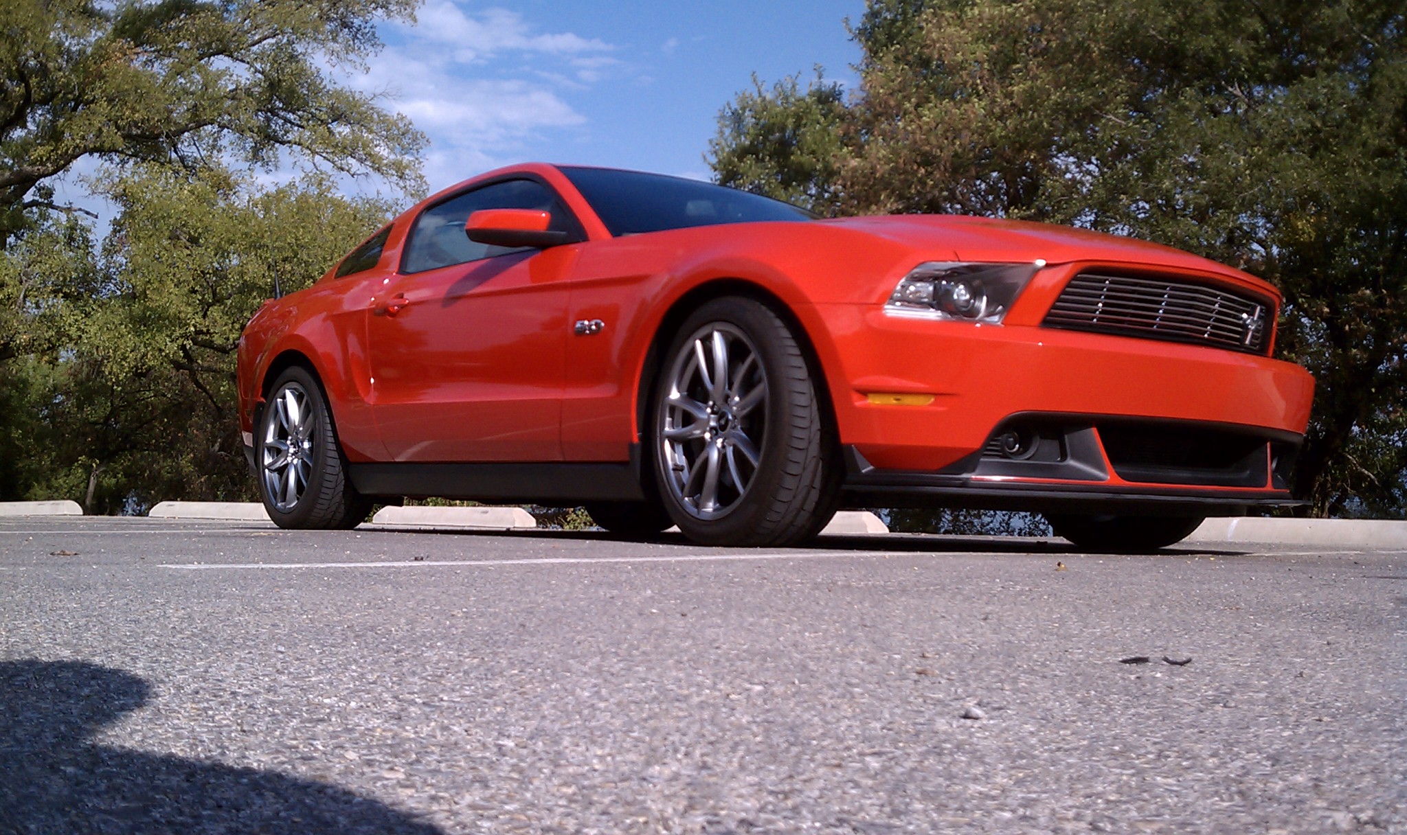

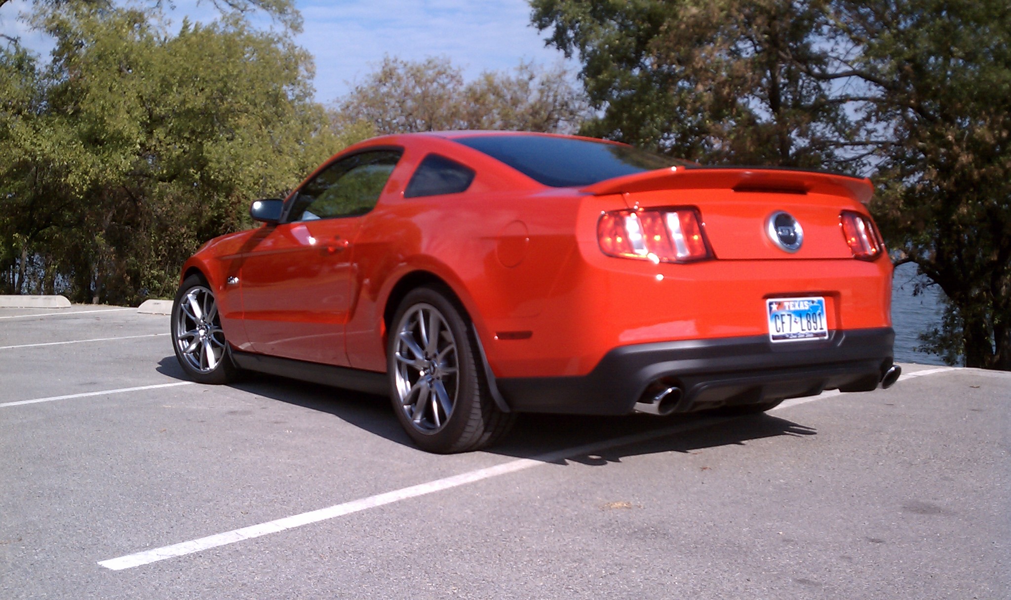

I like the "after" look, with the rear lowered.
I've always thought that the Mustang sits WAY too high in the rear in stock form, not sure why Ford feels the need to do so.
But I have to wonder, couldn't one just buy their choice of lowering springs out there and only install the rear springs?
I haven't looked into the options available, and I'm not sure if there are any that will only lower the car "less than an inch" in the rear, but if there is one, that could be an option, no?
Looks like the Ford Racing P-springs will only lower the rear 1" ... why wouldn't they work?

I don't know your name, so I'll call you Bruce. I appreciate the observations, thoughts, and networking you did concerning the subject. My thoughts go very much like yours when thinking about the same things you did. I did a build on my car that I aimed at trying to better what the Brembo did as a step up from the standard GT, while retaining as much as I could from what the factory designed into it and keeping a very OEM look and feel to the overall package. On the street it feels fantastic. What it would do for a couple hard laps on a road course is still unknown, but would like to find out some day with a good shoe behind the wheel. If my pics attached, there are allot of changes on the car that aren't seen that I'd have to list, but 1 note is that the rear wheels are 10" wide with 285 series Pirelli's mounted. Anyways, good job. Did you happen to determine what the spring rates are for the Brembo cars in your talks with engineers at Ford I presume? Thanks - Russ
When I bought my 2011 Brembo Brake Package Mustang, I knew that it also included a totally different suspension system, than the standard GT.
The Ford Engineers designed the Brembo Suspension to work at its maximum while retaining everyday drivability.
To bring it to this level over the standard GT, Higher springs rates were used, struts and shocks were revalved and the electric power-assisted steering, (EPAS) was custom tuned to work within the parameters of the suspension, thus creating a “perfect” suspension package.
To illustrate this point, look no further than the testing done by Motor Trend magazine (Oct 2010) that took a "stock" Brembo Mustang to the "track" and achieved an average .96g in lateral acceleration and a Maximum number of 1.3g on the race course. That's "supercar" performance.
However, the one thing that disturbed me and many others was the fact that the wheel well gap between the fender and the tire was 3/4” higher in the rear than in the front. Creating an abnormal "bug like” stance.
While there are many Lowering Spring Kits currently available that can get rid of the “ugly gap” or “stance”, none of them are the "true" solution and here are the reasons why.
Slamming the car down may look cool, but it has many side effects that will hurt the Mustang's performance characteristics. Lowering the Mustang more than 1" will change the suspension geometry, which will require other components to correct it. Control Arm angles change, and its arc motion become limited vertically. Camber/Caster angles go beyond what factory specifications and parts can handle. Super high spring rates will add to your traction loss off the line and may lead to snap oversteer in the corners, not to mention that the ride quality of the car will go to hell.
If you don't believe this, then look no further than Ford's very own 2012 Boss 302 Program. These cars are designed as a true dual purpose “track/street car”, and yet they do not even use Ford Racing's current offering of the 5300-K or P Lowering Kits, made by Eibach.
Instead, the Boss 302 uses the same "spring heights" as the current production Brembo Mustang with slightly higher working spring rates that never exceed 200lbs.
Some will argue, that they have all the “trick suspension” from what the aftermarket sells and that their suspension will perform “better than stock”.
While this may be true for an all out “road race mustang” or if you do a lot of “autocross” events, it’s not true for the majority of Mustang Owners.
The aftermarket Industry has done a fantastic marketing job, convincing 98% of Mustang Owners, that they NEED to have these parts in order to have "high performance".
But lost in all this hype is the simple fact that the majority of Mustangs never see “racing conditions”. With that said, why would these Mustang Owners want to compromise their finely tuned factory suspension system, sacrifice their ride quality and of course, lighten their wallets with the continuous need for other suspension components that are not practical for most Mustang Owners who do everyday driving.
After a year of researching spring rates, blueprints, talking to engineers, racers, and mustang owners, I finally had a set of goals to aim for.
I wanted to retain the factory ride quality, I wanted the suspension to perform the same or better and most importantly I had to have the correct and equal stance that the factory didn’t give the Mustang.
Working with a major U.S. spring manufacturer, we utilized several computer programs to design and test my new spring. Finally, real world testing of prototype springs were put on vehicles to test in real word driving conditions on the mean streets and highways of Southern California.
All the work culminated, into the 55D Spring Kit specifically designed for the 2011-2012 Brembo Package Mustangs. This kit has many advantages.
First, it lowers the rear end of the car by 1/2” and gives the Mustang a much lower and equal stance with a very slight rake.
Second, The Lowered Spring height also equalizes the “center of gravity” front to rear for improved handling, thus allowing the car to feel "flatter" going into corners and provides confidence to the driver at the wheel.
Third, the Brembo Suspension System has not been compromised due to the fact that the OEM Spring Rates are still retained and continue to be tuned to the OEM struts and shocks.
Finally, because the 55D Spring Kit only consists of rear springs, there is no need to have the front end re-aligned. There is no need to buy expensive adjustable struts and shocks to soften the rebound. There is no need to buy new strut mounts. There is no need to purchase aftermarket camber/caster plates. There is also no need to buy an adjustable panhard bar, because the rear end doesn’t shift due to the fact that the car hasn’t been lowered beyond 7/8” of an inch.
So there you have it, the 55D Spring Kit, gives your Brembo Mustang,
The Ride, the Look and the Performance, without the headaches.
