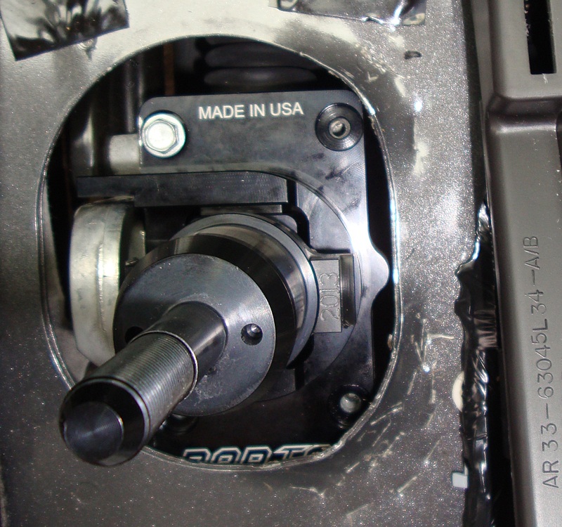

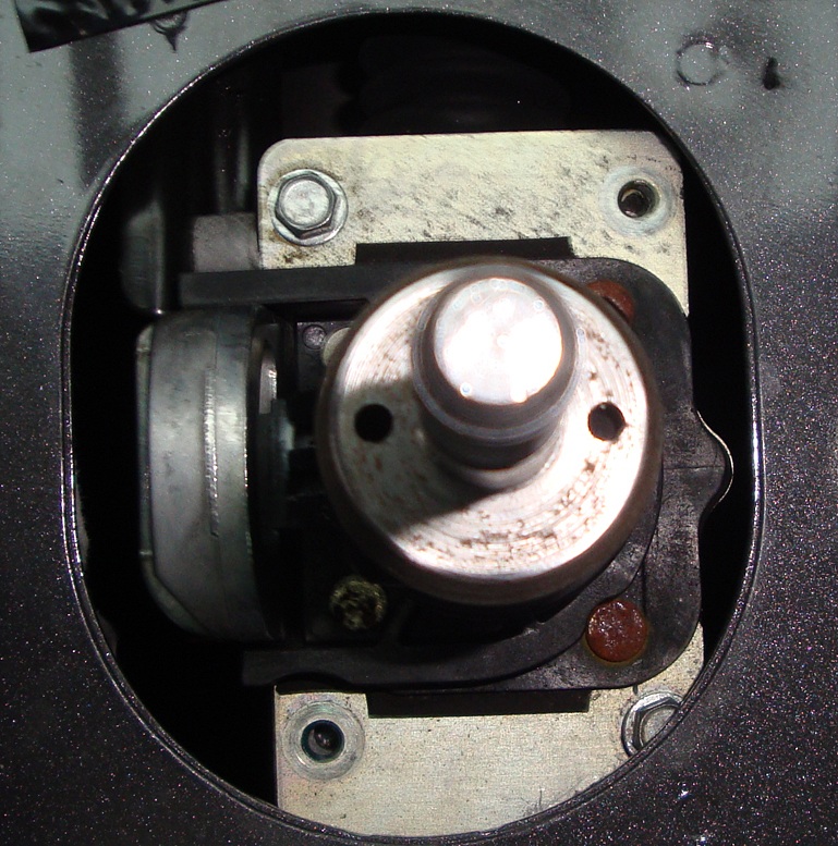

The problem (bottom-right bolt):
My solution, bending up the "corner" for access:

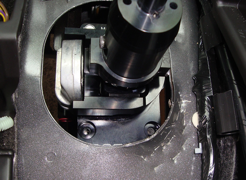

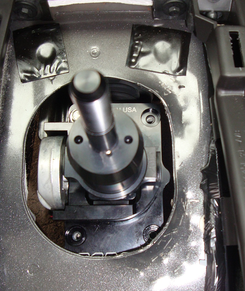

I also bent up the top-right "corner" so that the Barton shifter's larger/thicker base would fit:

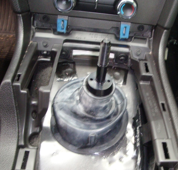

The rubber boot fit back on just fine:

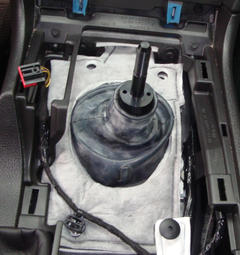

Insulation back on:

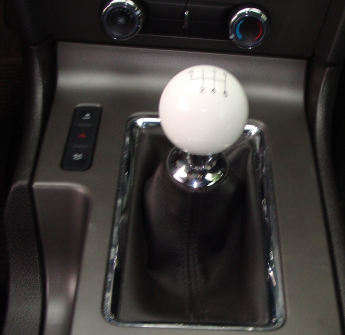

All back together, eBay chrome spacer and EPCO shift **** re-used:

Originally Posted by Rog13GTCS
Congrats on your install. I guess you didnt want to get under the car and you meant it! lol.
I was forced to do this.
I had the front of the car on ramps, the right rear axle tube on a jack stand, the right front frame on a jack stand, my head was directly under the bracket.
I was able to loosen one of the nuts with the required 10mm deep socket.
The other nut was smaller, the 10mm socket was spinning freely on the nut, a slightly smaller 7/16" socket was grabbing but only a little, and I didn't have smaller sockets.
So I tightened the other nut back up, called Barton, and the guy mentioned the possibility of bending the metal ... so I did.
And now I'm posting this in a few places in case others don't want to get under the car, they can see what would need to be done

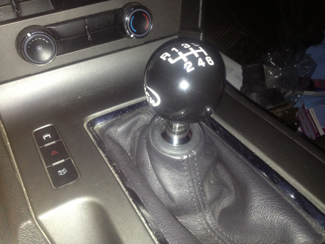

I did.
The install was a breeze. It's been almost two weeks and I really like how this thing feels. I love how detailed the install video was. The guys over at MGW really did go through a lot to build a perfect shifter.
