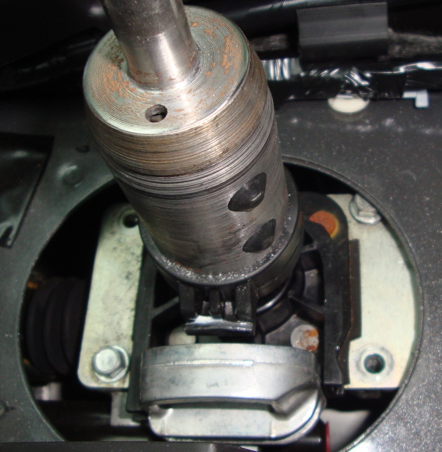

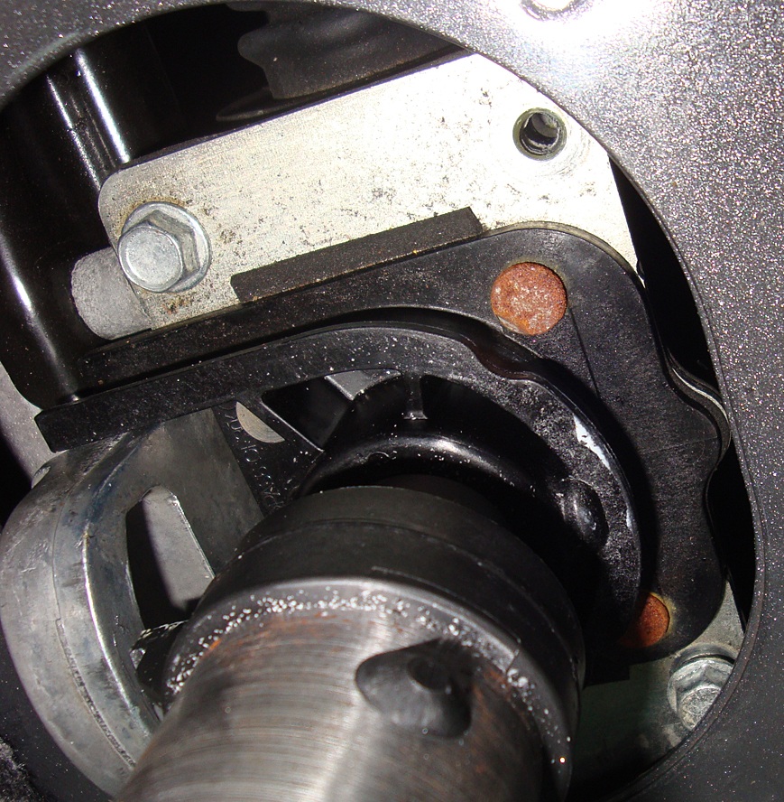

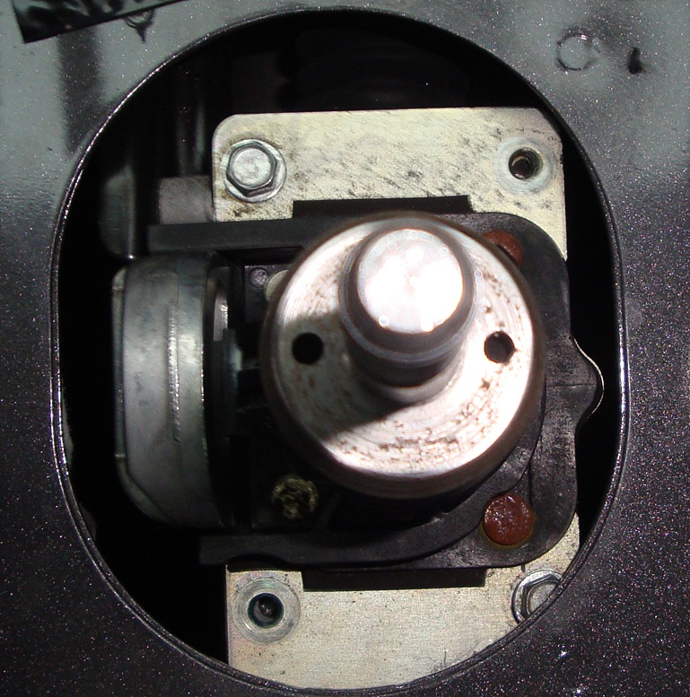

Just tried to remove the old shifter and there's absolutely no way I can remove that bottom-right bolt without removing the shifter bracket under the car.
Ran over to the very-nearby Autozone, bought an extension I'll need for that, also bought some more white lithium grease for the shifter ball that goes into the lower assembly, and will get back to it tomorrow
Gonna be interesting if I have to take the Barton bracket apart in order to remove it since I already have it installed under there ...
Oh, and there's no way I'm gonna grind any metal there ... that area is exposed to the elements and I don't want rust to eat away at that metal

what I did and other LS2GTO.com folks did with the GMM Rip Shifter (because it had the same issue, had to drop stuff) was to drill a small hole right above the bolt. That way you can easily access the bolt.
That's a great idea but this bolt is only half-hidden by the metal that's about 1/4" above it, so drilling a hole wouldn't work since it would mess up the cut-out for the shifter boot.

Thank you Ford for another great idea
Thank you Ford for another great idea, God forbid you might've designed the access hole so that all 4 bolts could easily be removed from above without having to get under the effin car!!
Well, you still gotta get under there if you wanna install the bracket. But I agree, I guess Ford couldn't imagine there could possibly be room for improvements over their stock shifter? Lol, when my MGW comes in maybe I'll take a road trip over the the ford plant and chuck my stock shift through there design departments window.
