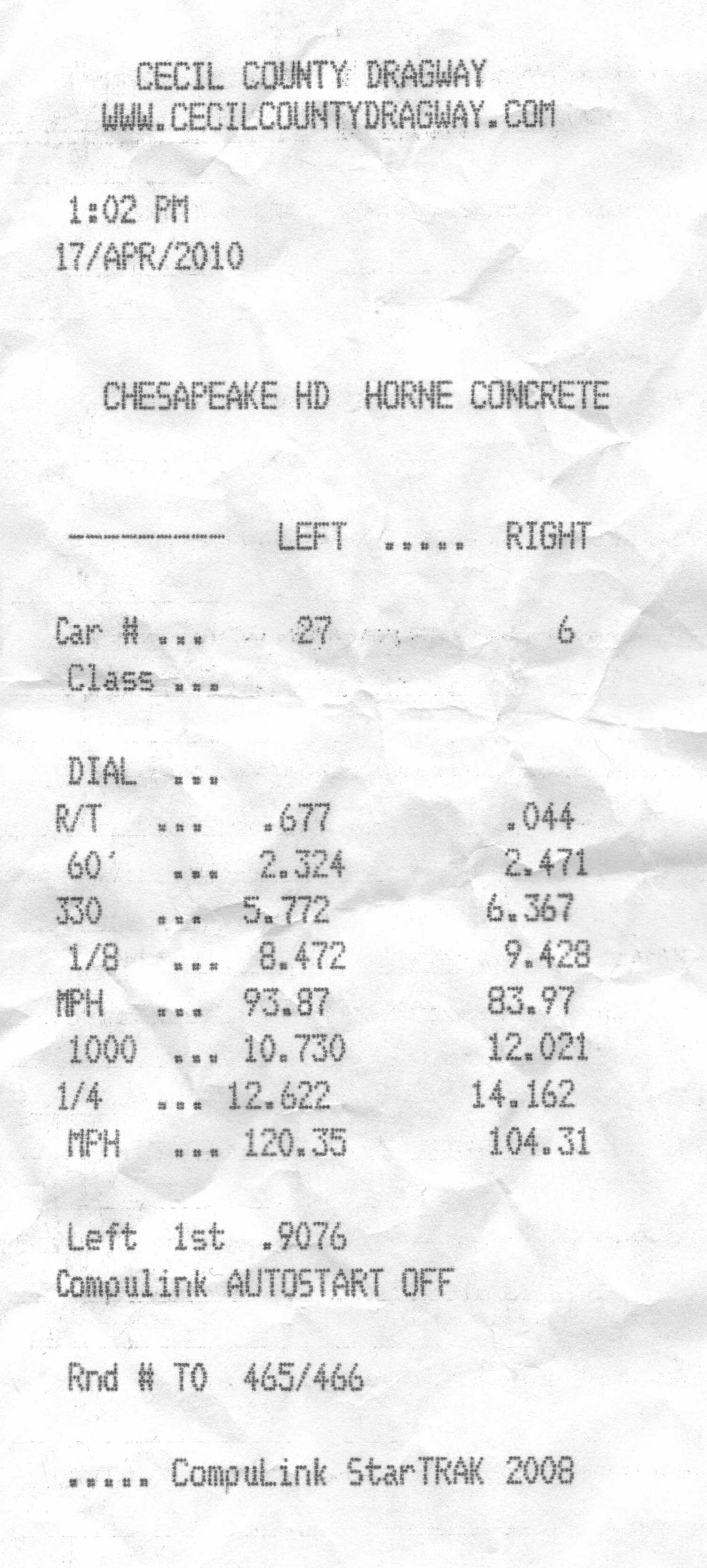

I was up at Cecil County Dragway today and ran the car a dozen times. My best run was 12.622. I was having problems launching the car. I'd either spin like crazy or get bogged down. I kept having to make it up on the top end. I've got a fast street car, not so much at the track. It was a lot of fun though and I'm looking forward to going back soon.
Just incase anyone is wondering
Stock weight including air pump and crap in my glove box and center console.
I'm 6'4 235lbs
Half a tank of gas

it's all good, i bet you had fun and that's a lot of passes
at 75-80 i would only get 3-4
looks like 4-5 10ths is in the 60ft, you need drag radials
huge trap speed, should be like a very low 12 sec pass with that mph

No, that trap speed is good for a mid 11 second pass if you could get it to launch hard enough.
Definitely need some drag radials or even slicks.

You should see how bad I was launching. In the hands of a good drag racer my car could do so much more. To be honest I was afraid I was going to loose control at times. It felt like I was on ice going down the track.

Exaclty, Got a friend running 11.5 @ 121.4 MPH He puts down 1.9 60' times. He's on Mickey Thompsons though

1.9, I bet he was still spinning crazy. a 28" slick will cure that problem. With 1.6's you'll see those mid 11's
I'm cutting 1.7's on stock 3.55 gears, you guys just need a bigger slick since power is not a problem for you guys lol

Were you racing that guy for a dollar?
I've seen marked improvement in 60' by lowering my PSI in the rear... Reason is that it allows more side wall flex for better grip on launch. Next toime you go, give it a try. If you're still on the stockers, just drop them to 23-25 psi.. Down from the normal 32 you should see a little more bite on launch. Assuming you launch the same (same rpm, clutch release, etc - this in and of itself is challenging and takes more practice than I've had time to give it).
