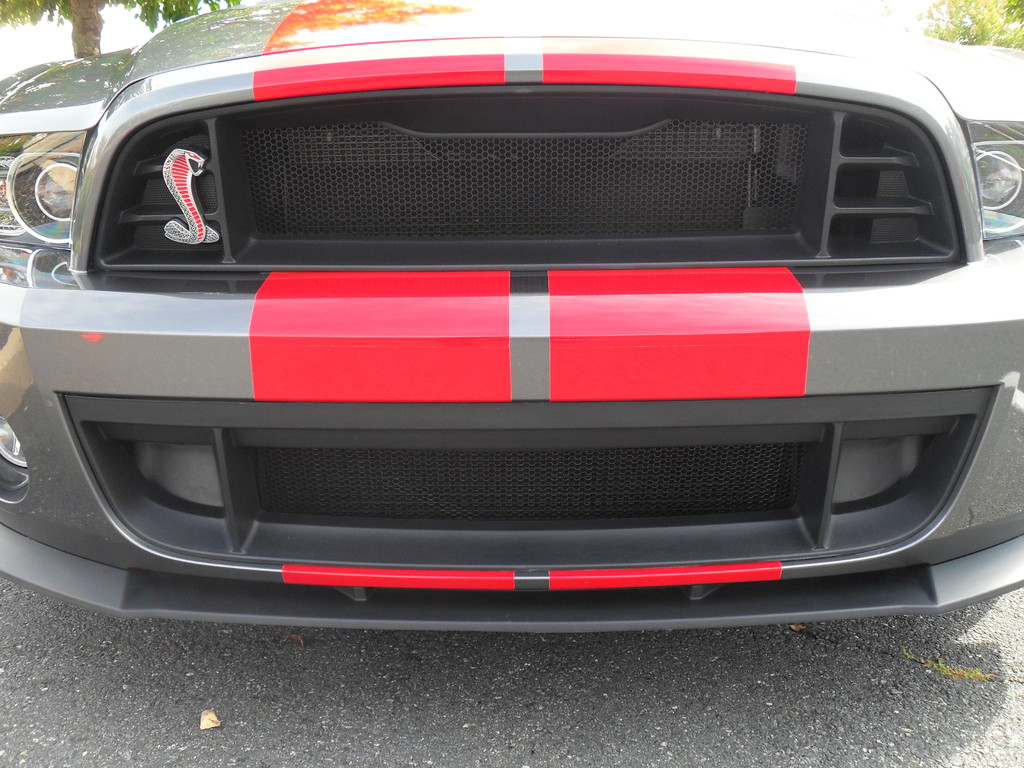

I know the 11 & a 14 grilles are the same size, the 2010 " should be " the same size.
One of the 1st mods I did on my 14 was to protect the heat exchanger, a costly repair your insurance may or may not cover.
..........................( a $ 60.00 insurance policy )

love the look. where u get the material?

Lots of places for that stuff. Have fun!

Don't know if you got your answer, but the grills will fit, same mounting points, but the bottom grill will require some cutting on the grill or the bumper. The 10-12 bumpers have a piece that goes across the outer holes on the lower grill, so it will not go all the way in unless your trim the grill or cut out the piece on the bumper. Cutting out the part on the bumper looks better though.
