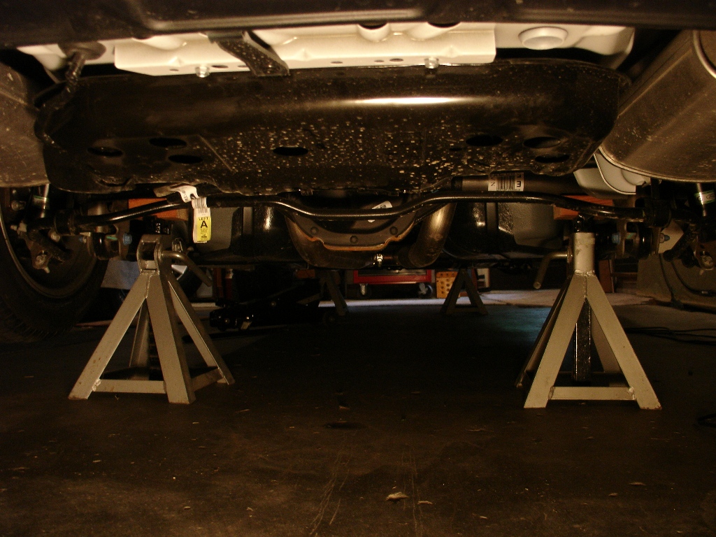

Counter weights?
Originally Posted by FireDragon
Mine is painted
Speaking of the rearends. What do those heavy/rusty counter weights in this picture do for the rearend's suspension? Ours came without these installed but the threaded holes are on there. Anyone know the answer on this one? CalStang
P.S. Sending picture of our rear axle on jack stands right after we brought the CalStang home. Note two things. No counter weights and how very dirty it was already with only 52 miles on it!
How you say? Because two young idiot salesmen took it out in the rain for lunch the day it came off of the truck. Because they just wanted to see how it drove out on the wet? That is what dealer demos are for dumb Sh*ts!
After about six hours of detail cleaning and also the black paint applications to the under carriage, it then looked better than new down there and was now ready for the cars shows!!

^they are for NVH harmonics and all that jazz. guess it would moan or vibrat or something without them.
Thanks fdjizm: The torque and twisting shock load harmonics makes a lot of sense with those factory installed jelly filled upper and lower control arm bushings. Our own diff-housing rotates way too much under load and unload sitiations!
Wondering if I should find a set off of a wreck, then paint and install them? Has anyone removed them to lose some axle weight? If so how did that affect your rear axle rotation feel when loading and unloading the clutch during hard accelration? CalStang

If the axis of rotation of the diff is the axle shafts, then the weights' location won't really help. They would help with vertical motion or rotation about the driveshaft. As I understand it, the cars are tested and the weights are added only as needed.
