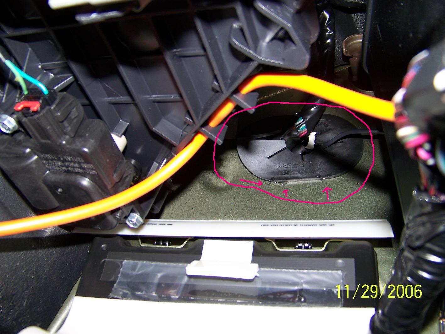

I’ll post pictures later but I narrowed down the entry point of the water to the cabin. Sorry, I was too concerned with finding the source and vacuuming up the water to download the pics last night. There is a grommet on the passenger side under the dash above the kick panel where a bundle of wires comes into the cabin. This grommet was loose fitting and there were water drops coming in around and under the bottom of the grommet.
The kicker is that FORD must know this is a potential spot for water to get in because there is a white hard plastic splash shield/rain gutter and some more plastic bag type material and foam over the top of the fuse box that is directly below this grommet. Seemingly, it should prevent any water from entering the fuse box should it get into the cabin through this wiring hole. You’ll see it when I post the pictures.

See the grommet circled and the arrows pointing to the water drops. The grommet is very loose. Ford had to have know this could be a problem. See the white plastic drip shield they put above the fuse box!!!!
I'd like to get under the car to see the path the water has to take to get in here...
It will go in to FORD as soon as this snow clears and some of the salt is off the roads.

Can I get to this grommet without tearing out stuff? What is the correct solution? A new/correct grommet?
Sounds like it is time to stuff paper towels in yet another area of the Stang

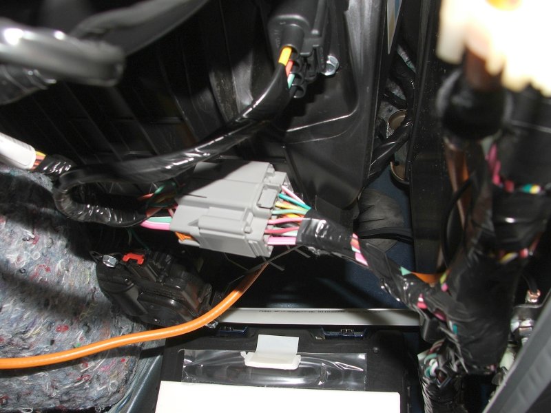

Here's the SJB setup on a 07. Did yours have a weird white foam sheet? Sorry for the bad pics... I basically aimed my camera without looking since it was in an obscure angle and I didn't know what I was looking at (no light!). After reviewing my pics in the camera, I realized that I did manage to capture the grommet in one of the pics.

I've got the white foam sheet there too.
Yes, white foam on my "06 also.
And about the grommet... you can remove it without disturbing the wiring bundle since the grommet is split to remove it without unplugging anything. If you look close at my picture, you mihgt be able to barely see that the long slit to the left of the loom goes all the way to the left edge of the grommet. It is hard to see because that side is in the shadow.
Yeah, it is difficult to get a good picture here. I was able to almost see my camera's view screen at a really hard angle to be somewhat certain I was getting a picture of what I wanted. Good thing about digital cameras is that you can just keep taking more pictures and delete the ones that didn't quite work out right...

How about just pulling the grommet out of the hole, applying some silicone sealer around the grommet, and pushing it back in?

Thought about that but I still want to know how the water is getting to that point. I don't think that grommet is there for water prevention. Looks like it is more to prevent wire chaffing. Too many slots in it. I think the water should be stopped beefore it get to that point. I'm leaning toward something that was forgotten (a splash shield somewher else or a missing beal of seam sealer) on the production line.
