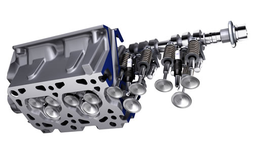

basically the lifters are just lash adjusters, and the cam sits above the valves and runs off a chain from the crank. the rockers roll from under the can and puch the valves down. I will see if i can dig up a pic.

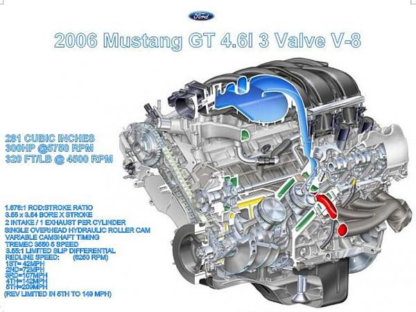

Originally Posted by 429 Boss Mustang
yea thanx bro i was wondering about that
thats why i said if in the first one
so if its overhead cam i dont know lol xD i been working on motors from 88 back so i really dont know what the inside of a over head cam looks like mind filling me in?
heres a exploded view of the head, and one of the whole engine...sorry for the text added to the engine pic- I was bored one night long ago while waiting for my ordered car...was going to print up a poster sized one for the garage wall, but never got around to it...the original pics are on this site somewhere(I think- if not it was the media.ford.com site)
