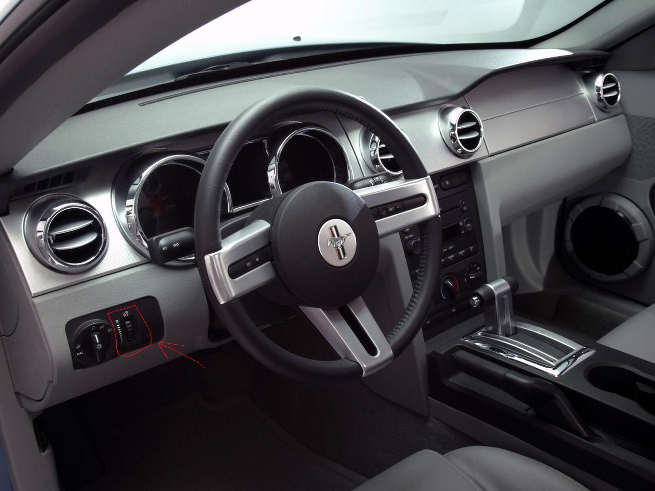

I am not trying to insult you Chad but did you try turning the wheel thats next to the steering wheel(I think that where it is) the **** allows you to adjust the brightness level of the interior instruments. Heres is a picture to help.

thanks for the input
but its not that
i found out that the tech didnt read the TSB and just installed the radio...so now without the PMI it has no lights per the tsb
