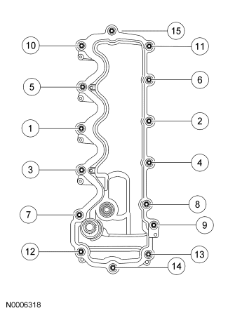

Two questions..Can the seal be reused and does anyone know the torque specs of the oil pan bolts?

pan gasket is reuseable if not damaged.
Tighten the bolts in 3 stages, in the sequence shown.
Stage 1: Tighten to 2 Nm (18 lb-in).
Stage 2: Tighten to 20 Nm (177 lb-in).
Stage 3: Tighten an additional 60 degrees.
