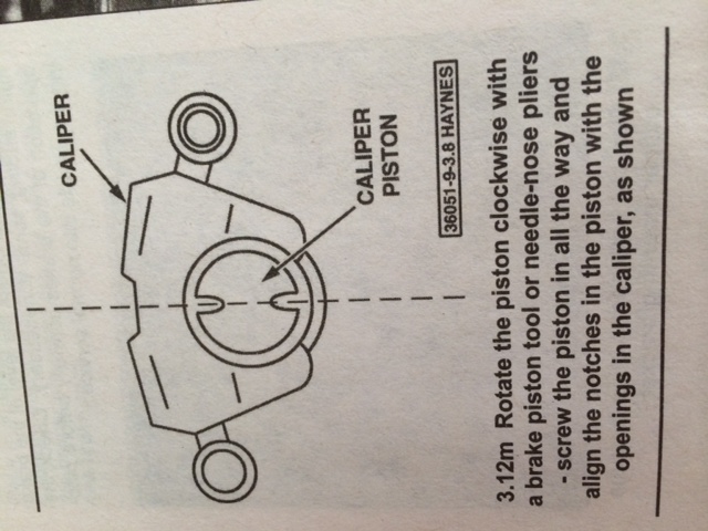

Unless the e brake pads are being replaced there is nothing to adjust. I just did my 2006 no issues. Make sure the Pistons are all the way in and the mark is lined up and you are good.
Thanks Jazzman. What mark do you need to line up?

Here is the Marks to line up:
Attached Thumbnails how to push in rear brake pistons-mustang-rear-brake-2006.jpg
