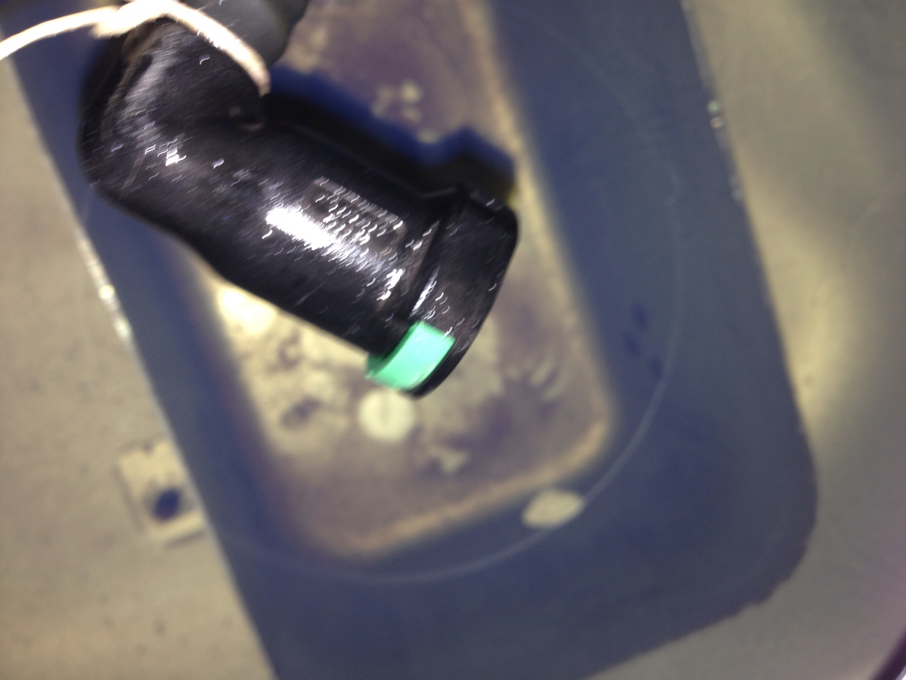

I have an 07 GT/CS & last spring after engine got warm it woul start to buck & run real bad under any load then die , I'd have to let it cool down before it would even start.
I then tried abottle of Techron in with the fuel to help clean the injectors up, then cleaned the throttle body as well the MAF sensor , ran better for a while then it all came back 😠 took out all fuel injectors and tested & clean all good ?
So I ordered a Delfhie fuel pump same as ford but half the cost .
My son Nathan & I put it in yesterday & you Want a new O -Ring for best seal. Low tank on fuel, remove pump relay #21 under hood & even battery cable , then pop out the rear seat & main pump is on drivers side, pust & lift black circular cup to pop out , disconnect power from pump red clip push & pull, I then tied a string around fuel line next before disconnecting incase it fell inward, disconnect & put a cover over pump outlet , oh wipe & clean area with cloth first.
Then upon repacement set in new o-ring set in pump careful float is out side of box in tank where pump would sit, there are two notches that have to meet for pump to seat proper then set lock ring over and start back clockwise to start to lock , Be very sure each part on ring catches before tapping back into place , if you miss one & go to fill us gas will pour all over , view to be sure its inplace with flash light , rehook fuel line & remove string then reconnect power.
You may want to leave seat out until you try a fill with gas to be sure, cycle key on off about 4-5 times you will here pump charge line then it gets to just a click, that's when I turned it over & wahoo ir ran like a sweet dream , took it for a drive to warm up engine , got on it & not hesitation at all .
By the way I could have just removed stock pump , cleaned it all up & collecter sock on bottom but I went new.

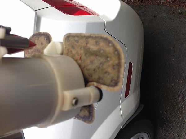

Dirty pump pickup /sock
Attached Thumbnails Fuel Pump TSB/Acceleration Hesitation-image.jpg
