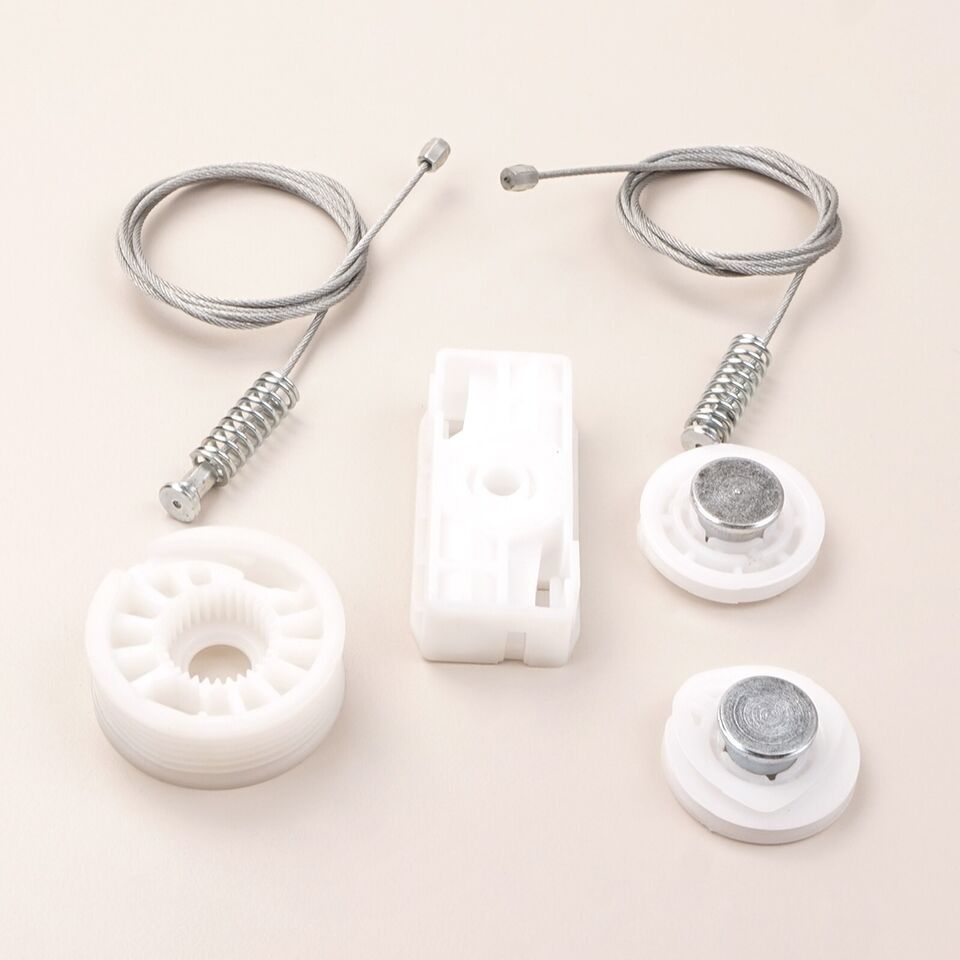

Found This Quarter Window Kit on Ebay The Other Day!
Just an FYI For Quarter Glass Related Issues!
Search on Ebay Down The Road if Link Goes Bad!
Rear Quarter Window Regulator Repair Kit for Ford Mustang S197 2005-2014
https://ebay.us/m/z2EUsu
