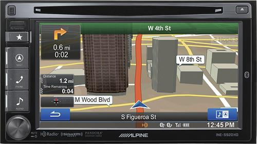

Also, if that's a picture of you Alpine unit, that the strangest looking one I've ever seen

Found out what problem was. When they installed the alpine they used my old iPhone cord that had a crimp in it. Sending faulty signal to car. And no that is not my alpine picture. Really happy with unit
