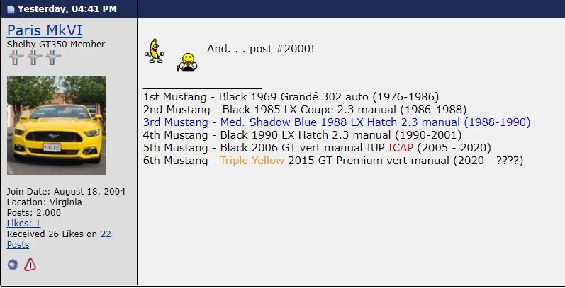

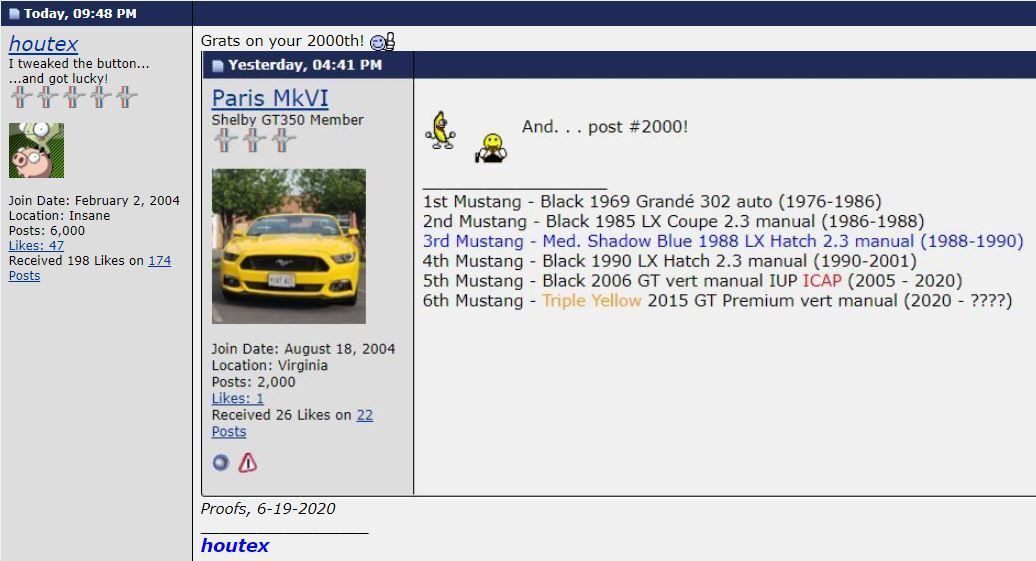

Grats on your 2000th!
Proofs, 6-19-2020
Edit: Well... that's amazing timing right there, folks, honestly unplanned and everything. Nifty. I should buy a lottery ticket or something, eh?
Reproofs.
