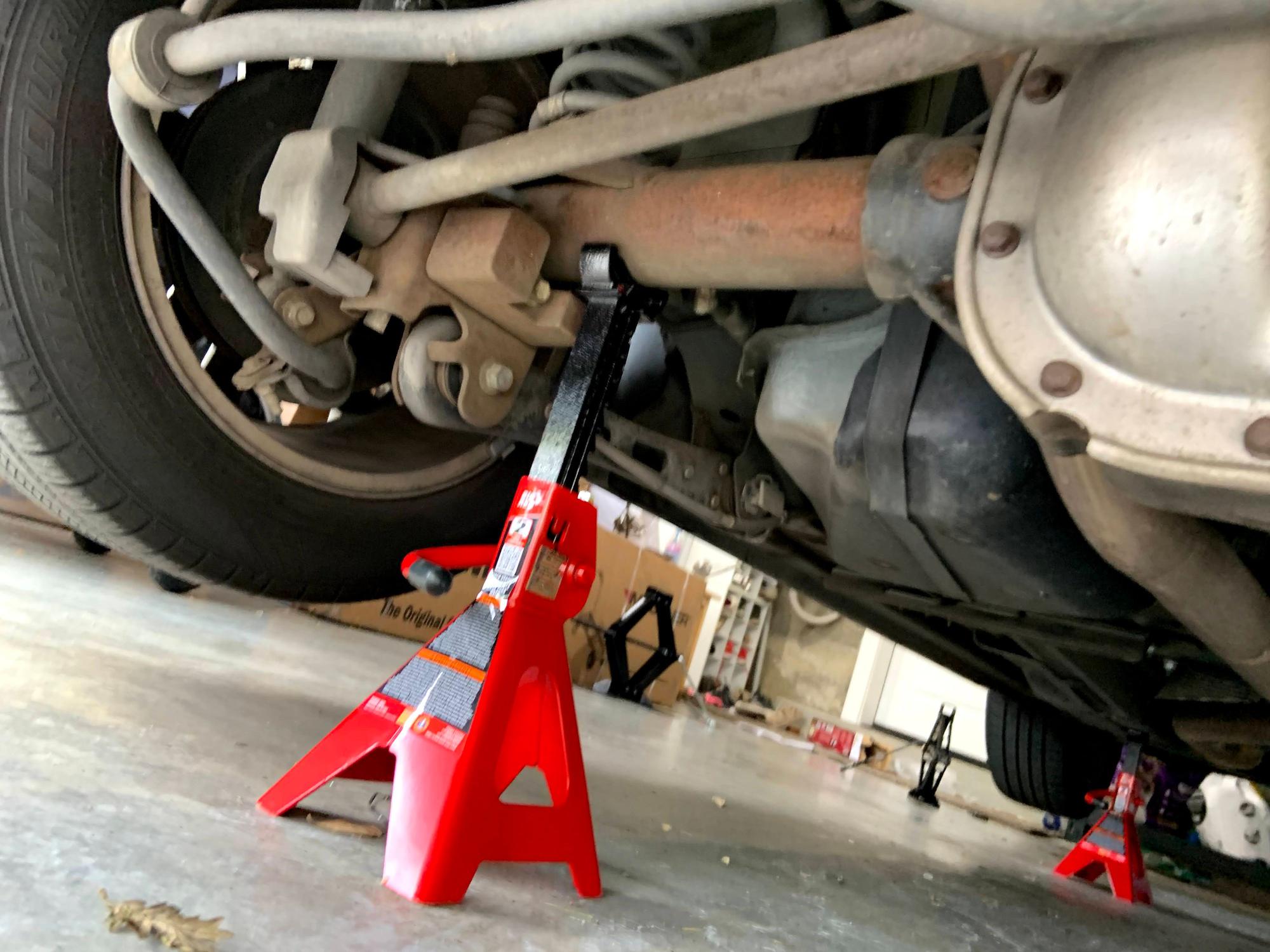

Hopefully these don't post super massive.
On another note, did I jack up my car correctly? There seemed to be a lot of differing opinions on the internet but apparently, these are the correct ones? The last picture is of another place a lot of people said that they put it. Is that spot better?
Also is it okay to leave my car like this overnight or do I need to take it down. thank you

Placing jack stands under the frame rails as you have them are one the safest locations IMHO. They can also be placed under each corner of the cross member as well. The rear axle tubes are also a good location. However, If your still not quite sure? your owners manual will be your best resource. . .
