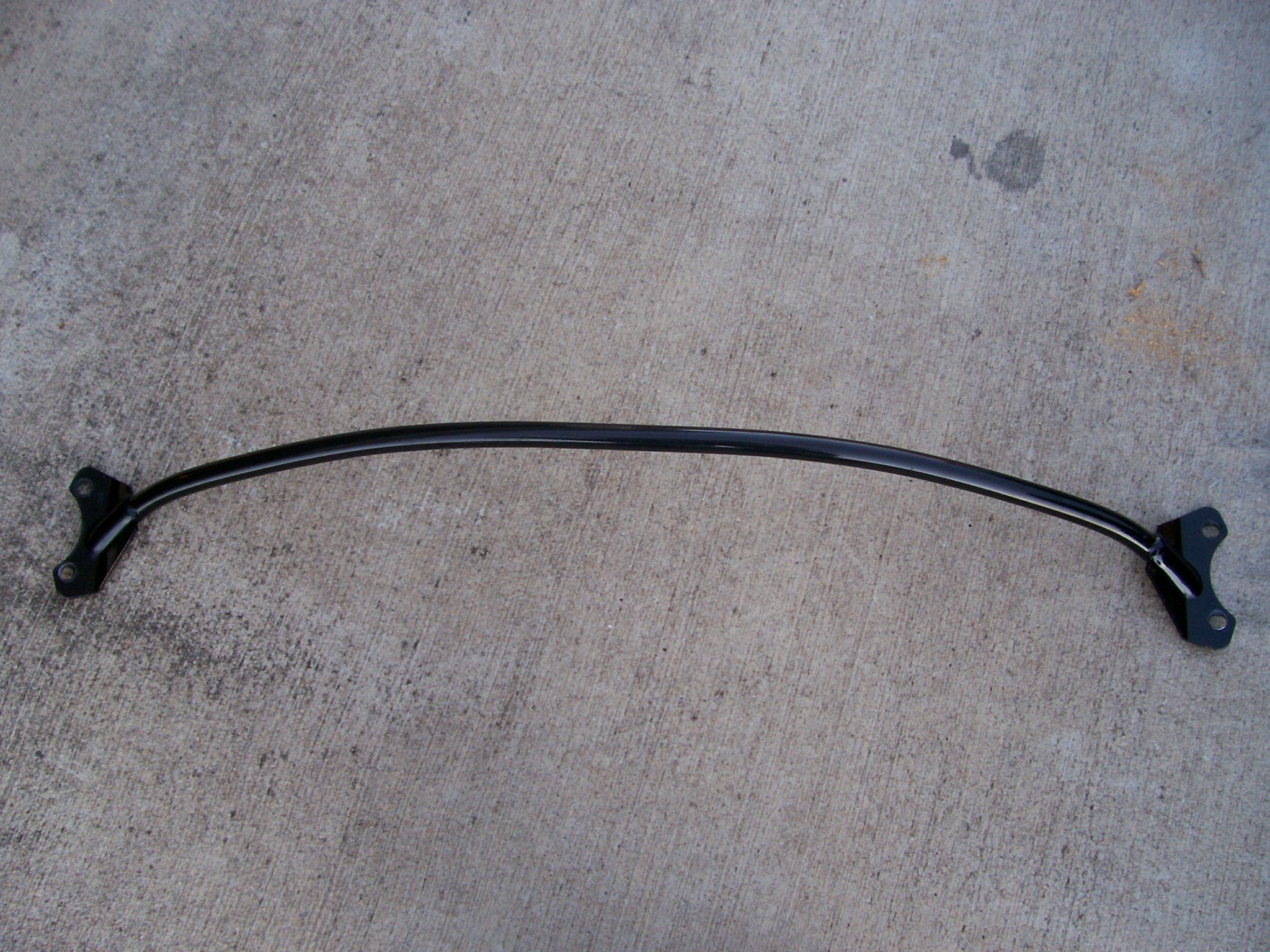

Does this help any? I am going to cut into the inside of the hood were it seems to be rubbing. Hoss, I might call on you also!

Don't cut anything.
It looks like a Shelby alright.
Made for a totally different hood
That looks the one for the GT500.
Get a GT500 hood and you will be fine.
Sounds great to me!

Don't forget the supercharger, it looks like that will fit too.

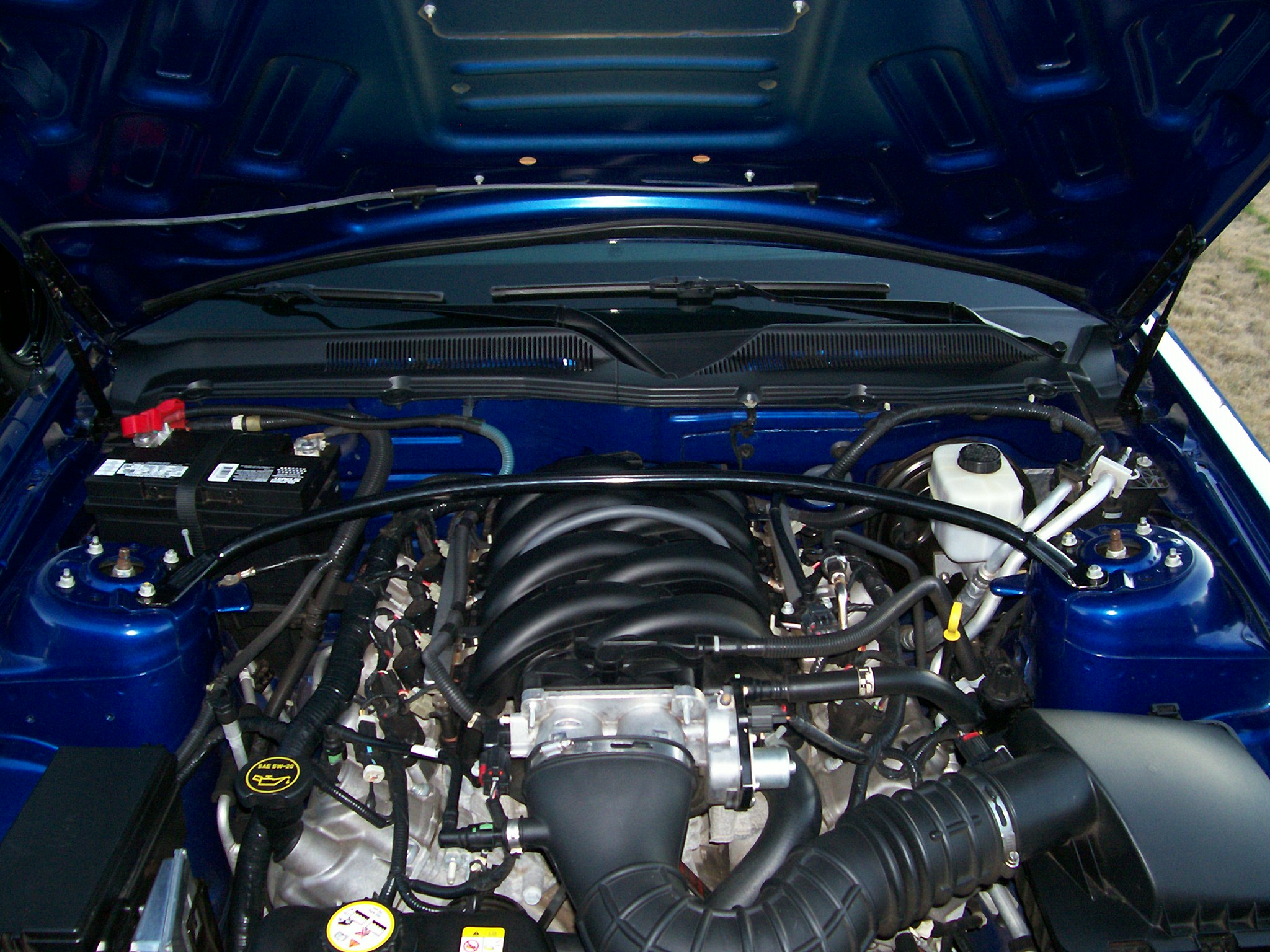

I coulda swore I just made this post, but here I go again.
Looks like a gt500 bar, notice this pic from VMP Tuning's website
