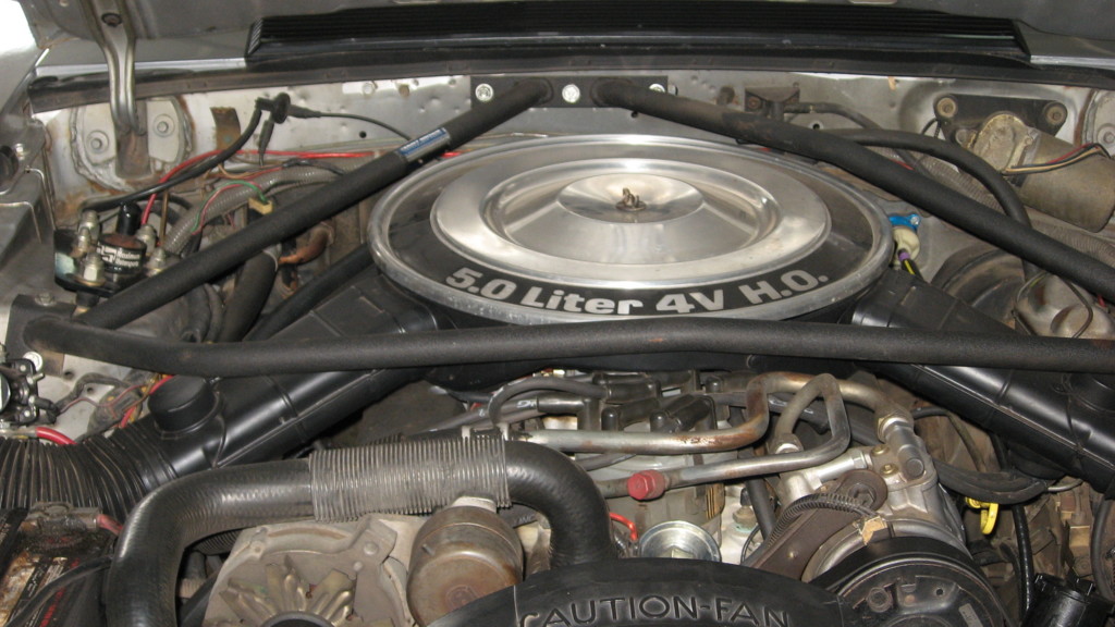

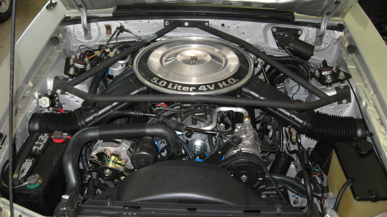

Gonna call it finished!
Okay, a few of you folks saw this thing on the road. I have been shaking out a couple of bugs. I got the rest of my A/C parts in and charged it up, then my first problem was that I shredded two belts. After some research and measuring, I found that my new alternator set back a bit. I took the bracket off, shimmed it, then installed it. Then I found that my power steering pump was WAY loud. So I took it off and swapped it out. I also found my exhaust was a bit high in that it was bumping the frame. So I dropped it. I have yet to shake out a charging issue that I do not like.
Here are the last two pics. I put up the before where I started, and the after. This was a nice project. I hope it lasts a while.
Attachment 32600
Attachment 32601
