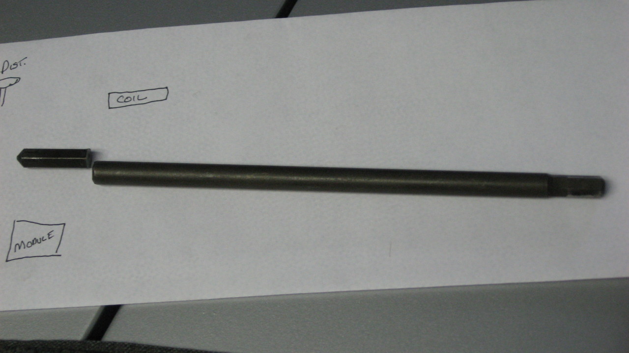

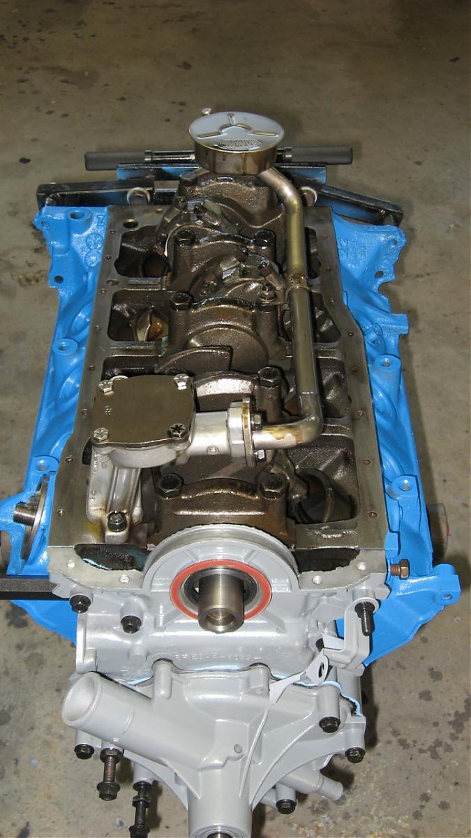

If you do not know why all of this happened in the first place, here's the little culprit. It seems this oil pump driveshaft and the pushrod can't handle 8K RPM. Wimps!
Attachment 31438

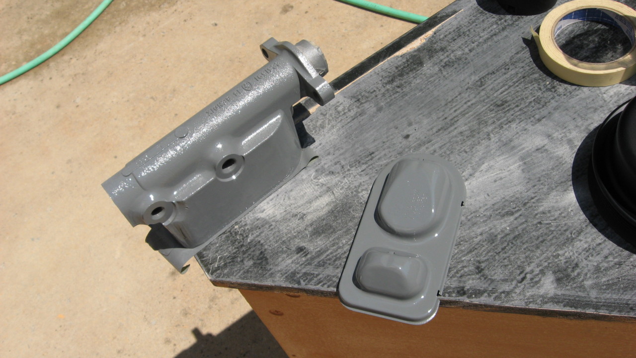

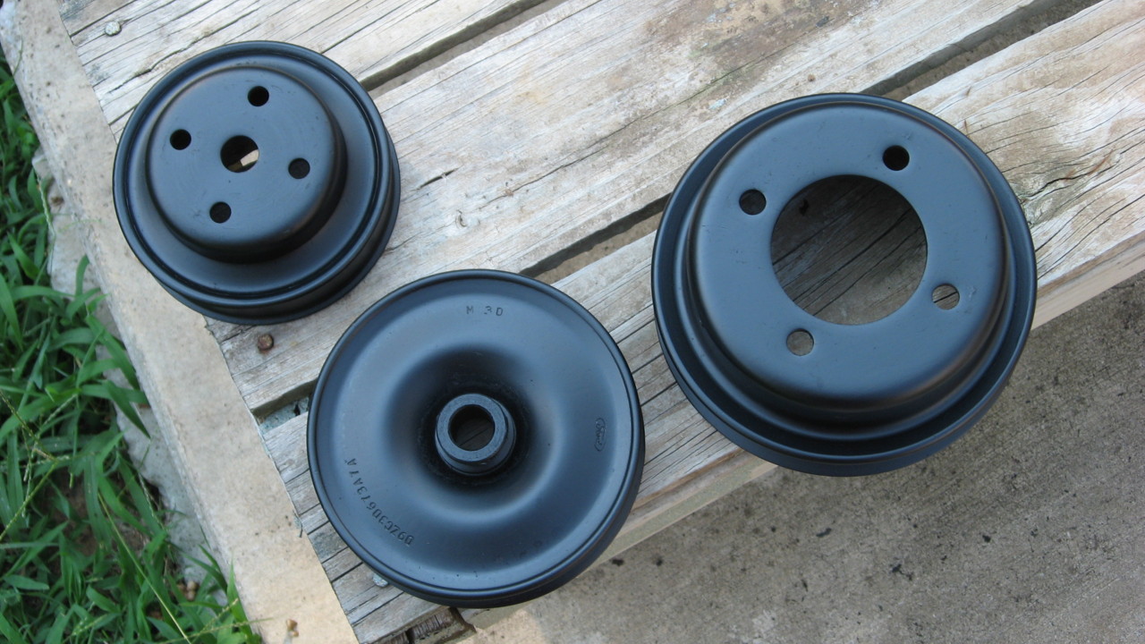

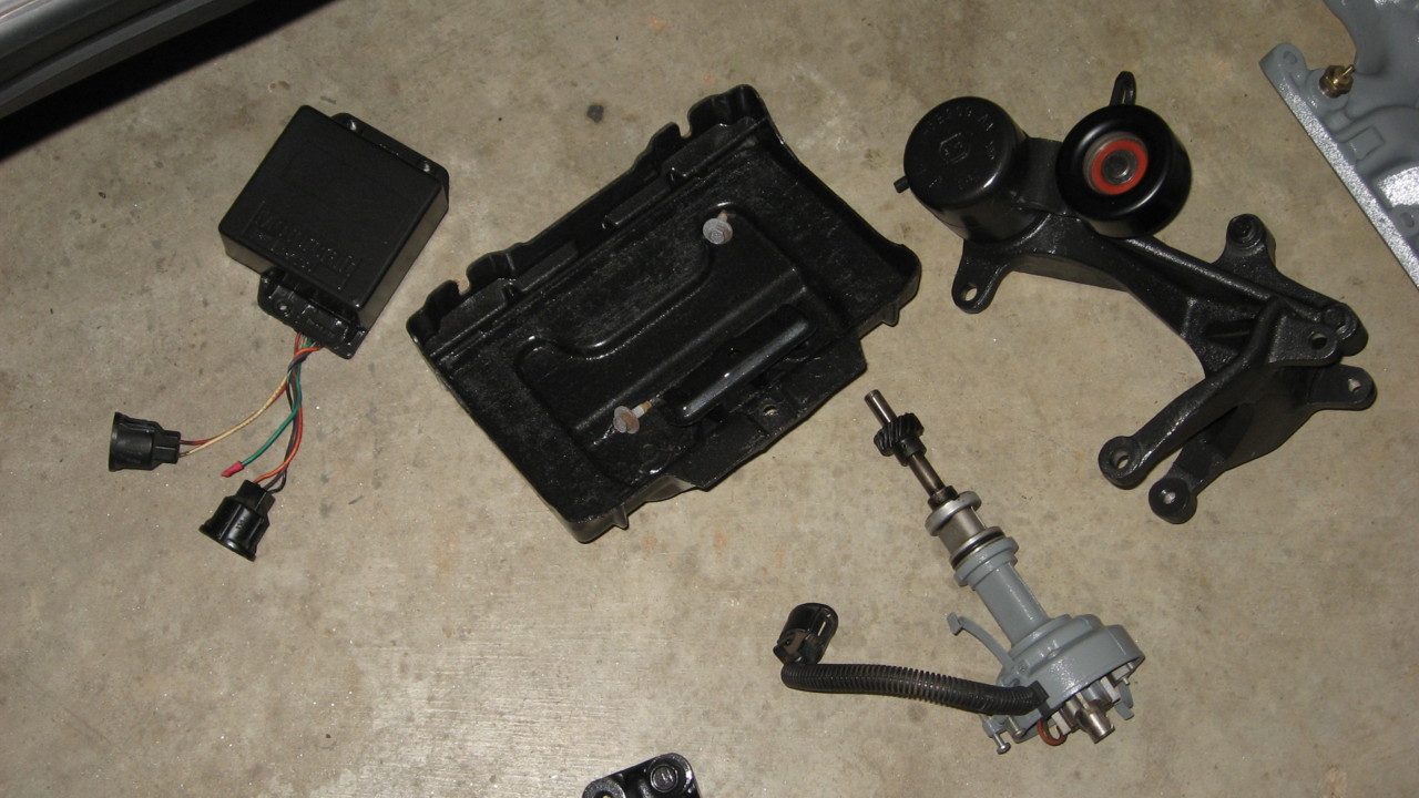

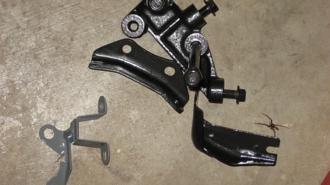

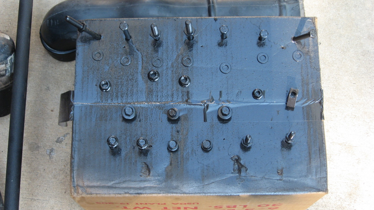

Now, below are some parts that I got cleaned, painted, and they have driced for a few days. So I took a little time painting some more thangs, cleaning some more things, and even mounting a few things.
Attachment 31432
Attachment 31433
Attachment 31434
Attachment 31435
Attachment 31436
Attachment 31437

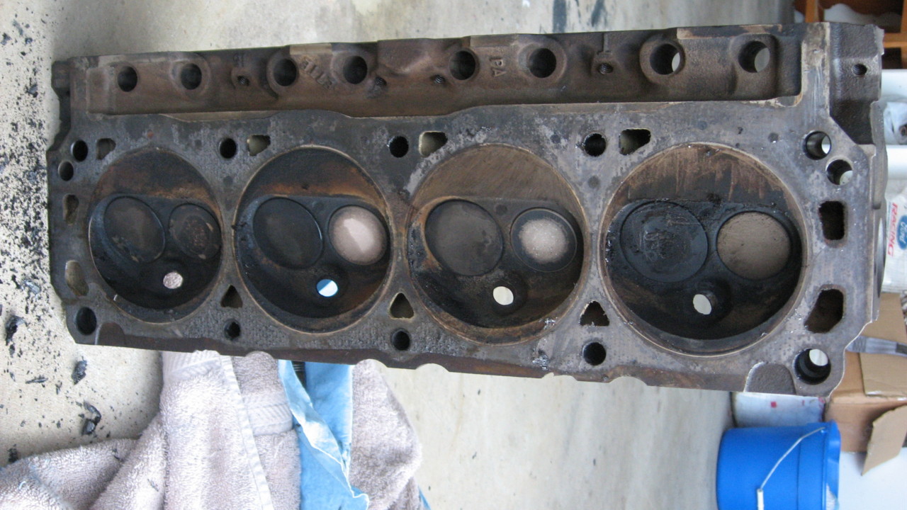

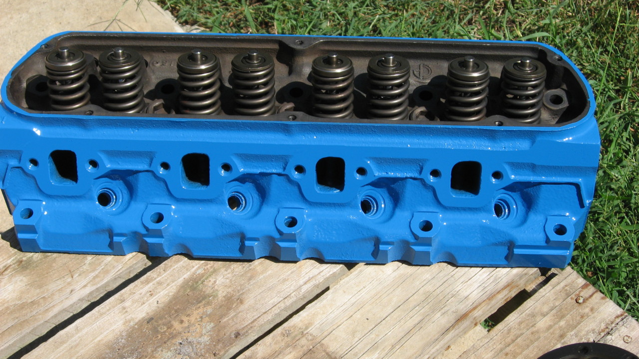

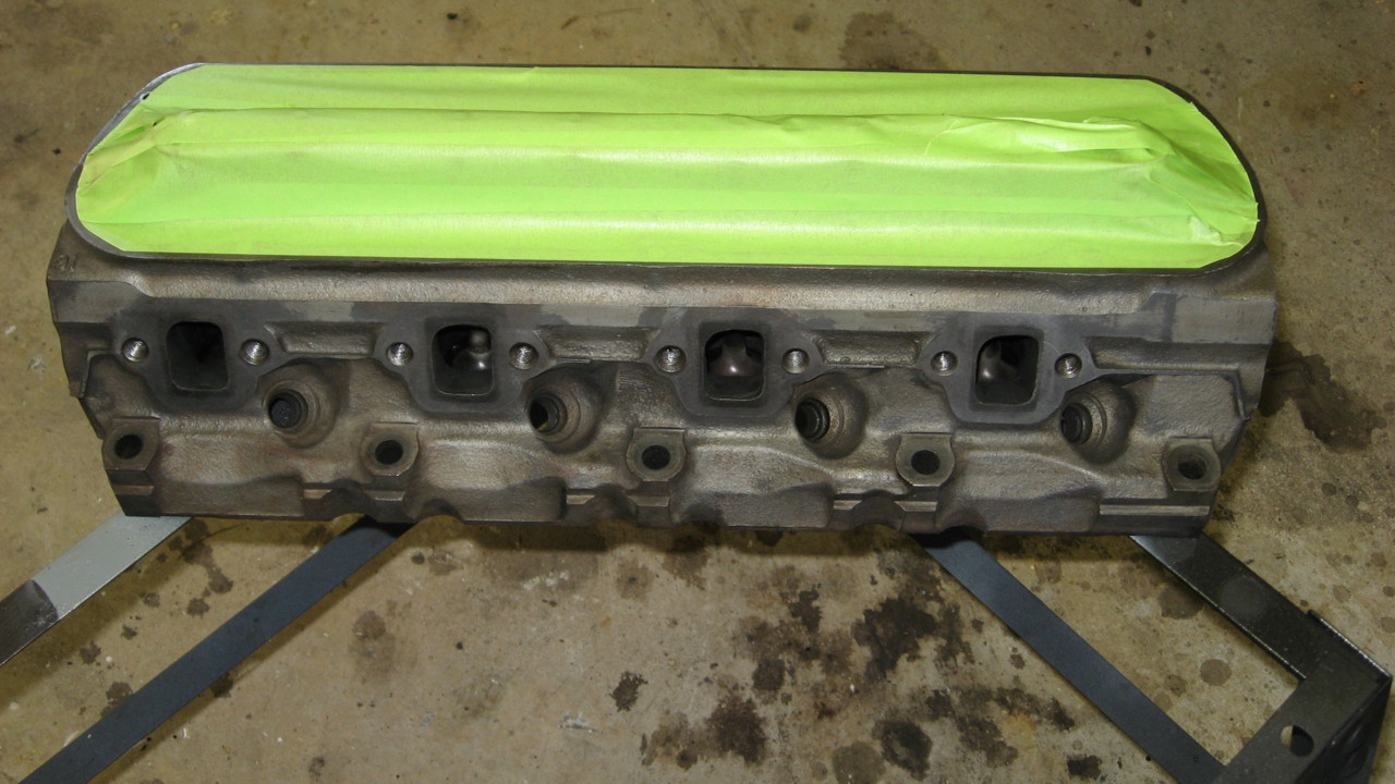

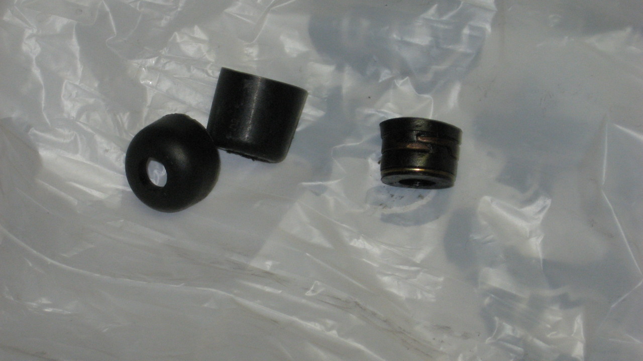

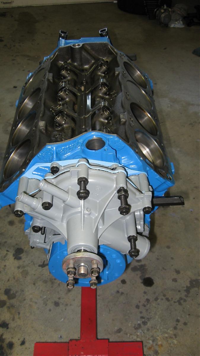

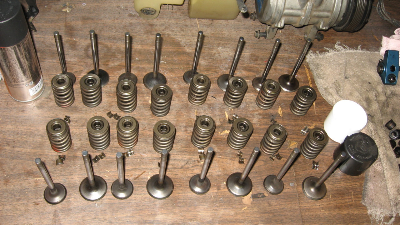

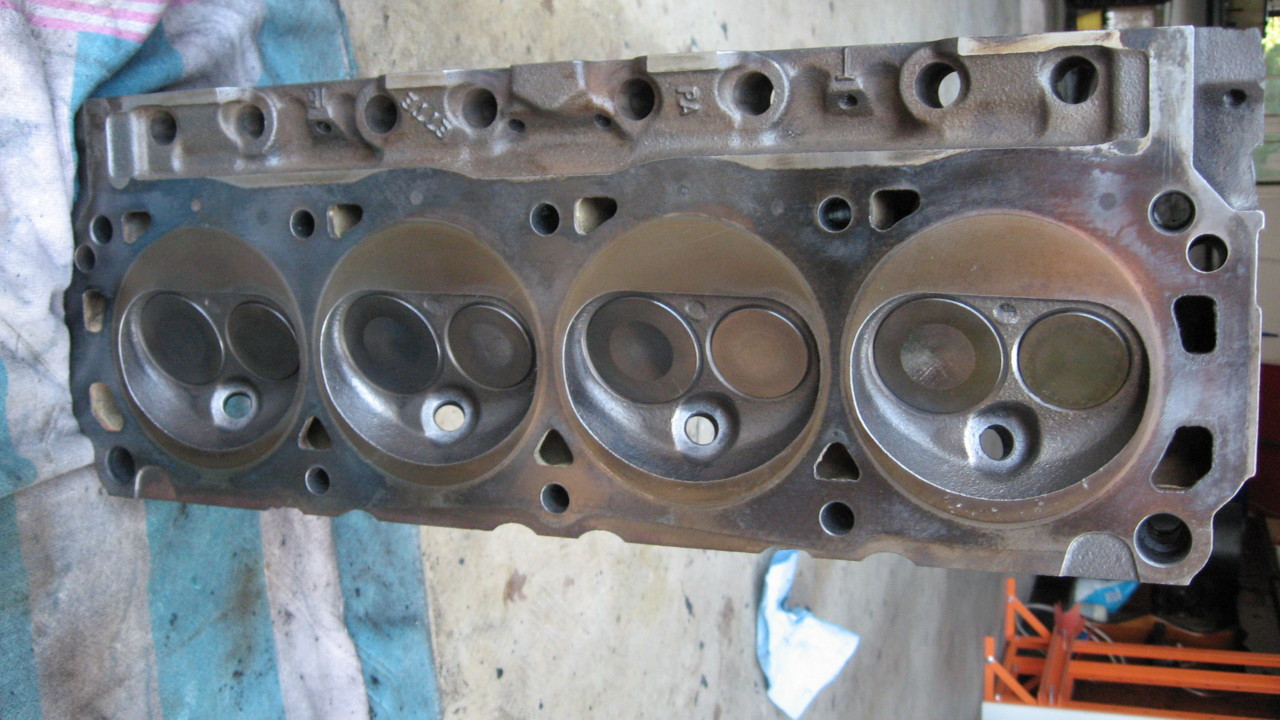

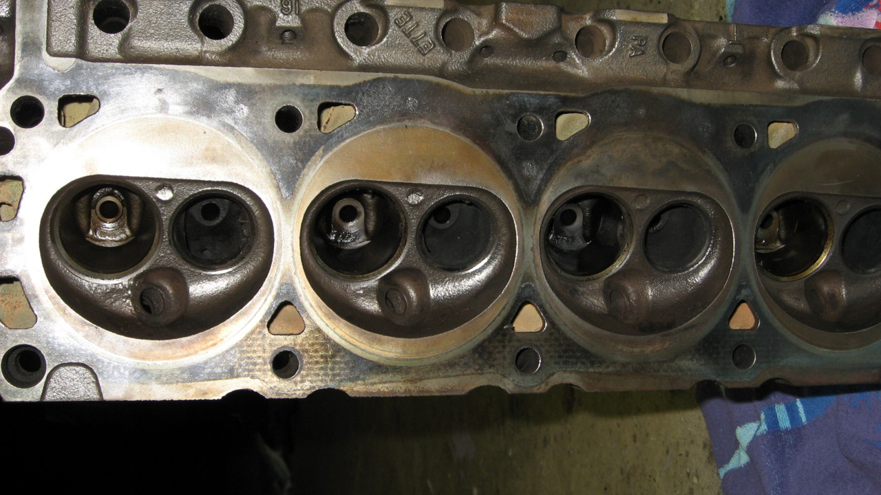

So, I decided to clean up the heads. Then I decide to tear down the heads. Then I found that I do not like the seals that came in my engine gasket kit.
Anyone know if these will work? They don't even hold onto the tower.
Attachment 31439
Attachment 31440
Attachment 31441
Attachment 31442
Attachment 31443

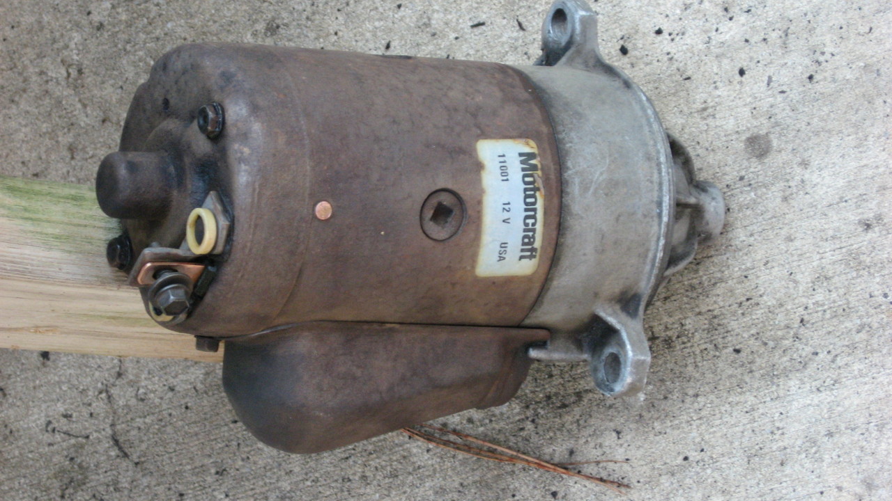

And remember how greasy the starter was? Man, I think it is 5 pounds lighter.
Attachment 31444

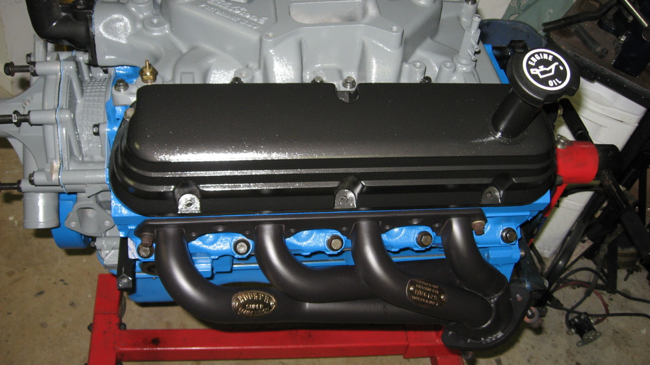

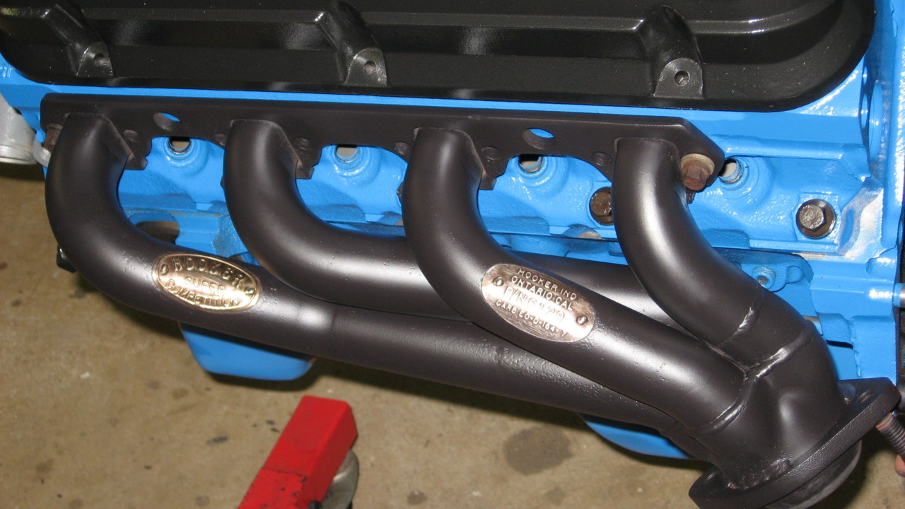

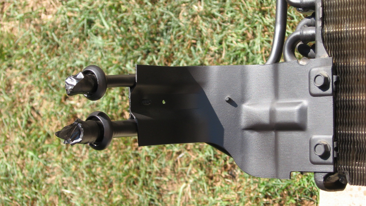

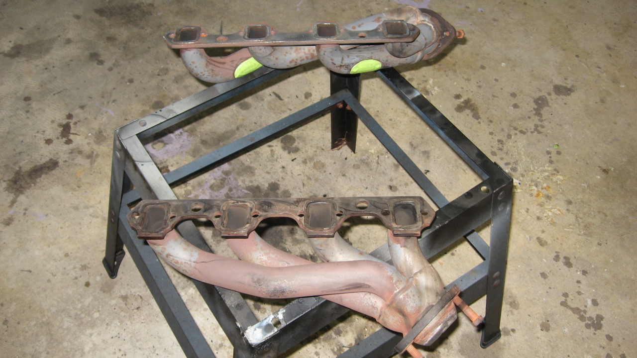

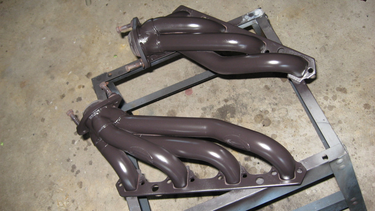

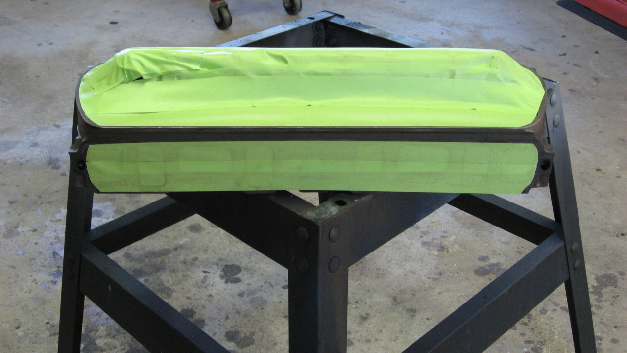

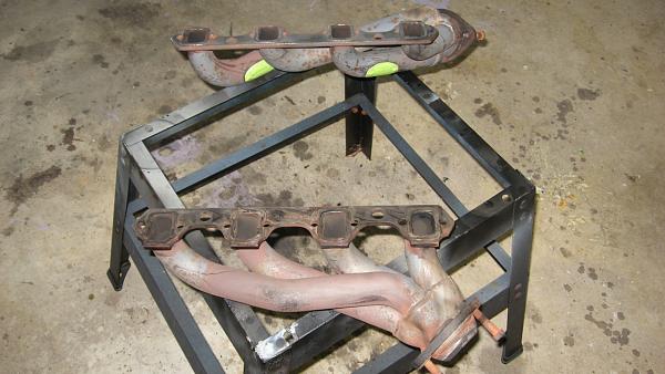

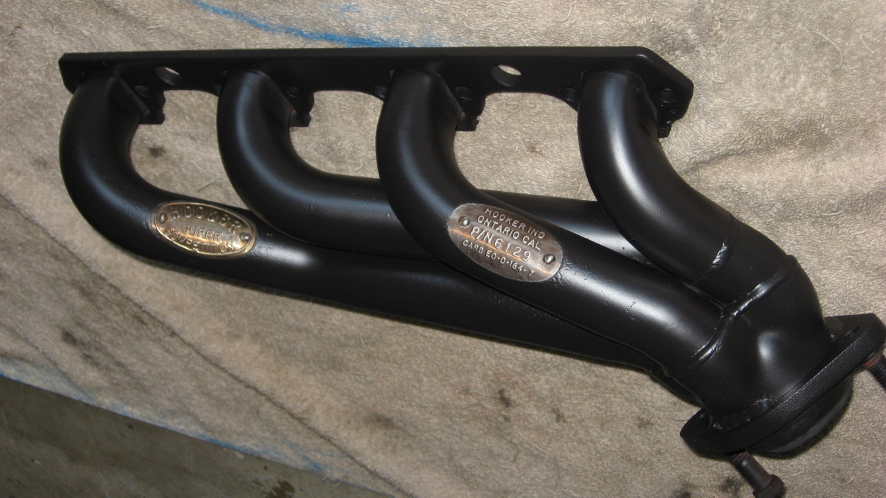

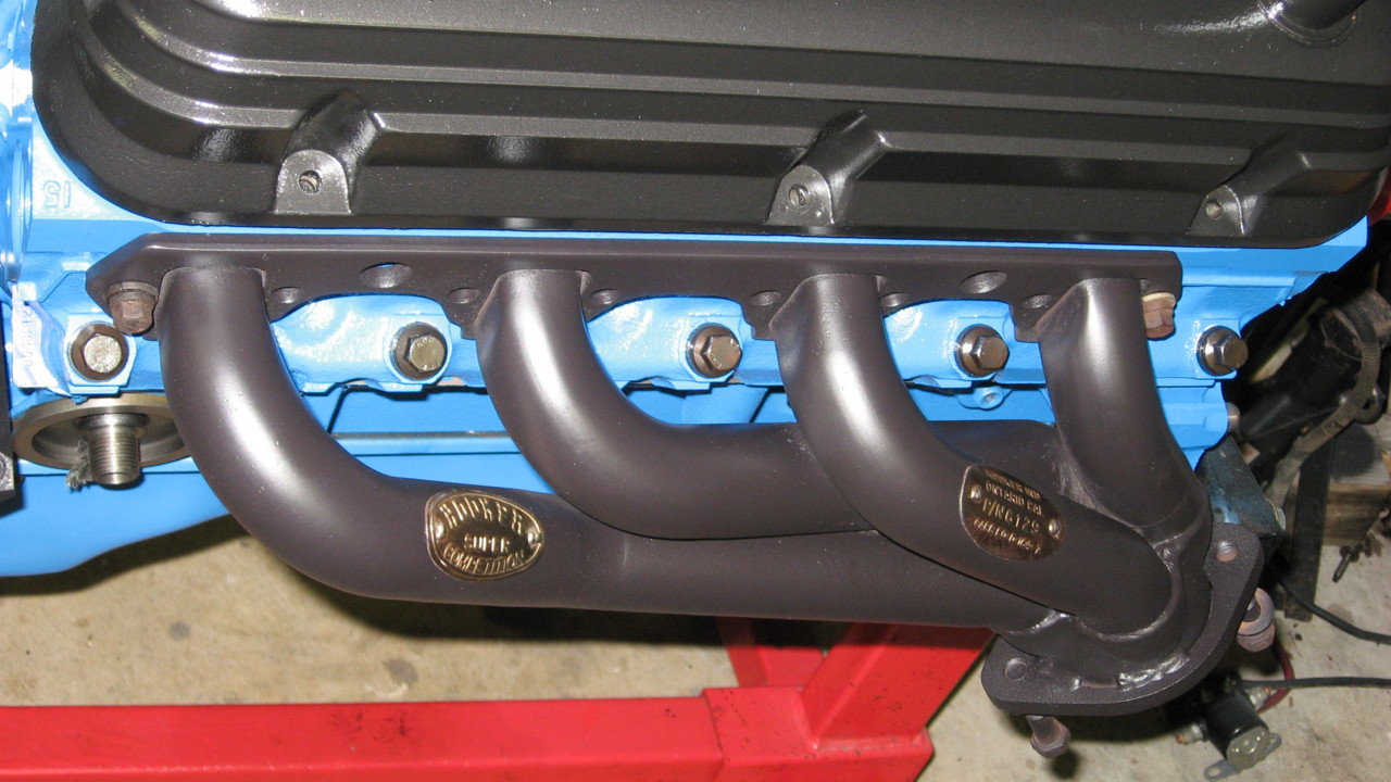

Okay, I saved this set for last. I must admit, I am stoked on how these headers came out. I got some of the 1200-degree paint. I have never painted headers before, so we will see how it holds up. It's a sweet improvement now. I gotta get a pic of the engine mocked up with these puppies hanging on it.
This is cleaned and ready to paint.
Attachment 31445
For some reason, the lighting here makes the paint look grey.
Attachment 31446
Now, here I pulled the tape off of the medallions. This just looked too sweet.
Attachment 31447
Attached Thumbnails Let's get greasy!-engine-060.jpg   Let's get greasy!-engine-068.jpg   Let's get greasy!-engine-070.jpg

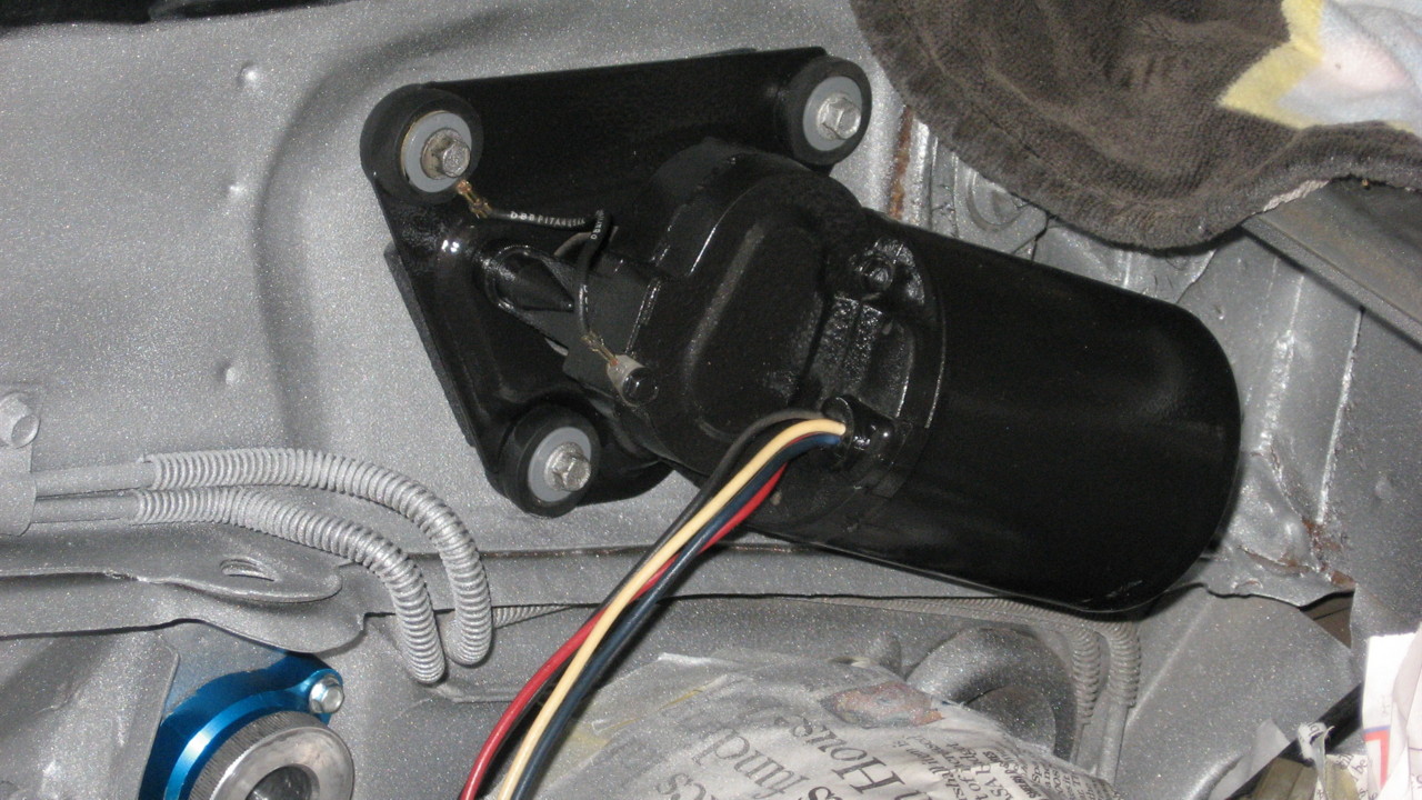

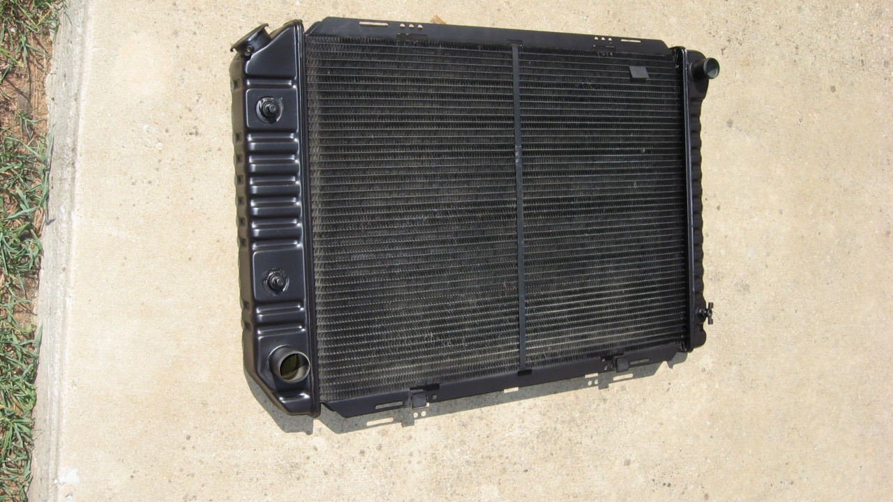

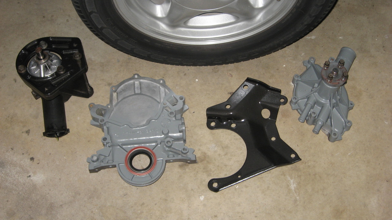

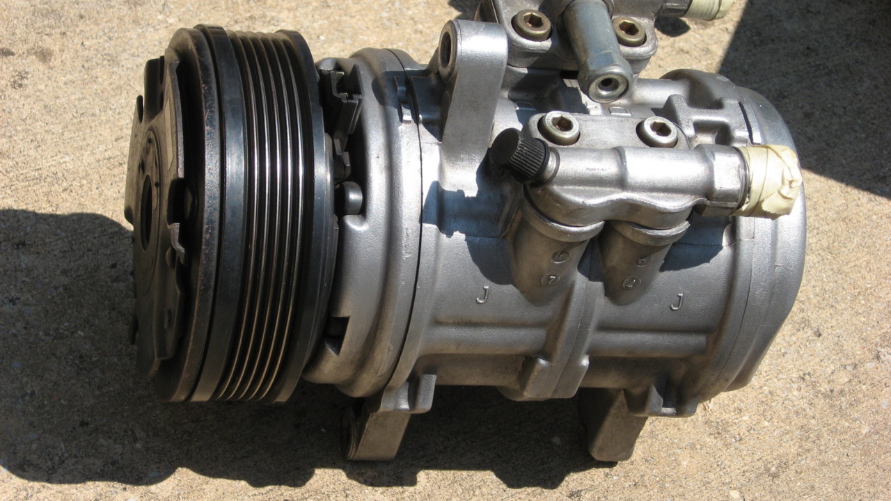

So, I went first thing and got my new valve seals - the right ones this time. I cleaned up the A/C compressor (I am not going to paint this piece), SVO master cylinder, A/C condenser, and Modine 3-core radiator. You can see here how those parts are looking now.
Attachment 31489
Attachment 31490
Attachment 31491
Attachment 31492

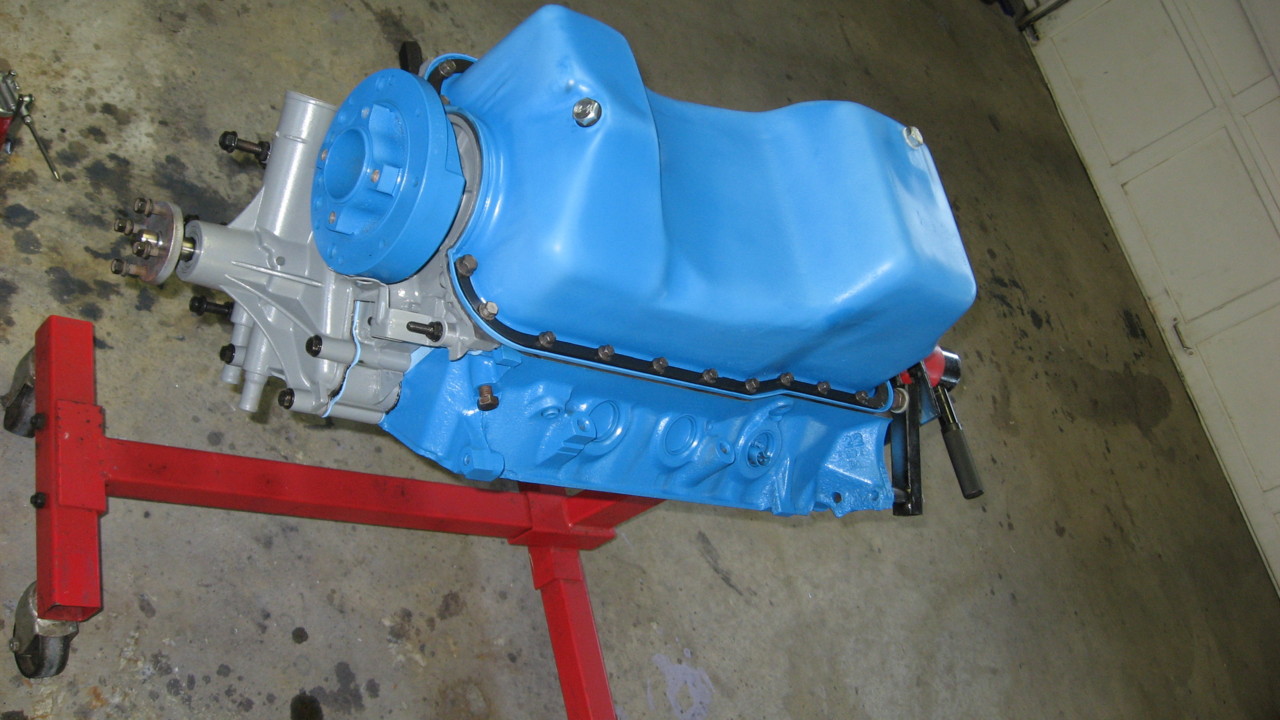

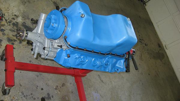

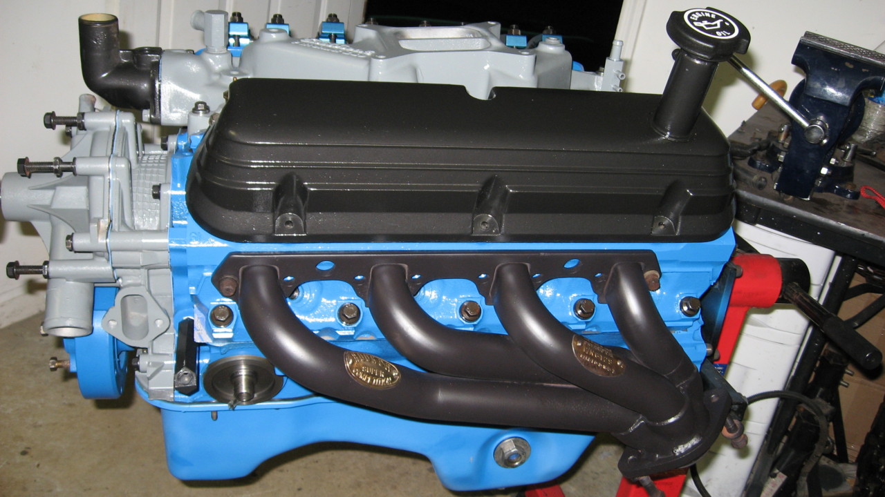

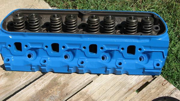

They only had one set of valve seals. I picked them up and put one head back together. I cleaned it up, taped it off and shot it with the New Ford Blue paint.
Attachment 31493
Attachment 31494
Attachment 31495
I also picked up the one-piece oil pan gasket. If you are ever to the point that you are doing this, I highly recommend one of these. You are almost gauranteed no leaks.
Attachment 31496
Attachment 31497
Attachment 31498

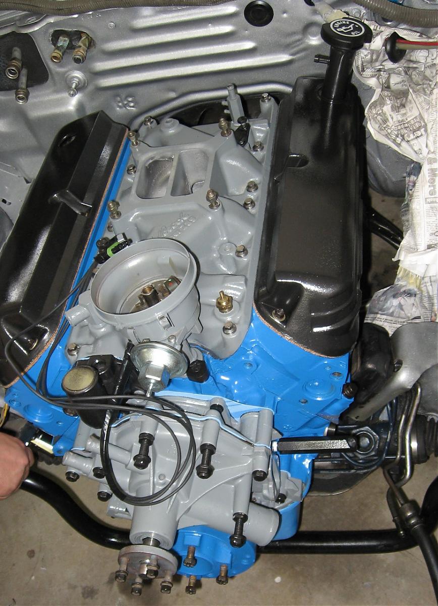

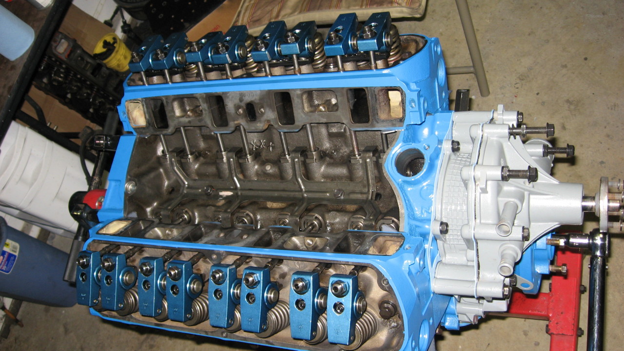

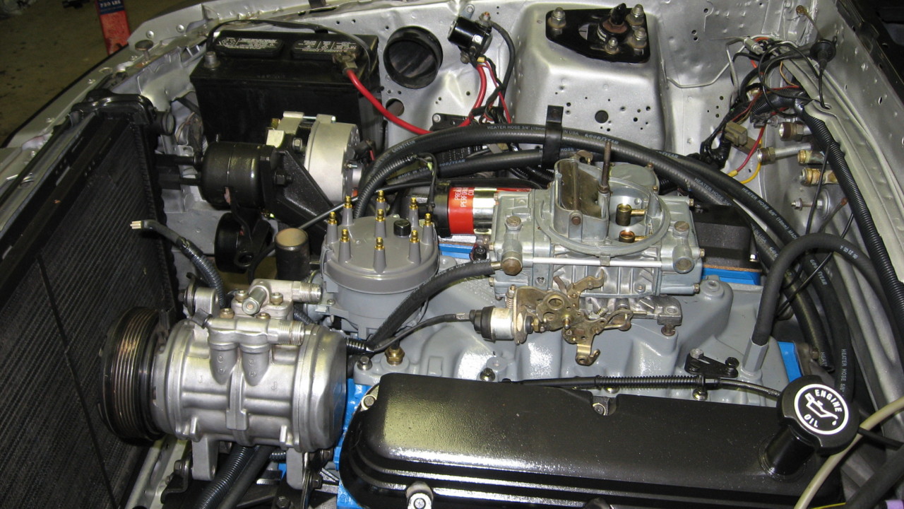

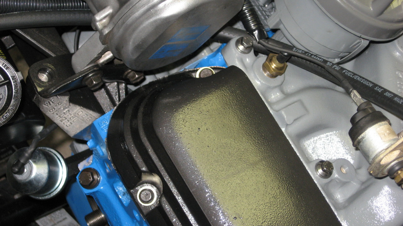

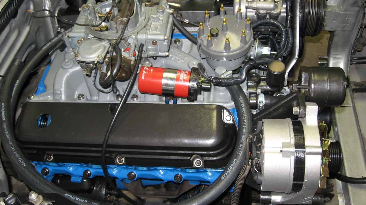

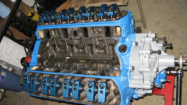

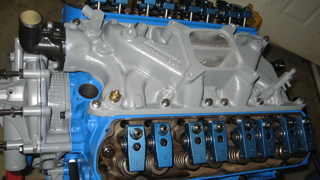

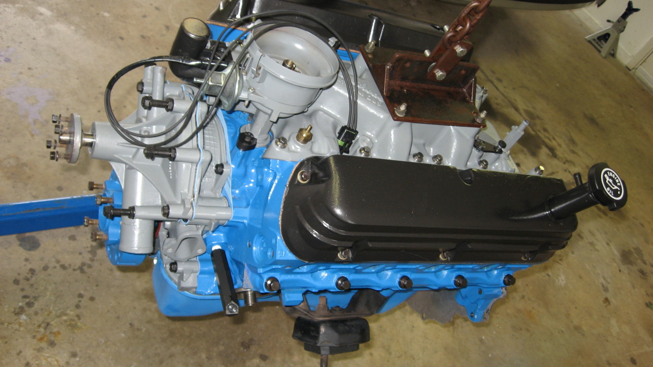

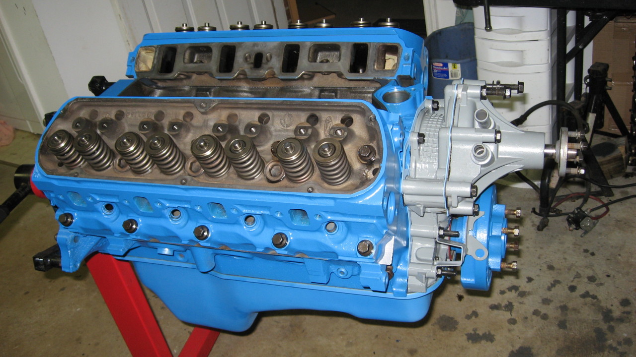

Hey, it rained and cooled off tonight! I had the garage doors open and finally felt some cool air. So, the first thing I did is finish getting the heads on.
Attachment 31784
Once they were torqued down, it was time to throw in the pushrods and 1.6 roller rockers that I had on before. Took a little time, but I think I have them right.
Attachment 31785
Laid a couple of beads of silicone down at the ends of the block and placed the intake. Took my time and torqued it down. Took about 10 passes to do it, of course.
Attachment 31786
And, like I mentioned before, I just had to mock up some of the stuff. Gosh, all these clean and painted parts ought to add at least 5HP! Anyway, these pictures made me smile and gives me more incentive to get going this weekend. I am really liking the color.
Attachment 31787
Attachment 31788
Attachment 31789
Attachment 31790

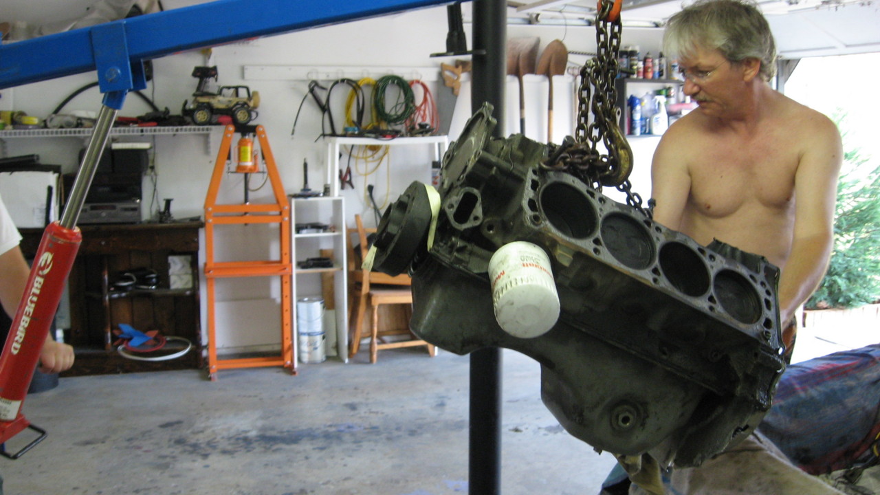

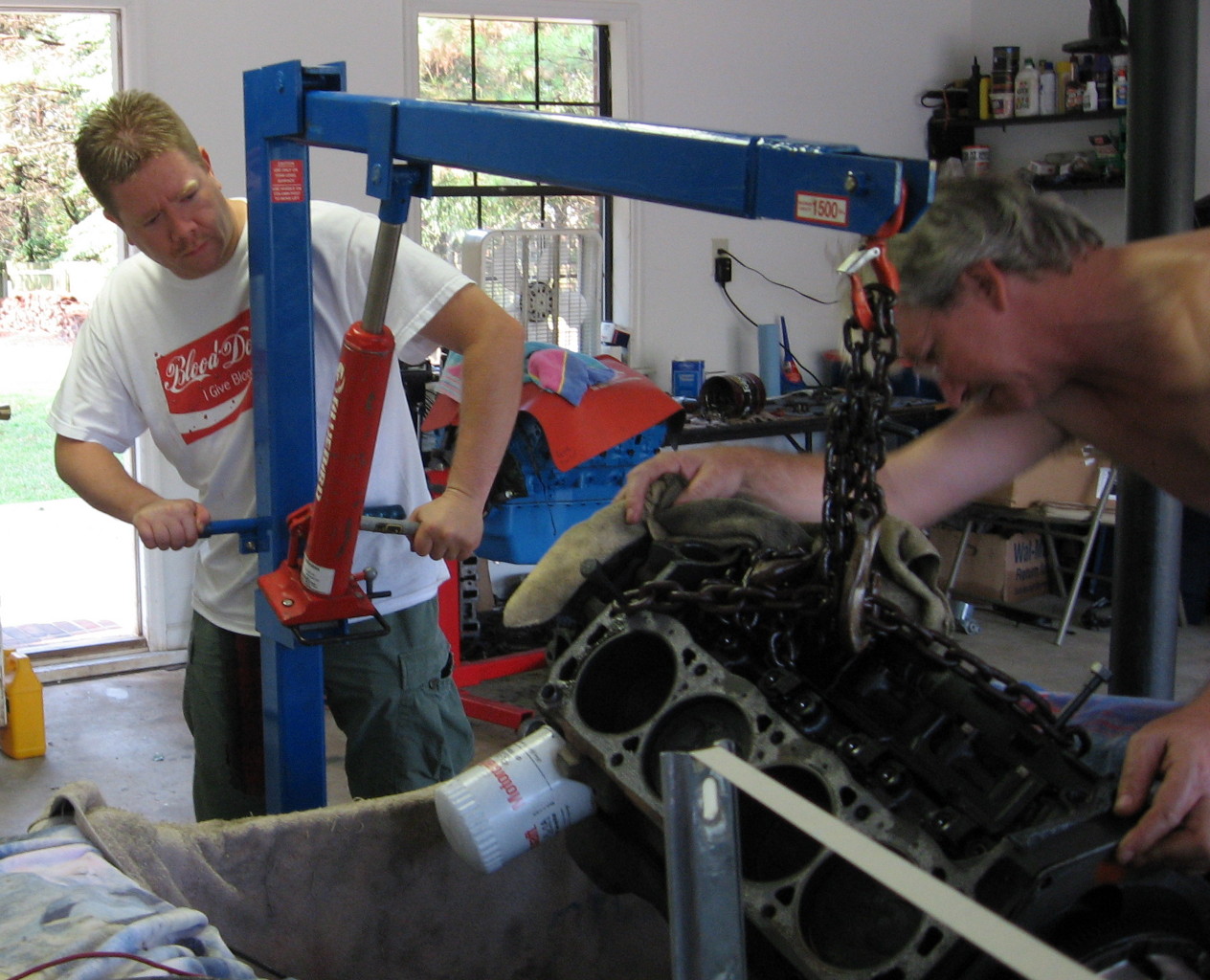

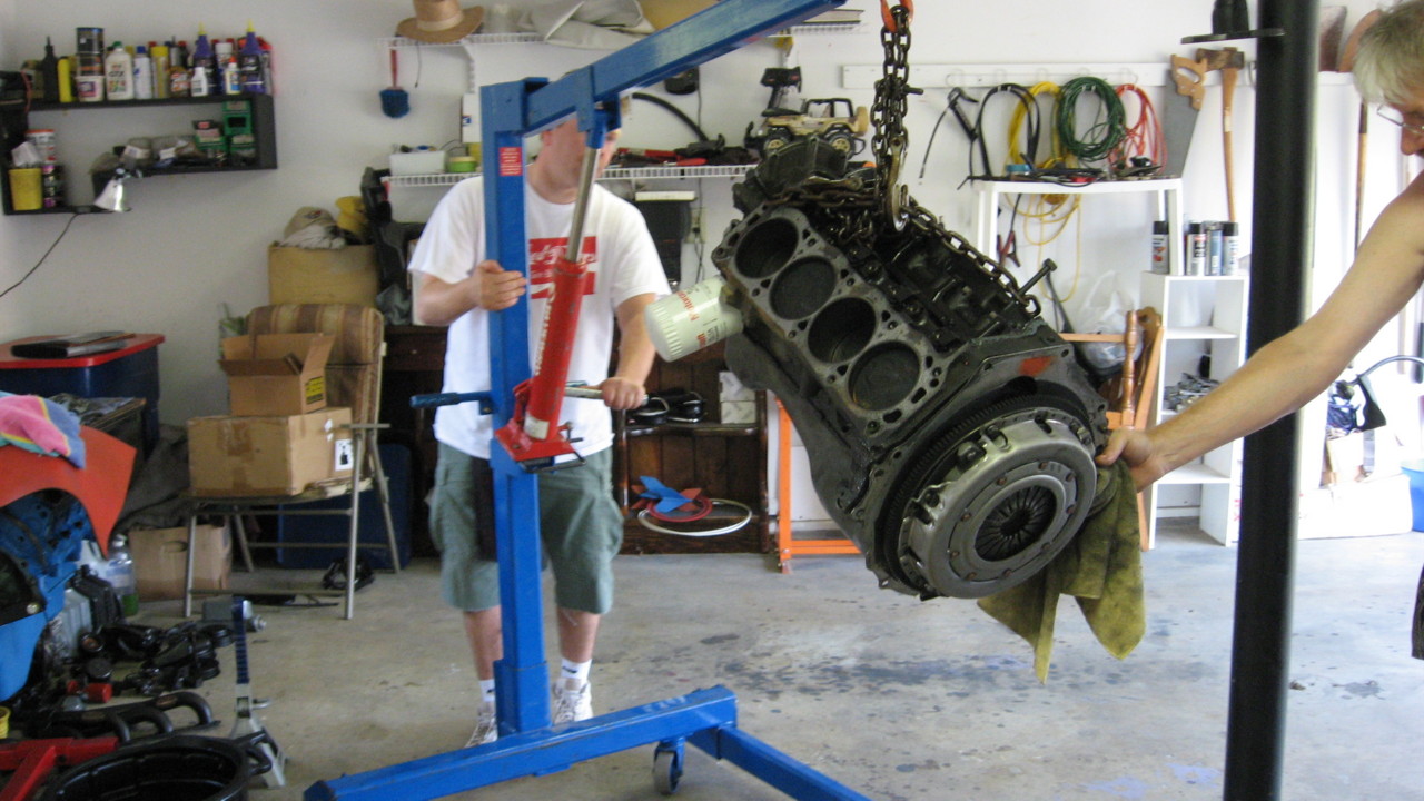

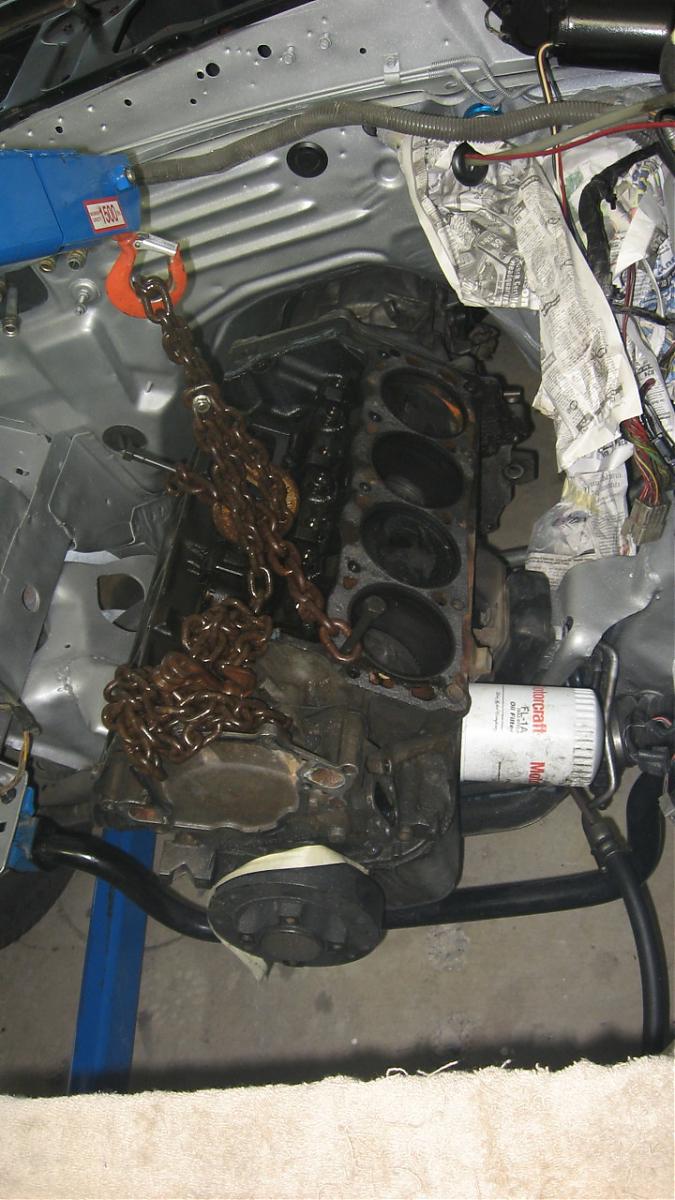

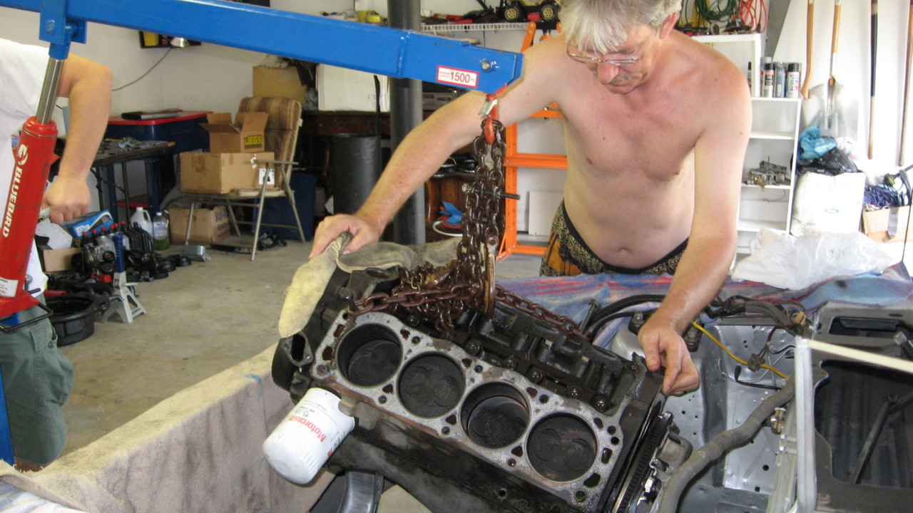

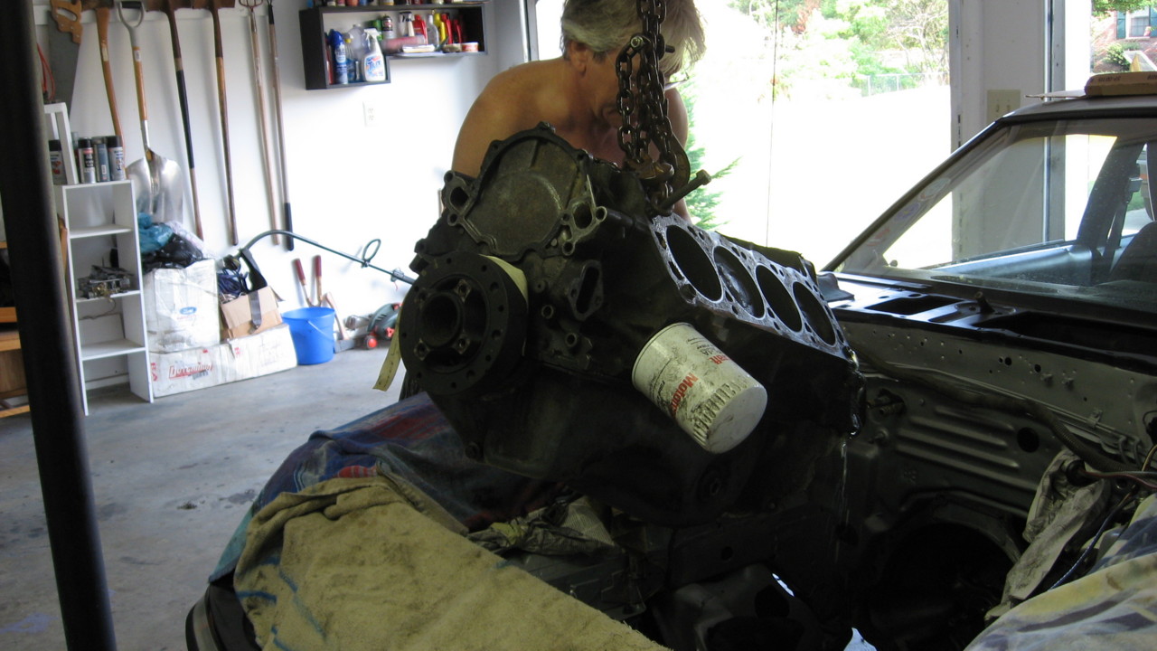

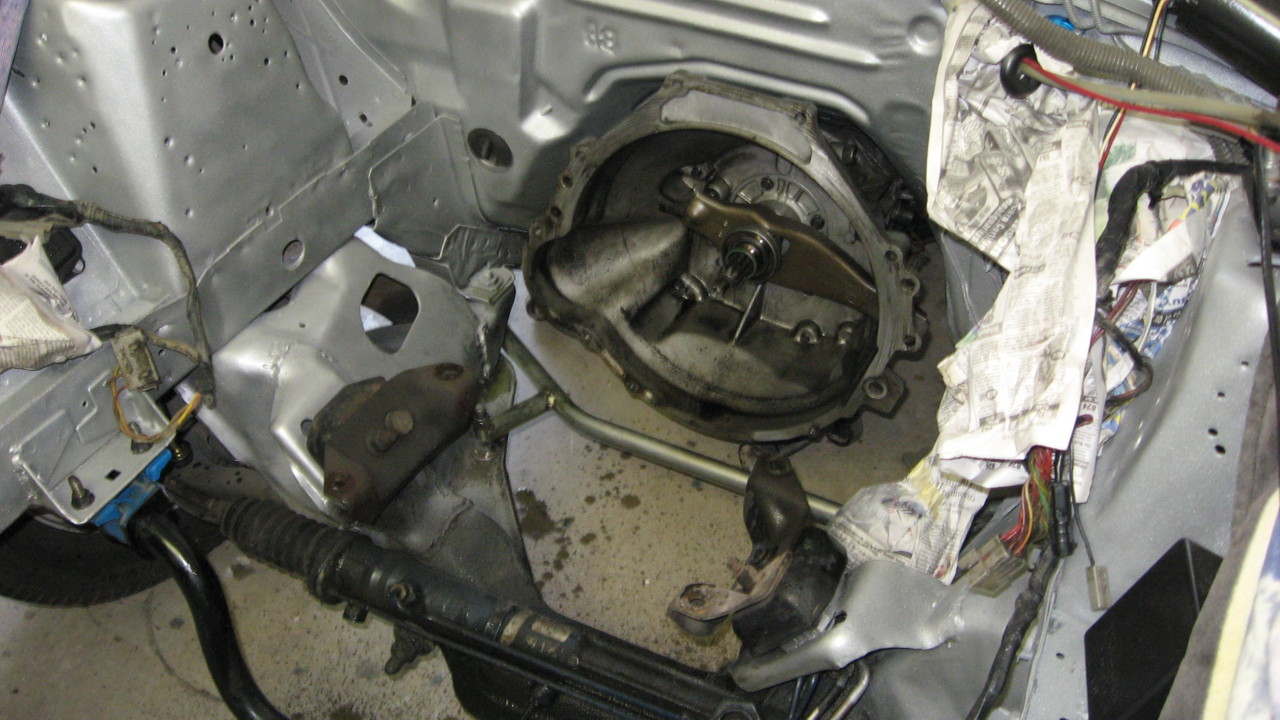

Many thanks to Anthony that you see in the pics below. I could not have done this so easily without his help. We had the "new" motor in and bolted before noon.
These last set of pics show some ugly guy and Anthony getting the old engine out. There is also some cleaning that had to go on before the "new" engine went in.
Attachment 32198
Attachment 32200
Attachment 32201
Attachment 32202
Attachment 32203
Attachment 32204
Attachment 32205
Attachment 32206
Attached Thumbnails Let's get greasy!-engine-092.jpg   Let's get greasy!-engine-093.jpg   Let's get greasy!-engine-094.jpg   Let's get greasy!-engine-095.jpg   Let's get greasy!-engine-096.jpg
Let's get greasy!-engine-097.jpg   Let's get greasy!-engine-098.jpg   Let's get greasy!-engine-099.jpg   Let's get greasy!-engine-100.jpg

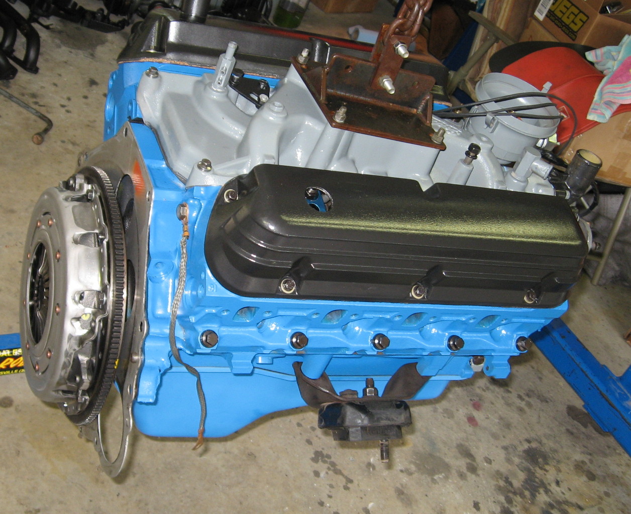

Now, let's get clean!

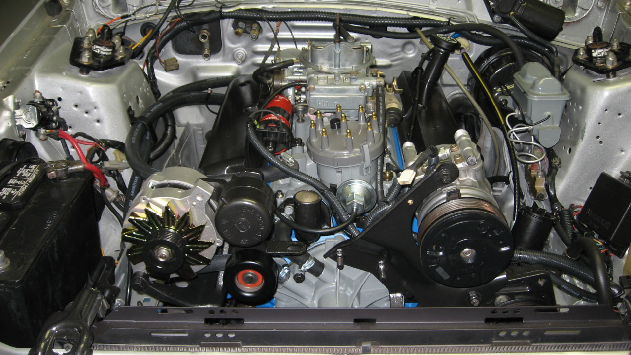

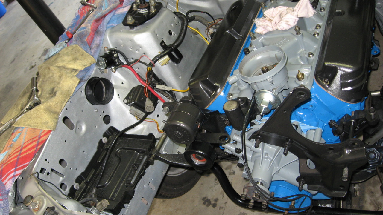

Aw, heck. Now let's start the fun part. The going-together part. I love it when I finally get here. Things start taking on a new meaning when clean and new parts are being bolted together.

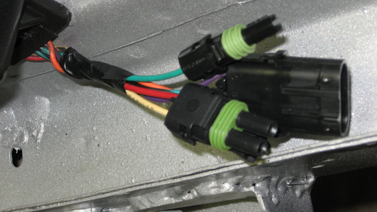

I thought that I would first show where the speedo cable is gonna get clean, the Painless weatherpack connectors that I am using, and the piece that I still need to do my A/C.
Attachment 32210
Attachment 32211
Attachment 32212

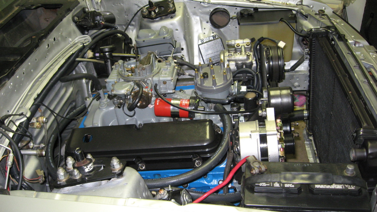

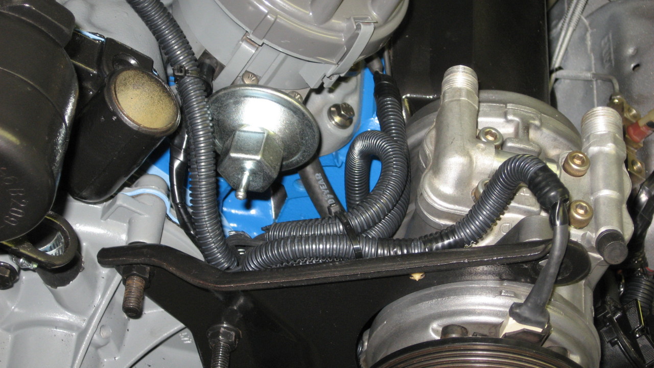

And here we got the clutch all setup, the front of the engine, the first shot after bolting it all in, and some of the work I put into it the rest of this afternoon.
Attachment 32213
Attachment 32214
Attachment 32215
Attachment 32216
So, that is it for today. Time to do some bowling for the Junior Achievement. Tomorrow, I am going to try and finish the wiring. That would be my last major job out of the way.

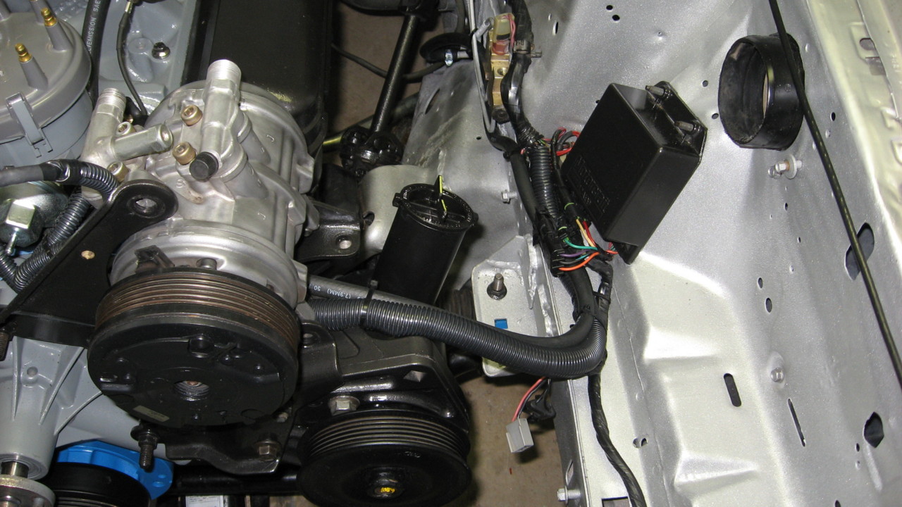

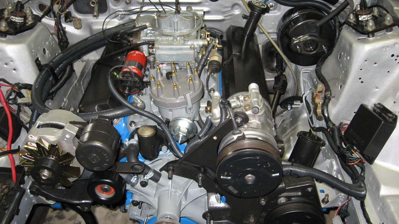

My goal this weekend was to get the old engine out, the new engine in, and get the wiring done. I am happy to say I met and exceeded my goal. It was not as hot as it has been, so the garage work was not too bad.
I started on the wiring. Laid out some of the engine parts to get the wiring cut right the first time. I am amazed at the time it took to do all of this. Most of the original wiring is intact. I only wished to replace the stuff that was in terrible shape. Once I got this done, I actually hooked up the battery to make sure that everything had voltage. Even heard the fuel pump kick on. Yes!
Attachment 32260
Attachment 32261
Attachment 32262
Attachment 32263
Attachment 32264
So, once I had the wiring in place where I felt good about it, I started to put a bunch of small stuff together. Now, some of these things are not mounted quite yet like the A/C compressor and the carb. But most everything else is. The clutch, speedo, and accelerator cables are all connected. I need to bleed the brakes, mount the headers and exhaust, top radiator hose, fluids, plugs, wires...
The rest of my A/C stuff gets in Thursday. So, my goal is to have it on the road next weekend. Not bad.
Attachment 32265
Attachment 32266
Attachment 32267
