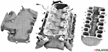

The aviator intake is similar to the FR500 intake for the DOHC motors and is often referred to as a "poor mans FR500".
It is a variable geometry intake, meaning that it has butterflies at the radius of the runners changing it from a long runner to a short runner at a specified RPM. This will allow you to get the low end grunt and minimize running out of wind on the top end.

[/IMG]
This is a pic of the lincoln Aviator Intake and below is a pic of the FR500 one.
Yeah Byron, I know I'll have to go with C style heads.....I'll try and save up for the 03/04's and the extra stuff that goes with it.

Originally Posted by 96TennGT
Nice driveshaft you have there too.
Not mine, It's a pic of an intake I found on the net. I've got to get mine shipped to me.
