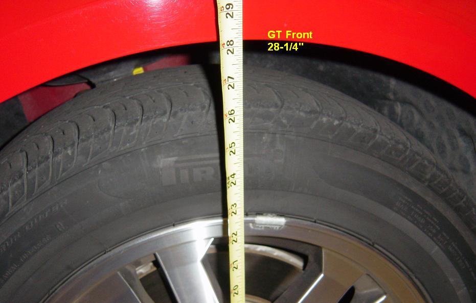

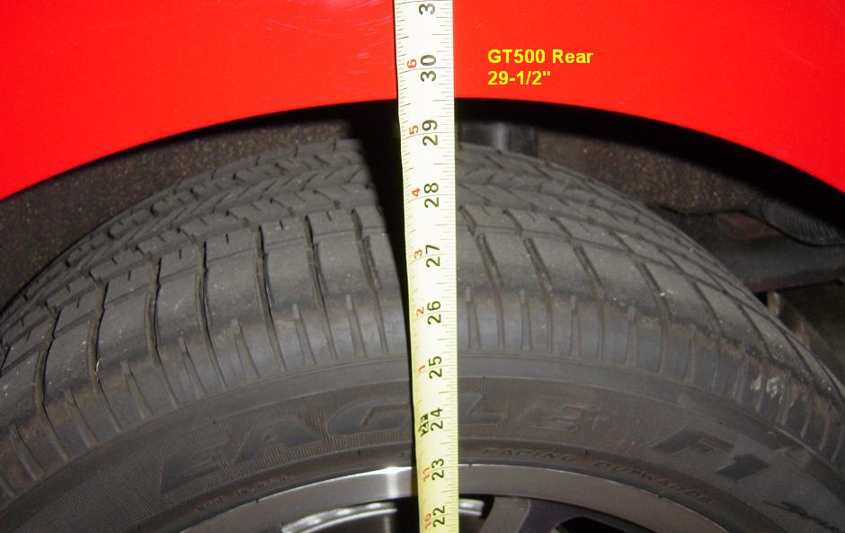

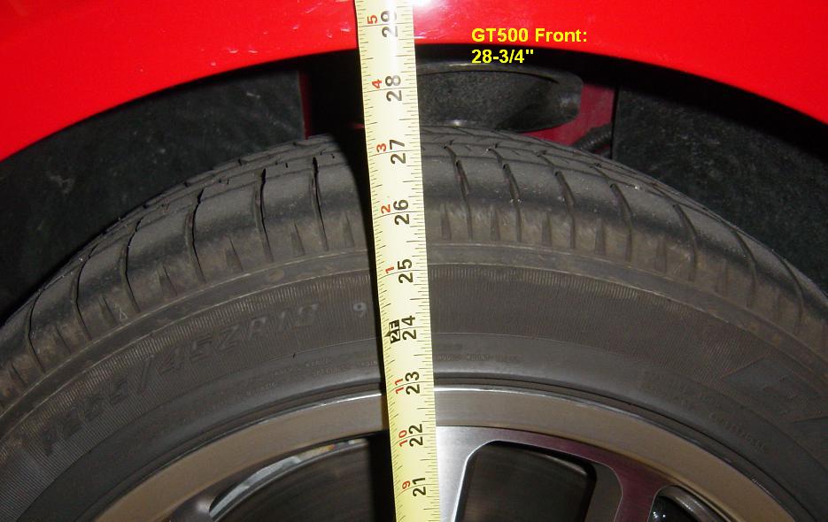

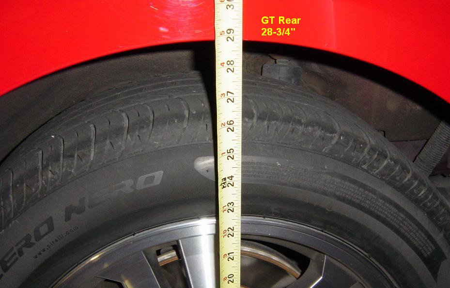

GT500 ride height isn't higher. Front ride height for the GT500 is 10mm lower than the GT while rear ride height is the same.
This isn't the case between my GT and GT500. Although my measurements are not exact, they must be representative. Based on the crude measurements from the pics I took of both cars, the results are:
Front:
GT: 28-1/4"
GT500: 28-3/4"
GT500 is ~1/2" taller.
Rear:
GT: 28-3/4"
GT500: 29-1/2"
GT500 is ~3/4" taller.
This difference is noticeable when I'm in the GT driver's seat, looking abreast (to the right out the passenger door) towards the GT500. As I lower my line of sight to match the top of the doors on the GT500, I can see the top of the passenger door on the GT is approximately 1/2 to one inch lower.
Attached Thumbnails Suspension differences GT500 vs GT-gt-front.jpg   Suspension differences GT500 vs GT-gt-rear.jpg   Suspension differences GT500 vs GT-gt500-front.jpg   Suspension differences GT500 vs GT-gt500-rear.jpg

I've seen a number of different GT's & GT500's sitting next to one another, and I know that they're supposed to have different springs. Last time I checked, springs have everything to do with ride height (lowering springs), I've even compared the 2 springs side to side, the GT500's ride height is higher.
Old Jan 4, 2008 | 11:05 AM
TheRealOne's Avatar
Joined: October 12, 2004
Posts: 519
Your GT is also 2-3 yrs old. It probably has settled some. Also it appears as though you have 17 inch rims on your GT and your GT500 comes with 18's.
Old Jan 4, 2008 | 02:23 PM
Willie's Avatar
Joined: October 14, 2006
Posts: 716
From: Tucson, Arizona
Can't argue with you here but one inch drop sounds a bit excessive for 2-3 years.
Very true but the tire height on both (three if you count the different tire sizes on the GT500) are ~27.1 inches. This makes the distance between the center of the hub to the top of the tire the same on all three. Therefore, the difference in the wheel diameter does not affect the ride height.
