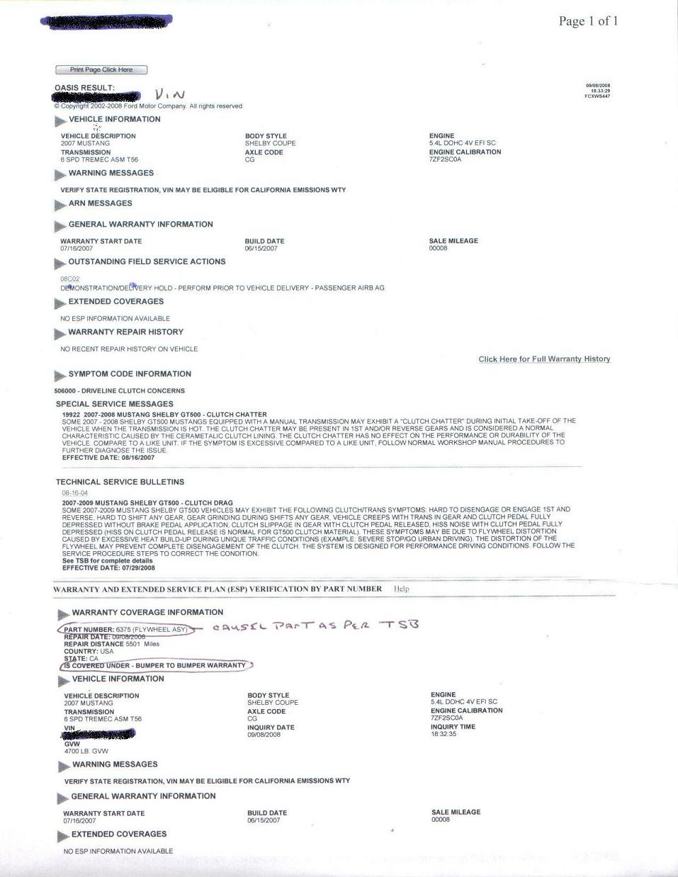

To Find out if your Car is Covered by the TSB you will Need to Contact your Dealer . You will Need Vin Number and Milage. Ask Them to Run an OASIS for a Clutch Concern. The CAUSEL Base Part Number as Per the TSB is 6375. Your Car will Need to have had the Concerns as Listed by the TSB. Ford will Not Simply Replace these parts as Requested. See Enclosed Pic of Info I pulled on Car. As Per Printout My car is Covered under the 3/36 Bumper to Bumper Warranty. This Info is Provided as an FYI Only. Realize that Just because a TSB Exists for a Model not Every Car is Going to Qualify for the TSB. It Must come up on OASIS. Note PDF Below is Ford Warranty Coverage Book.

Old Sep 9, 2008 | 05:10 PM
Dave_C's Avatar
Joined: December 24, 2007
Posts: 17
From: Gadsden, Al
So, it is covered under the 3/36 and not a 12/12. Correct? I guess someone needs to educate the service advisor that told Willie that it was 12/12.
Originally Posted by Willie
The advisor told me a clutch is a wearable part and only covered in the 12/12k warranty period.
Willie
My 08 has 3200 miles so far. No issues with grinding, etc. It does have a very slight shudder/chatter if I baby it when starting from a dead stop. Get a little more aggressive with the starts and there is no issue. I just want to make sure that I've got another 26 months of coverage. (delivered 12-21-07)
POST 11
Update.
As Per My Ford Contact The Flywheel Clutch Concern also Has 5 Yr 60,000 Mile Powertrain Coverage. The Way OASIS is Programmed it only Shows Warranty Coverage per Milage Submitted. If You input 36,001 The Coverage Changes From Bumper to Bumper to Powertrain Coverage. If you Punch in 60,001 and do not Have ESP it will say NO Coverage. Now if you Bought FORD ESP you May Also have Additional Coverage. You would have to have them Type in 60,001 and See what the Oasis Shows. I do not Have ESP on My Car so I have Not Researched Coverage Beyond Powertrain Coverage. Also Be Aware Many FORD Dealers Sell ESP that is Not FORD Brand ESP. You would have to Contact the Dealer and Have Them Check if your Aftermarket ESP Covers TSB Repairs. I make no Guarantee's This Stated Coverage is True For All Cars and All States. This is Simply the Info as Per My Shelby and is an FYI!
