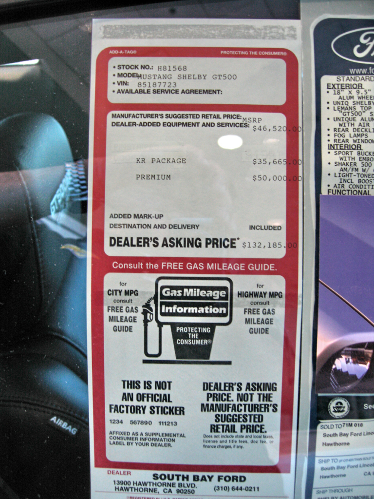

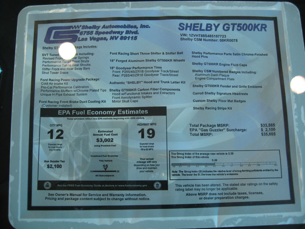

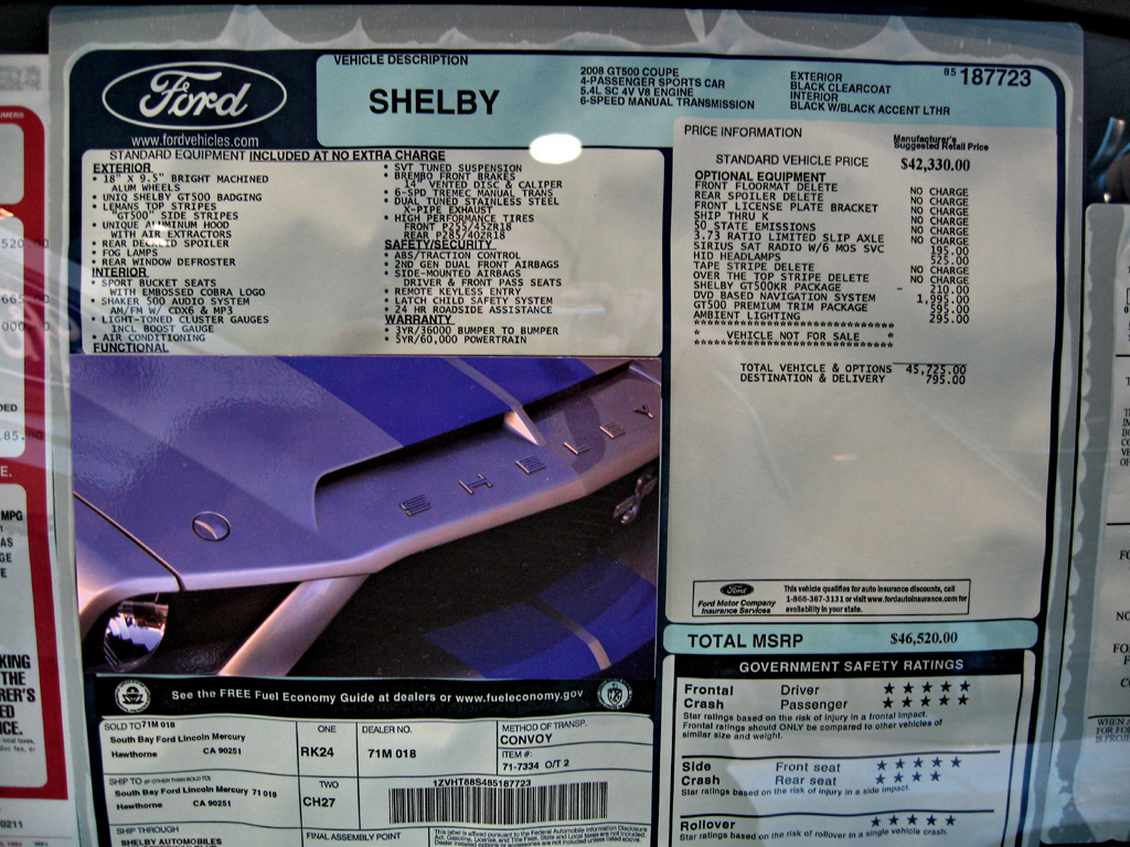

Cool "2008 Shelby GT500KR window stickers"

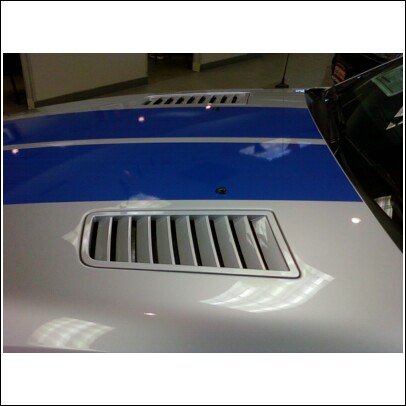

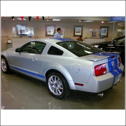

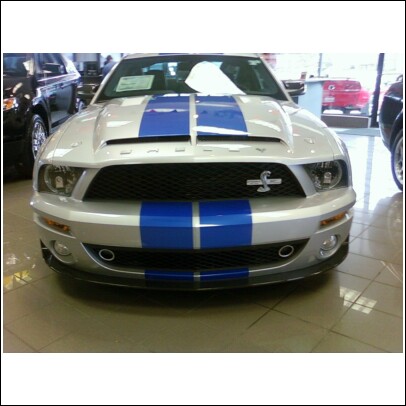

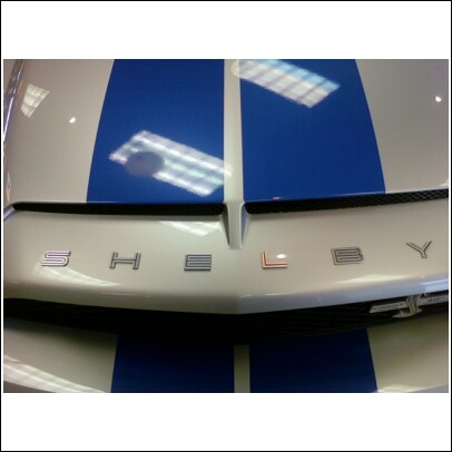

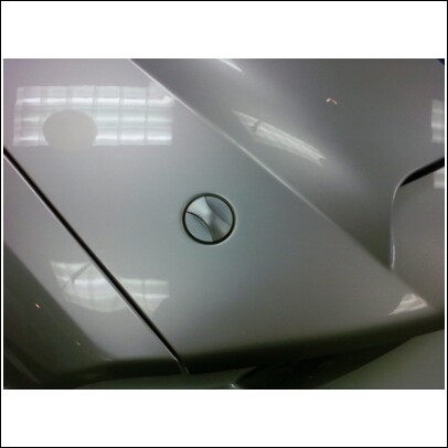

FYI: Dug out these these 2008 Shelby GT500KR window stickers and pictures for your review. Shows Optional Equipment: 3.73 Ratio Limited Sip Axle. "No Charge". As stated on this thread. Prices-Ouch! Enjoy!! CalStang
