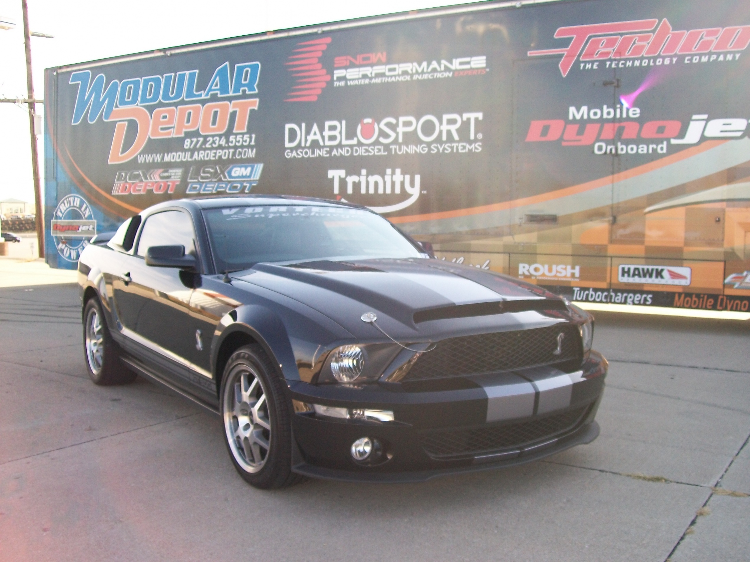

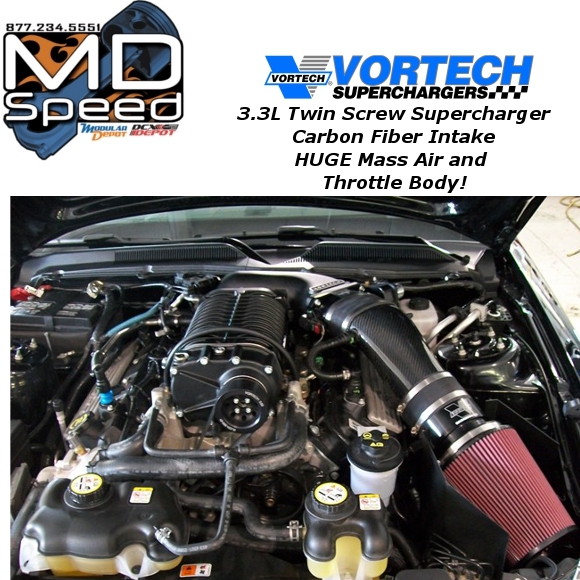

Tim brought us a stone stock '08 GT 500 to have a supercharger put on with the only exsisting mod being axle back mufflers We decided on the new Vortech/Lyscholm 3.3 twin screw supercharger. When doing GT 500 aftermarket blower cars they are usually installed with a set of headers. We were slightly disappointed in the power numbers with 640 RWHP at 19#.
The customer brought it back under our recomendation for a performance exhaust. We installed Kooks 1 7/8" headers, 3" catted mid-pipe and the exsisting FRPP mufflers. We threw her back on the dyno and saw the RWHP numbers jump up to 707 RWHP, which is an increase of 58 RWHP and 42 RWTQ!
Check out the dyno video and pics of Tim's amazing ride!

I'm curious as to how much of the HP and TQ gains are a combination of the blower/exhaust, and how much is just the exhaust. Any idea what this exact exhaust combo would yeild at the rears to an N/A, non-modded motor?
Old Oct 22, 2010 | 08:17 AM
mystichris@MD's Avatar
Former Vendor
Joined: February 13, 2008
Posts: 218
The exhaust was worth 58 RWHP on this car with the blower on it. On a N/A 3V GT we usually see about 25 RWHP with headers an O/R pipe and mufflers.
