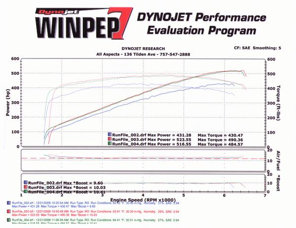

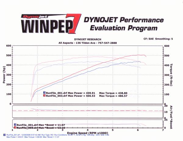

Not really. All cars are differant and your talking about a car in the 415-455 RWHP stock. We have dynoed about 20 GT500's and average is 445, but we have seen as low as 390's - 455 on the same dyno. That will effect the gains of a part.
Not every GT500 will dyno the same, so the average will be: 60+90= 150 devided by 2 = 75 RWHP.
Consistant means over and over again.
40 is not worth it.
Ford will only keep your warranty is you have FORD install it and you don't have any other mods.
Ford's Pro-cal is also none adjustable

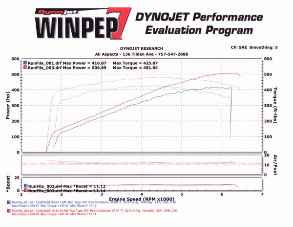

Below is a few of our before and afters.
Last is a K&N installed on a GT500.
We couldn't make a full pull as it was so dangerously lean.
Becareful running a K&N on the GT500 without a tune.
Hope this helps.
