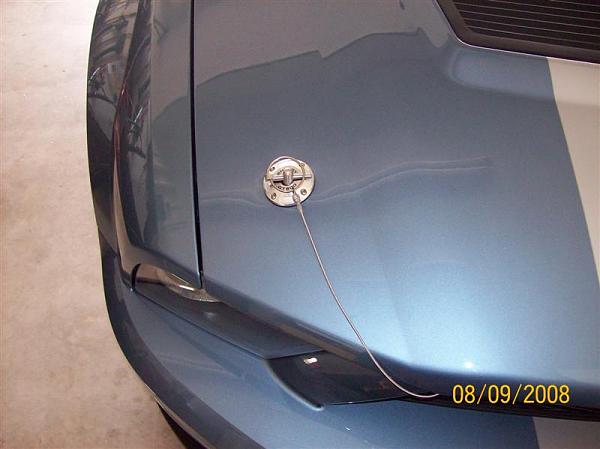

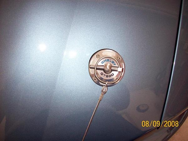

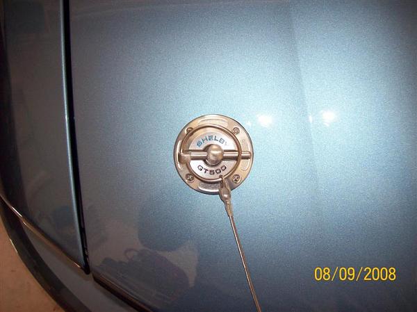

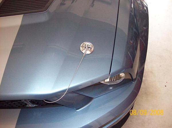

Done......
Part 1
Attached Thumbnails Hood Pins-100_0964-medium-.jpg   Hood Pins-100_0963-medium-.jpg   Hood Pins-100_0962-medium-.jpg

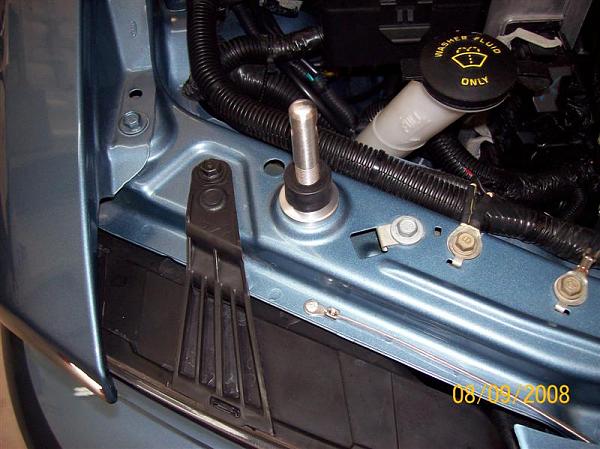

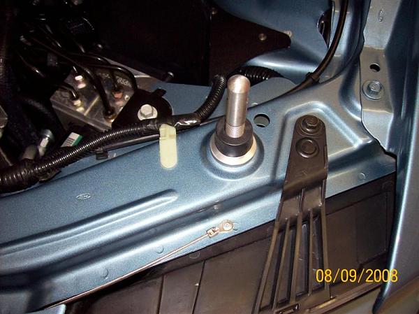

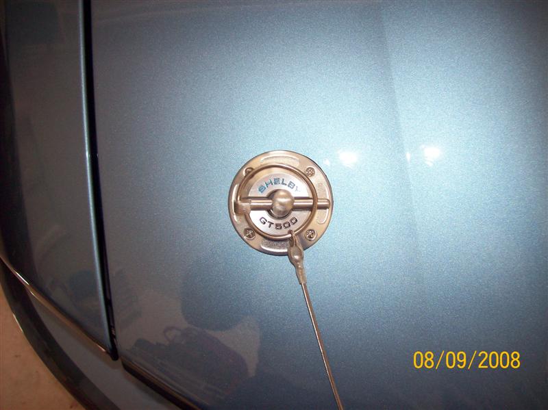

Part 2
Attached Thumbnails Hood Pins-100_0961-medium-.jpg   Hood Pins-100_0960-medium-.jpg   Hood Pins-100_0959-medium-.jpg

To anyone considering this mod here's some advice:
  • Run a tap through the 1/2" NF holes in the rivet nuts to clean up the threads. Do the same with a tap & die to the tooling to install the rivet nut. This will ensure there is no friction to cause problems during the installation of the rivet nut. Be sure to use some lubricant on the threads during the installation as the instructions call for.
  • Prior to permanently installing the rivet nut and beauty washers in the radiator core support, be sure the beauty washer is fully seated on the rivet nut's shoulder.
  • Prior to drilling the 4 holes in the hood, use a drill that is just small enough to fit through the 4 holes in the billet plates to accurately transfer the screw's hole pattern onto the hood. Then switch to the 1/16" drill as outlined in the instructions. The final hole size will need to be 7/64" for the screws to fit properly.
  • Prior to drilling the holes to secure the lanyards to the core support, be sure to install a stop on the drill bit to prevent the drill bit from puncturing the headlight housing
