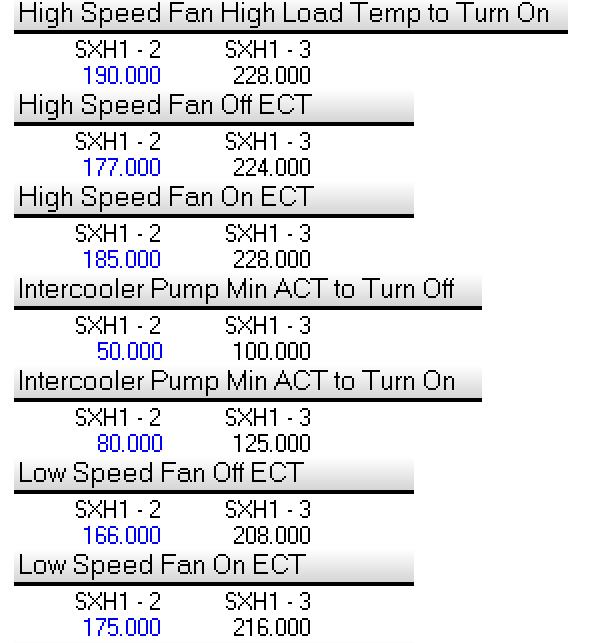

Got impatient and installed a 160 t-stat last night. The physical design is slightly different. The replacement might not seat (seal) completely when closed. If this is true, the engine will take slightly longer to attain operating temp. I'm not worried at all here. Datalogging while warming up showed about a one degree increase every second or two. Not significantly slower than with the stock t-stat.
I have not had a chance to drive it yet but a preliminary warmup to full operating temp indicates this t-stat will work. With lowered fan turn-on temps, a manual high-speed fan turn-on switch and LED indicators for low & high speed fan operation, I was able to confirm the temperature stabilized at 166 degrees. Today, a little spirited driving in 105 degree temps should yield conclusive results. I bet my high-speed circuitry will finally be kicked on by the PCM. Stay tuned....
On a tangent, I also lowered my IC pump running parameters.
