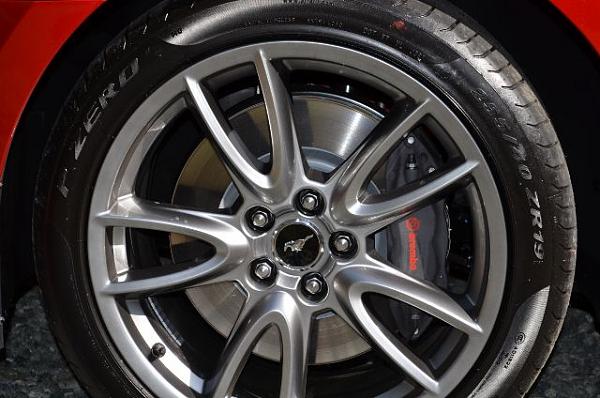

It's a close tolerance fit.

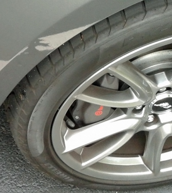

Yeah, definitely not much clearance with the Brembos and the OEM 19's ... lol
