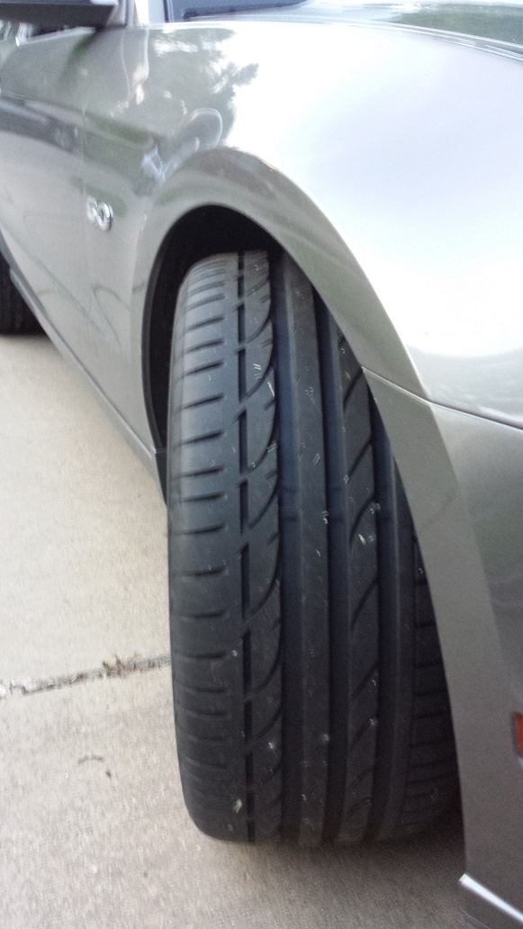

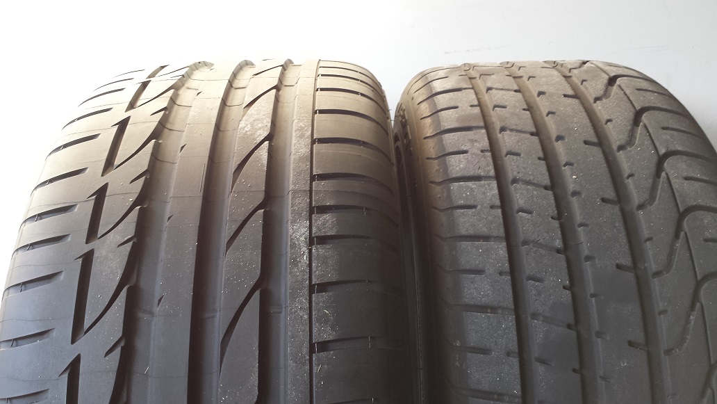

Jazz, I've heard of quite a few people doing 275/40 on the Brembo wheels.
I've stuck with my 255/40 setup for now, but for track days I put 275/40 setup on 19x9.5 wheels to keep the proper footprint and sidewall angles. Here is a few pics
Attached Thumbnails Widest tire on a Track Pack wheel?-20140721_103709s.jpg   Widest tire on a Track Pack wheel?-20140617_080930s.jpg   Widest tire on a Track Pack wheel?-20140616_211023s.jpg   Widest tire on a Track Pack wheel?-20140616_210657s.jpg   Widest tire on a Track Pack wheel?-20140616_200046s.jpg
Monster, Love the wheels and the set up you have. What are they and where did you get them?

SVE Drifts in Dark Stainless from LMR...one of the wheels I'm considering.
What lasered said.
They are 5lbs lighter than stock Brembo wheels, and can fit up to 285 rubber within spec. For $189 each they were a good deal.
