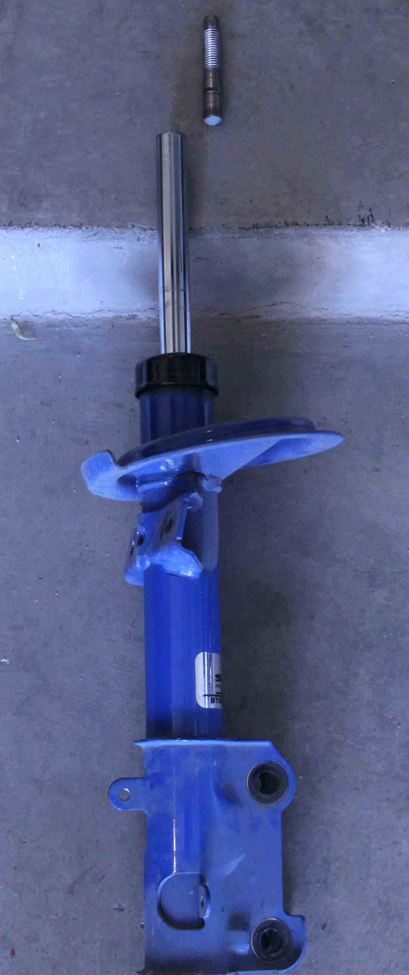

Has anybody else had this problem? As I was backing the car out of the garage I heard a pop noise and my driver side strut mount snapped. The struts and shocks were installed 15 months ago and have about 4000 miles on them. My set-up is the Steeda Pro-Action shocks and struts with the Steeda sport springs, and the Steeda HD upper strut mounts. Thank goodness I wasn't driving down the road!

Did the strut mount break or did the strut cylinder break at the thread termination? Hard for me to see on the small phone screen!

Originally Posted by Horspla
Did the strut mount break or did the strut cylinder break at the thread termination? Hard for me to see on the small phone screen! John
The nut that holds the strut in place (under the hood) is still tight with no play...looks like it broke at the top of the strut before the threads. I'll take more photos of it once I get it removed.

Ok so the strut itself broke? I have the HD mounts and sport springs but with Bilstein struts.

I think that's what he's saying... I couldn't for the life of me figure out how one of those HD mounts could have broken.
Be interesting to know the cause of failure once Steeda has had a chance to look at it...if they do.

will be interesting to hear what caused that... if they find the strut rod is bowed, may have been cracked by a pothole or something, but if the rod is straight and it just snapped??? weird failure for sure.
I had a neighbor who was going down the street one day, I was in the garage heard a hellacious racket out front- I was afraid she ran over a bike or something- here she had a frozen strut that jarred the car hard enough to break the subframe loose on the car, dropped the subframe toed the tires way out, and busted off a 'shock asorber' that ran from the engine to the core support(think it was a old chevy citation or some similar POS)... just mentioned as perhaps strut seized up and first good bump got it- but even that seems a unlikely way to fail.
assume the car has never been hit on that side, and that noone ever took a torch to it

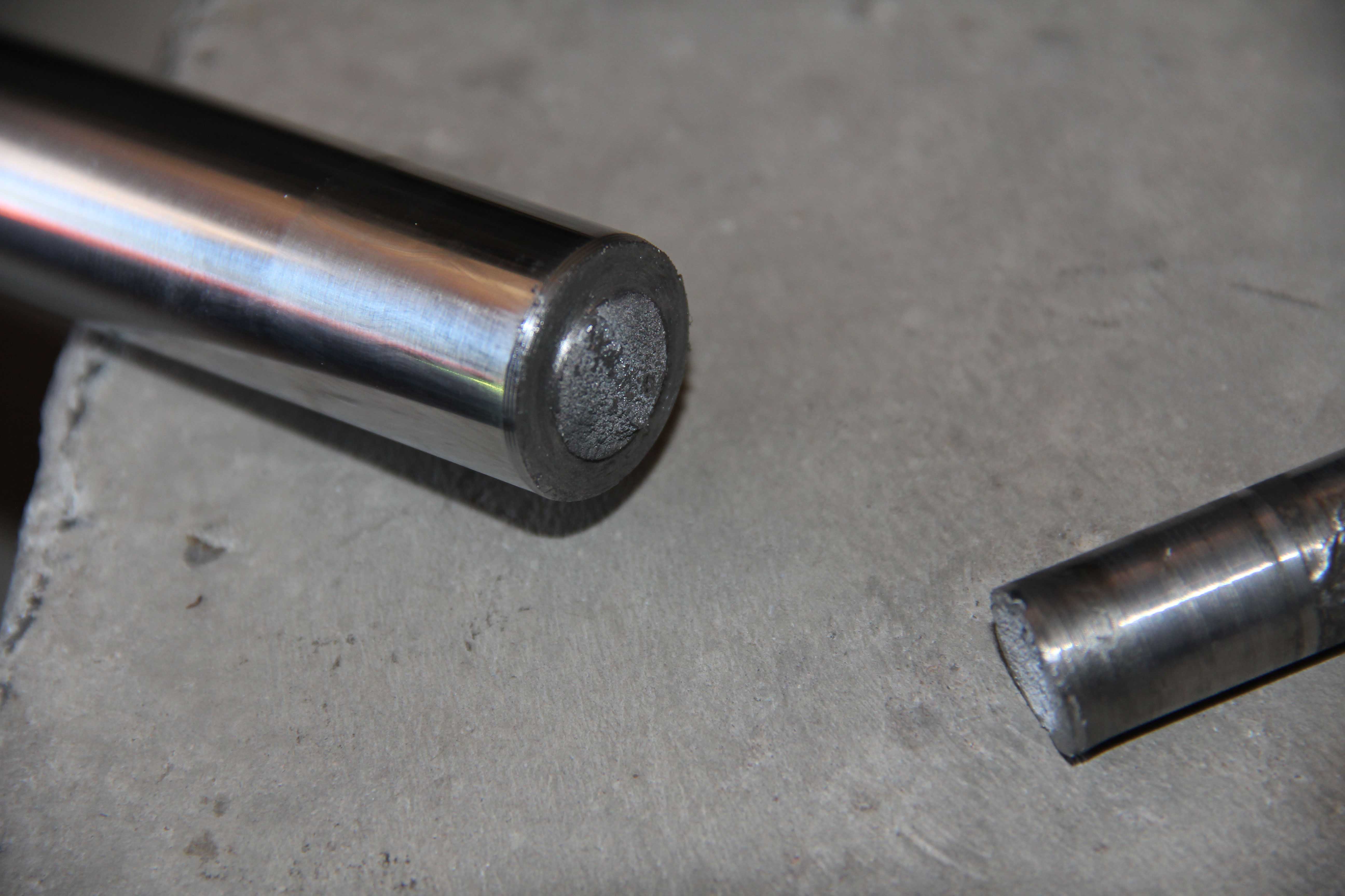

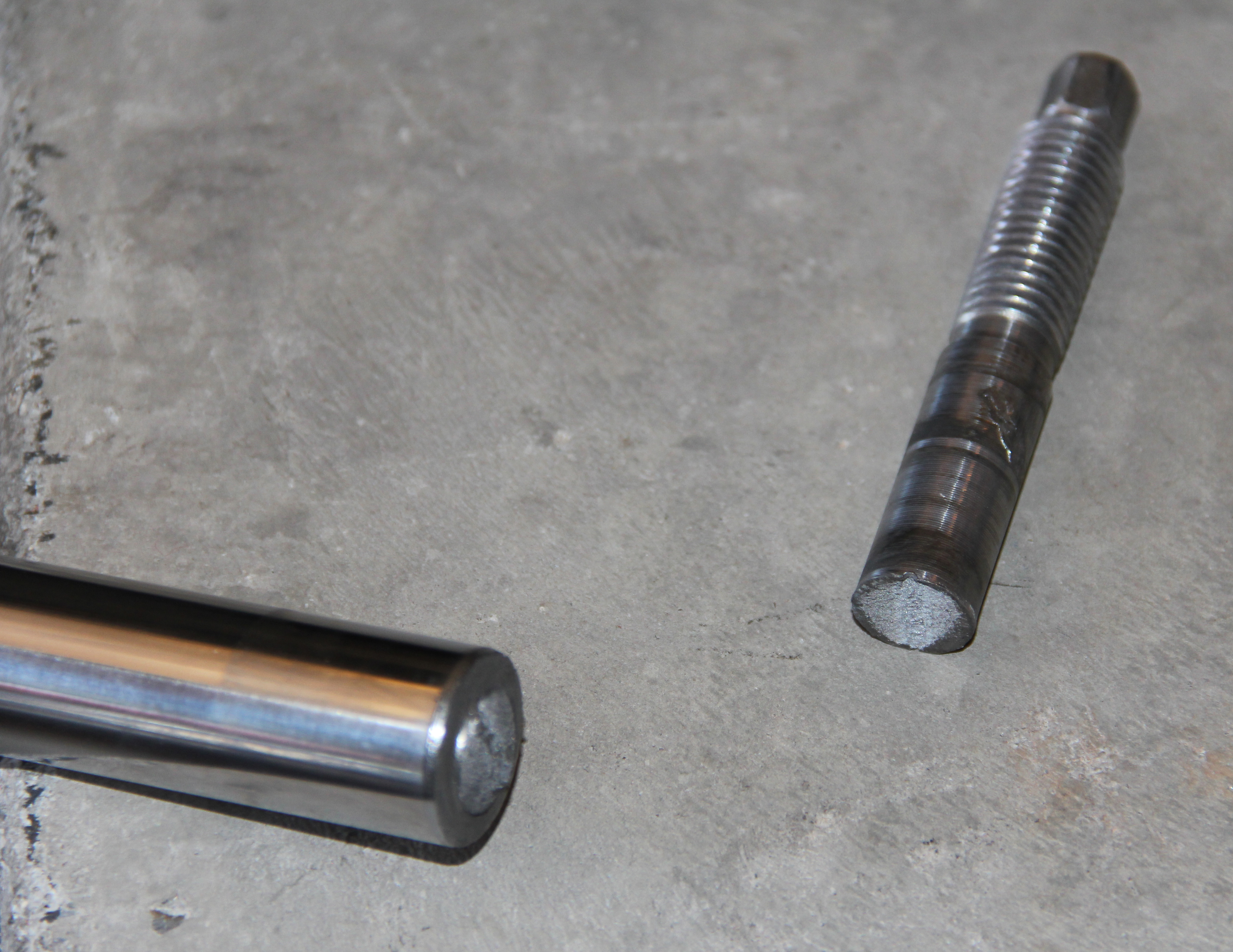

As promised…here's a closer look at the damage to the strut. So far there's no damage that I can see to the HD strut mounts. Steeda shipped out new struts and HD strut mounts, should be here by Thursday.
