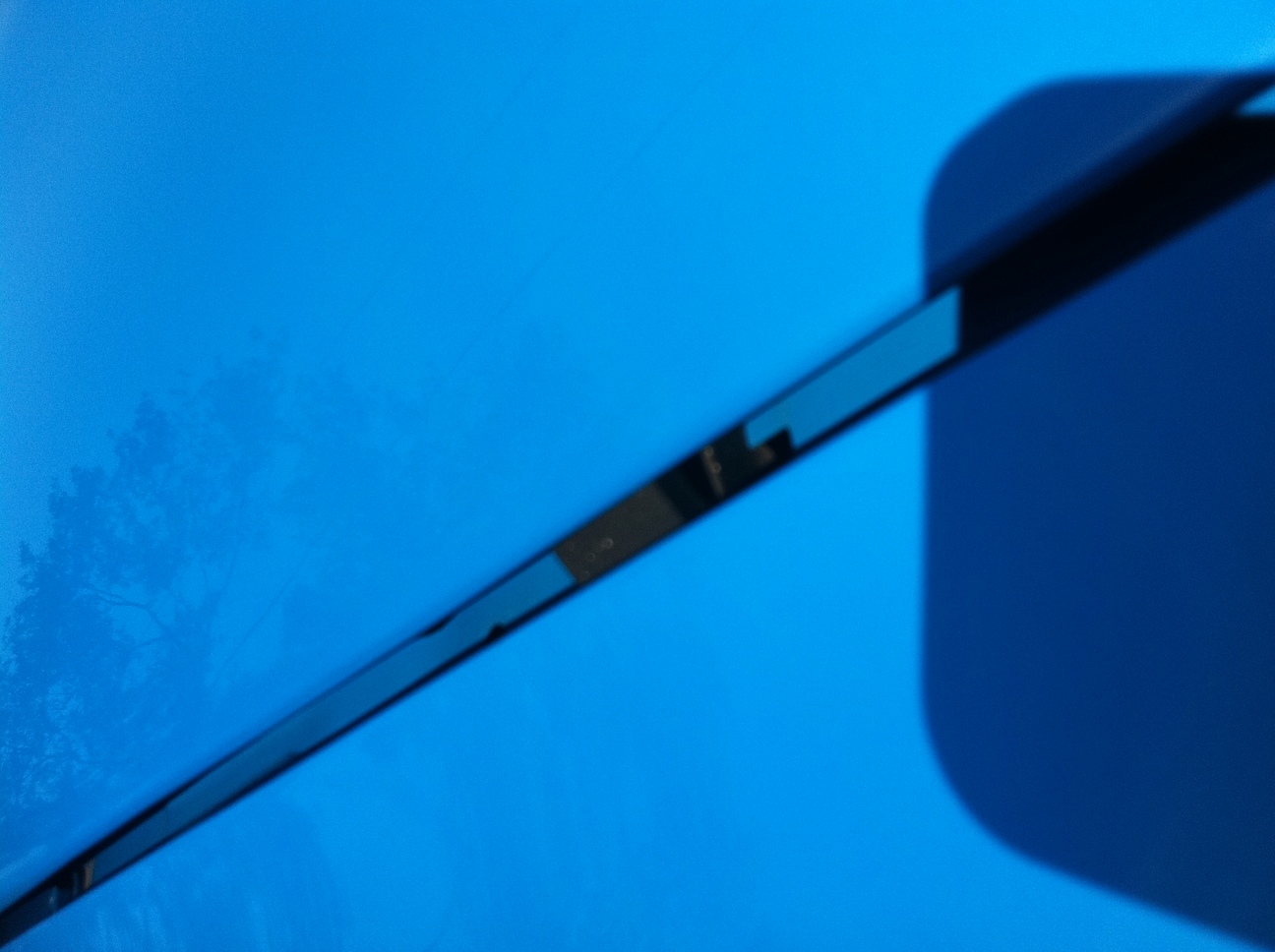

Anyways heres a picture of the gap AFTER being worked on by two different shops, it's the best they could get it. This is just one part, figured nobody would care to see them all.

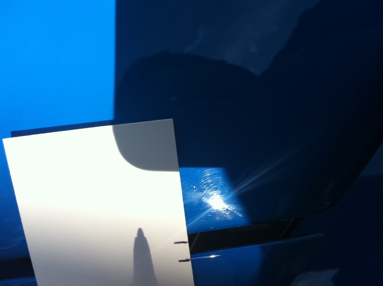

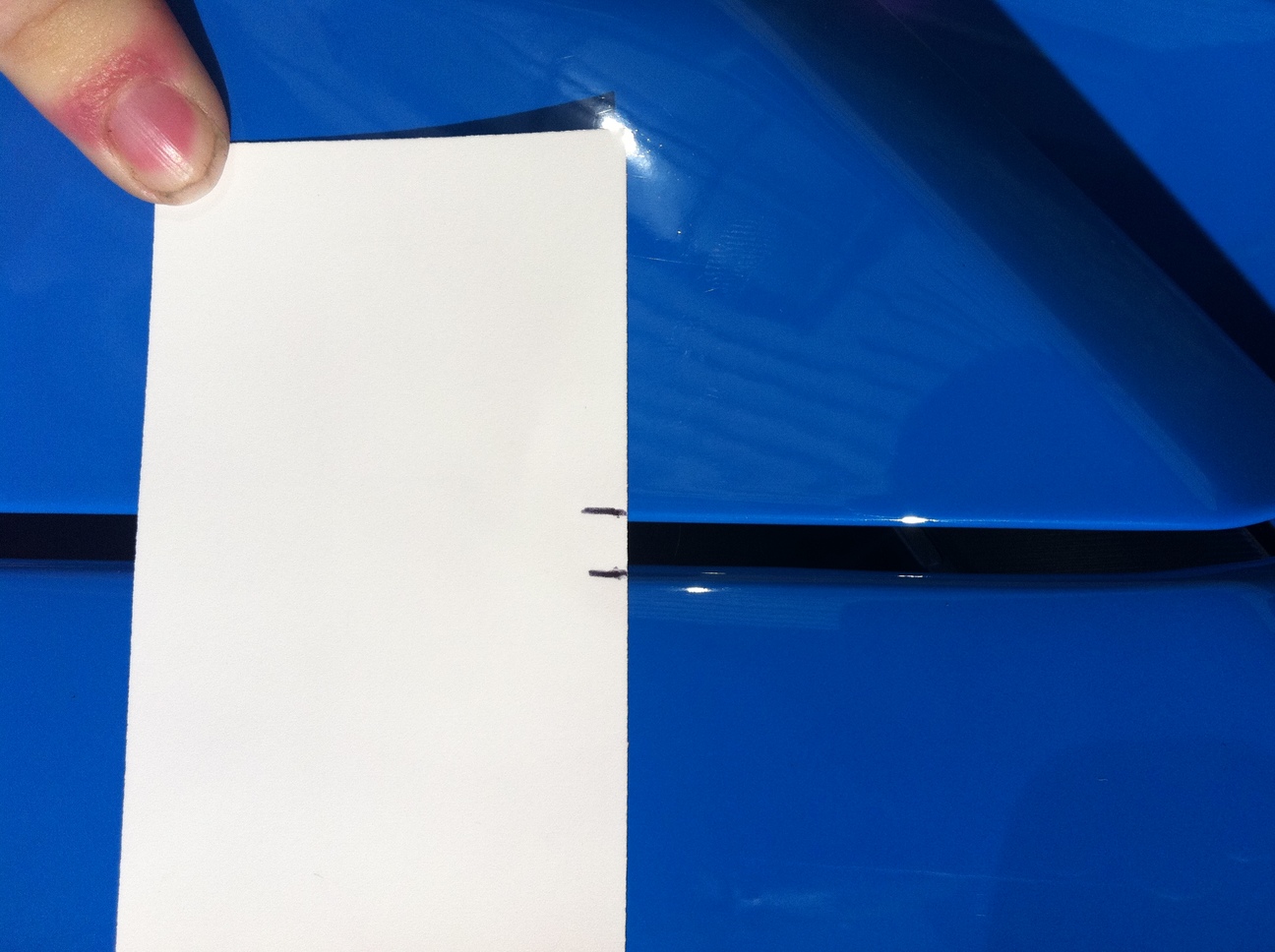

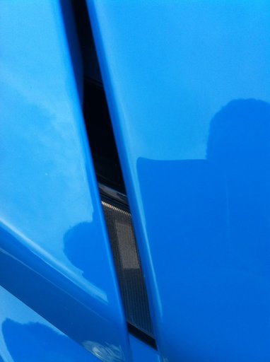

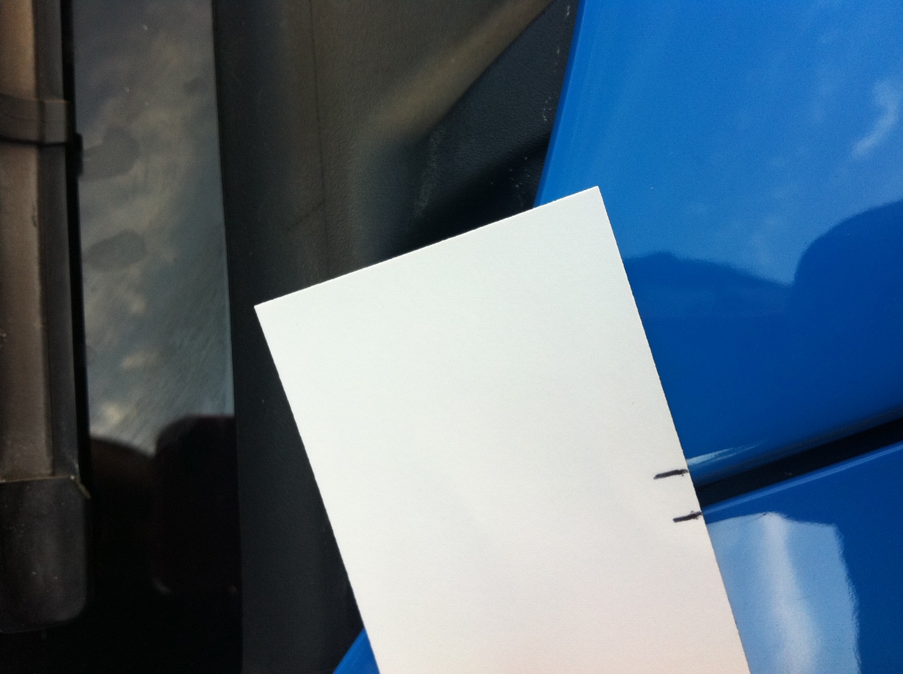

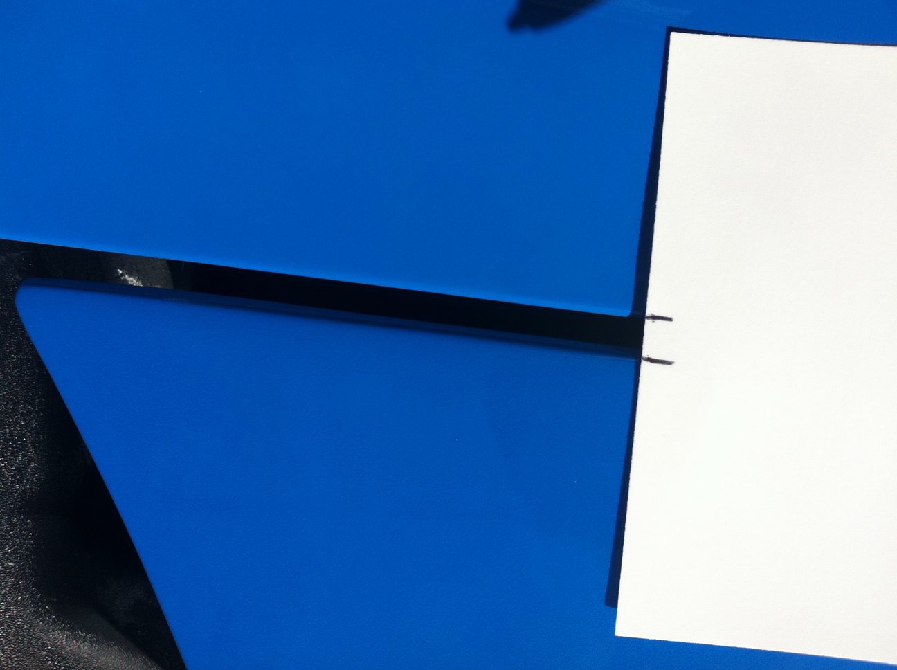

I know exactly why they asked the questions, I'm not stupid. I understand that if two four thousand pound vehicles hit each other....there may be an issue. Just ask and I will PM you the VIN# so you can carfax it!
Second I took it to different shops and they both said the same thing. The shops are in different towns, and I'm very good friends with the owner of the Mustang shop, he wouldn't BS me. I can also PM you the paint shops owners name and phone number, so you can talk to him, he's already OK'd it this morning.

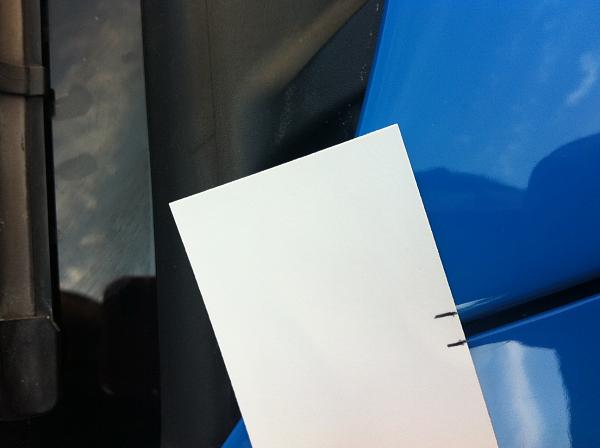

Rather than take measurements I have take pictures with a reference points, can't fake those. I aligned the card by eye so as to get the card in the same spot each time, forgot to do the same with the camera angle.
As you can see the drivers side is 100% perfectly aligned with the fender, the other side is way off! Let me know if you need other angles or under hood pics.
Attached Thumbnails Steeda Q-Series Hood-rsz_img_0666.jpg   Steeda Q-Series Hood-img_0667-2-.jpg   Steeda Q-Series Hood-img_0668-2-.jpg   Steeda Q-Series Hood-img_0669-2-.jpg   Steeda Q-Series Hood-img_0670-2-.jpg

I would also suggest taking a few measurments between the fenders front and back, to see if anyone else has a wider measurment than yours

They only sell aftermarket hoods, if not for enthusiasts like me they wouldn't sell a single part!! Can't imagine many insurance companies asking what hood the customer wants lol.
Pics added.

The new pictures are useless because it only shows what we all already know, you have some alignment issues. Steeda requested measurements to try help you out, I'll suggest you comply and the sooner you will be out of this mess.
Well the pictures show one side of the hood perfectly aligned with the fender, and one side not so much. Maybe I have the advantage since I can see the hood and took the pictures.
I took 3 measurements in metric for accuracy, starting with the drivers side. Took measurments at closest to windshield gap, mid hood gap, and closest to front of car. Measured looking directly down, and measured the actual gap from edge of hood to edge of fender.
DS top- 4.5mm
DS mid- 4.5mm
DS bottom- 4.5mm
PS top- 3.25mm
PS mid- 5.5mm
PS bottom- 6.5mm
Hopefully those numbers help you see what pictures couldn't show.
