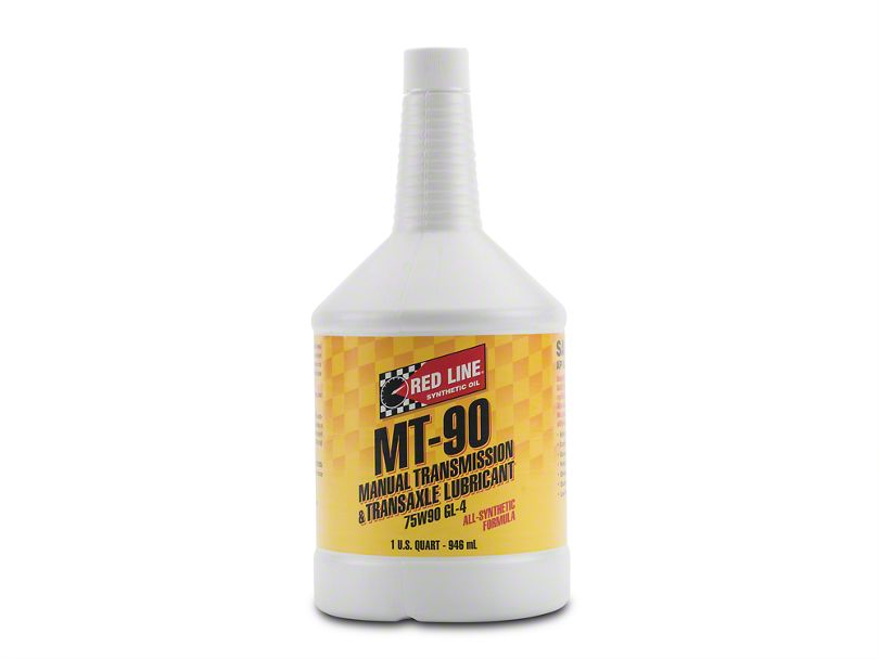

Are you using the Redline MTL or one of their other gear lubes?
Old Apr 27, 2018 | 08:30 PM
5.M0NSTER's Avatar
Joined: August 2, 2013
Posts: 3,090
Likes: 254
This is what I'm using now. But my shifing issues started about 4 weeks before I switched to this. Before this I was using Royal Purple Synchromax.

Redline does not make a fluid that meets the current spec for the MT82. The fluid that you are using is thicker than what Ford recommends. I have been using the Redline MTL with good results, but it is thinner than what you are using and I don't drive it in cold weather.
