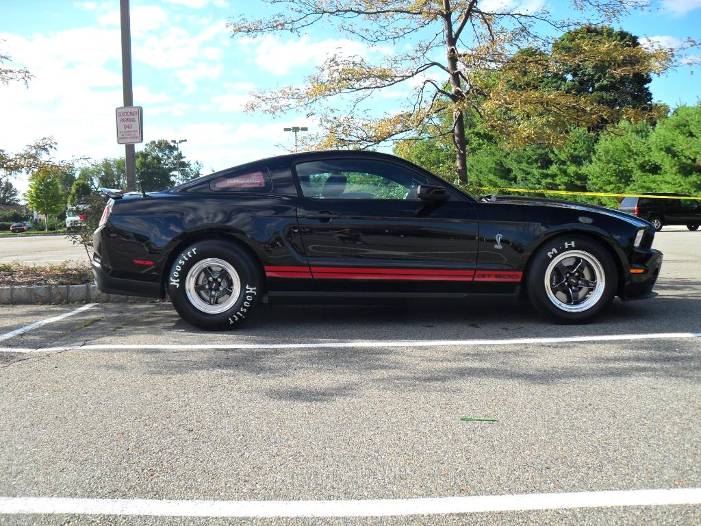

Tires: ............................... Wheels:
Front - 28 x 4.5 x 17........... Front - 17 x 5
Rear - 28 x 11.5 x 15.......... Rear - 15 x 10
No clearance issues with the front brakes. ( Brembo ) On the back, the rear swaybar had to be relocated. ( BMR & others make a kit )
TPMS fault - hit the reset button.
This tire/wheel package is for the track, it saves weight & allows me to hook up. Also, these are bias ply tires, handling is not part of their skill set. ( they do see some street use )
