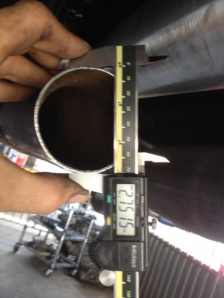

The 3" pipe accounts for the inside diameter of the replacement pipe versus the outside diameter of the stock pipe. The new sections slip over the old pipes and they are welded to them.

Outer dimensions

You need 3". You don't want to go smaller and shops will only have 2.5 or 3"

Ok so 3" seems to be the consensus and it makes sense. I certainly don't want to go smaller so 3" seems right.
