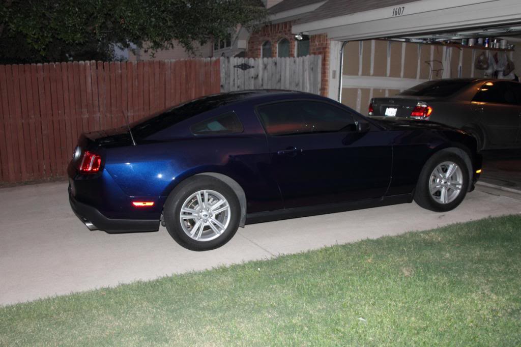

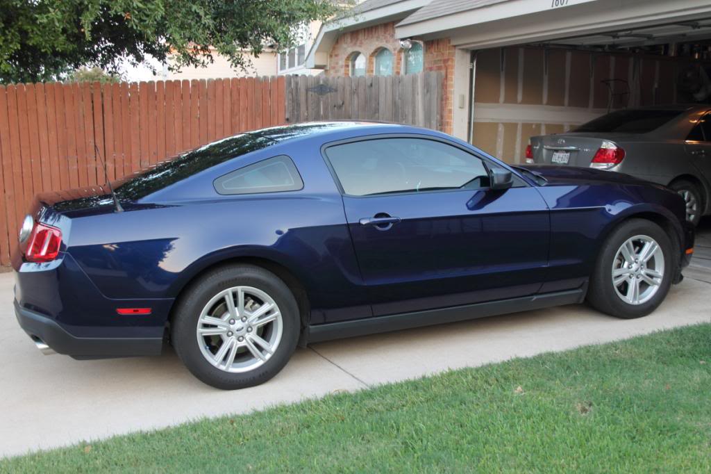

If you lower the rear more than about a half inch you'll probably need to replace the shocks as well. If you don't, expect them to blow their seals and wear out prematurely. They were designed for a specific travel length, and keeping them constantly compressed an inch more than they were designed for will wear them out faster.
Also an adjustable panhard bar is a MUST. Even with a 1/2" drop it moved the rear end of my car about 1/4" to the driver side. It's almost impossible to drop the back end without needing a a panhard bar adjustment.
As far as lowering springs for the rear goes, there are several good options. The Brembo 55D springs were mentioned (I have them and they work very well, but they don't entirely level out the car). Roush also sell a rear spring lowering kit. And of course you always have the option of going with a full set of springs and only installing the rears.
Brembo 55D springs on a base model '12 Mustang.
Before:
After:
