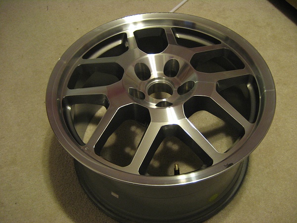

My car isn't even due in until next week (yeah right), but I wanted to have a full size spare tire to fit over the Brembos and also not cause trac lock problems. I bought a used 07-09 GT500 18" wheel off ebay for $50. Then I ordered a cheap used tire from www.bestusedtires.com, size 255/45/18. That and the 255/40/19 have very similar diameters. The full size spare will fit in the spare tire well, but stick up roughly 2 inches. I might need to let a little air out of the tire, but the car comes with an air pump. I'll have roughly $150 in my spare, and lose a bit of trunk space, but is well worth it for the piece of mind.

hmmmm . . . are you sure that will clear the Brembos? I thought that required 19" wheel?

07-09 GT500s have 14" Brembos and use these wheels. When I get the car, I'll update the post after I bolt on the wheel.

Falken used an 18" wheel. A Ford GT or FR500 style I believe.

Do you plan on cutting the carpet and trim in the trunk to accommodate the wheel/tire? I assume that the spare tire well is not deep enough to place the carpet back over it.

You can fit a fullsize tire in there but the panel/carpet sits an inch or two higher than the rest of the floor surfaces in the trunk.

Not sure, I hate to cut up anything on a new car. I'll probably just lay the carpet over it, even though it won't lay flat. Supposedly it sticks up 2 inches. Here is a pic I found where someone did cut the carpet.
