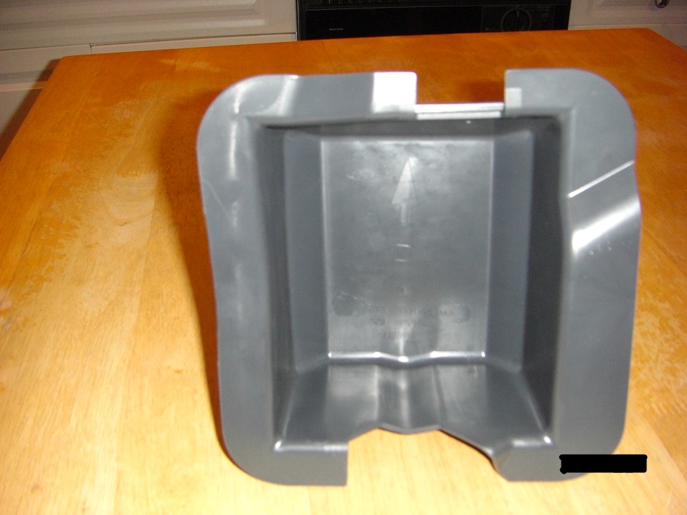

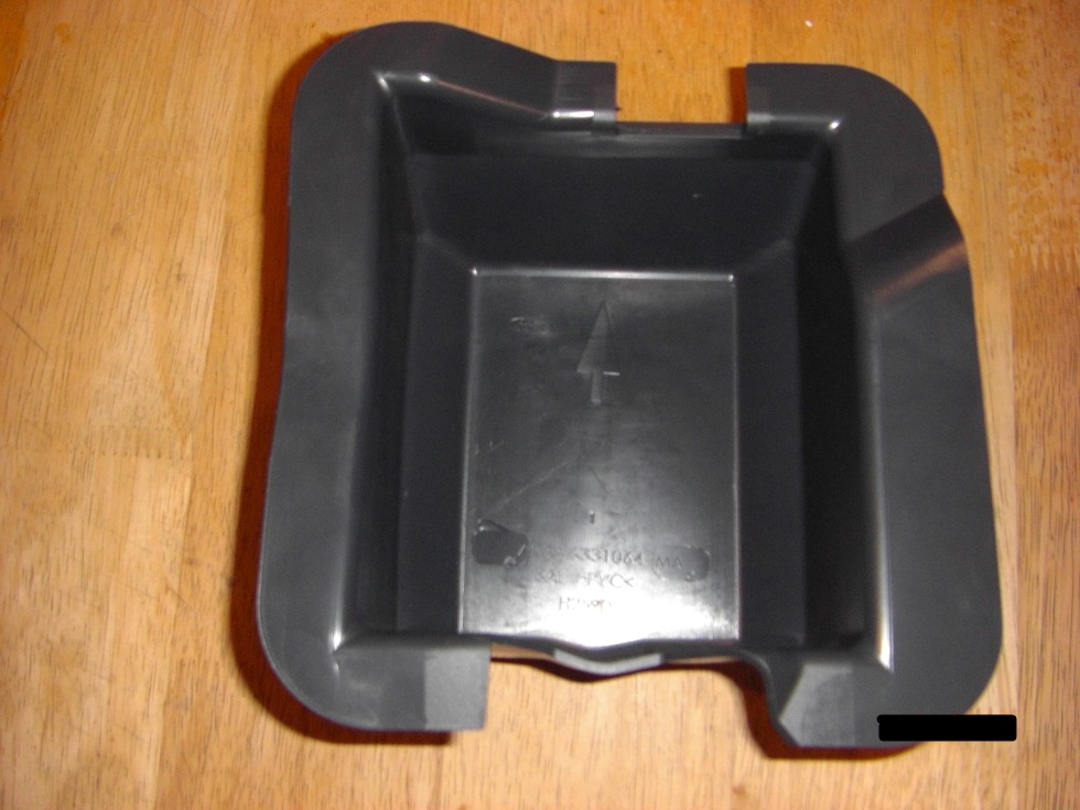

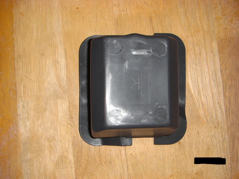

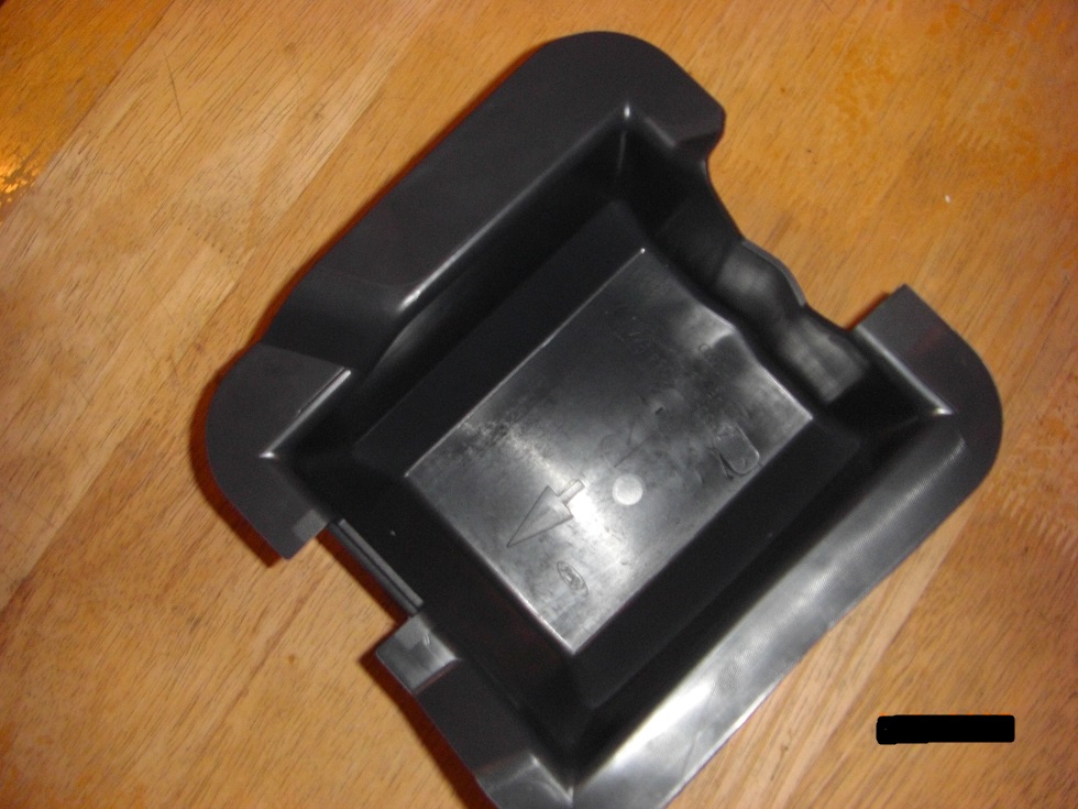

So apparently my dealer forgot to put this part back where it belongs! It's definitely a interior part. Soft rubber part that should be from under the rear seats somewhere.? Does anyone know what the hell it is? Is it important to have it put in it's proper place? Here are the numbers off the part. 7R33-6331064-MA This next # is just below the first set of numbers H259D Any help would be greatly appreciated. I've attached some pictures of the part. Did a search on google & Ford parts & got no results.

Thanks so much for the info you provided! Yeah your right it still doesn't tell me exactly where it goes. However we now know for sure it's a interior part that is a moisture shield for the seat belt.??

It's a splash shield, similar idea to the one your door is 'skinned' with behind the door panel. It goes in behind the seat belt retractor to prevent water from getting in the thing and messing it up.
You'll have to pull the side trim out and put it in, lest you wind up with the seat belt not working should you really need it to. I'd take it back to the dealership, and *watch them do it*, or find another dealership.
