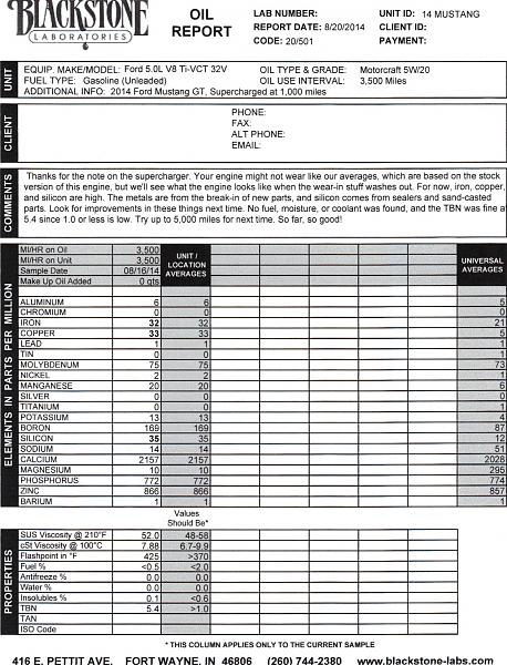

I changed my factory fill oil @3,500 miles and had a used oil analysis (UOA) performed, here's the report:
Attached Thumbnails How often and how much are we paying for oil changes?-08-20-2014-02-30-05pm.jpg
Interesting. To me that confirms why many of us change out the oil within the first 1000 miles on a new engine before cycling into the owners manual recommended intervals.
Service guy thought I was odd when I brought mine in for first change at 550, saying it didn't need it that soon. I smiled and said I hear ya, but do it anyway. Glad I did.
