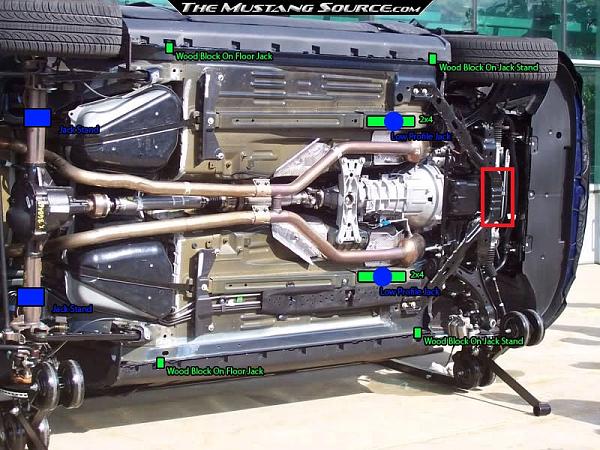

Rear, I go under the Differential in the rear with a 2X4 Block and place the jack stands on the frame running back to where the Gas tank straps mount.
Front I go under the motor on the crossmember , still using the 2X4, place the jack stands on a 2X4 where it says to use the Low profile jack
Awesome pic thanks a lot! Nothing beats a pic like that!!

Forgive my stupidity (I'm new to auto DIY), but where are the lower control arm mounts and pinch rails? Can I see them on the picture that Siber Express posted?

lower control arm is what connects the axle to the chassis. There's one right behind each rear tire attached to the axle. The ones in the picture is black.
pinch weld runs along the entire underside of the car right where the very bottom of the body work is under the door. all the little square openings with the screws up along the top of that picture, that ridge is the pinch weld.

I jacked the whole front with a floor jack under the center of the K member (red box). Seemed fine.
The owner's manual says NOT to jack the rear under the diff. Not sure if they're worried it'll slip off or if something would be damaged. I've jacked my '05 under the diff, but I have a really annoying vibe in that car (probably not related, but who knows).
