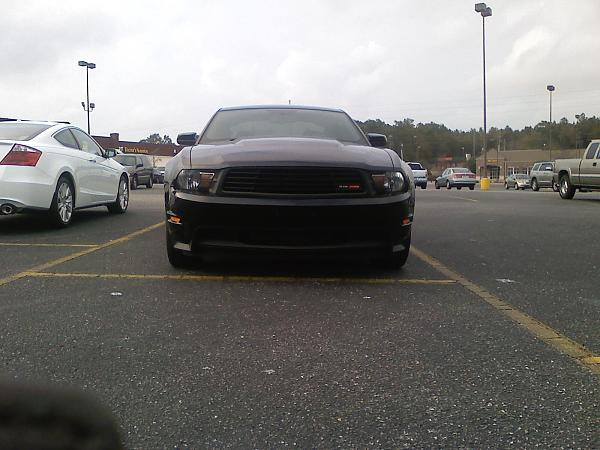

The Saleen grill is the way to go on the 11/12 GT.
Attached Thumbnails GT Fog light delete for more airflow- suggestions-0121121641-02.jpg

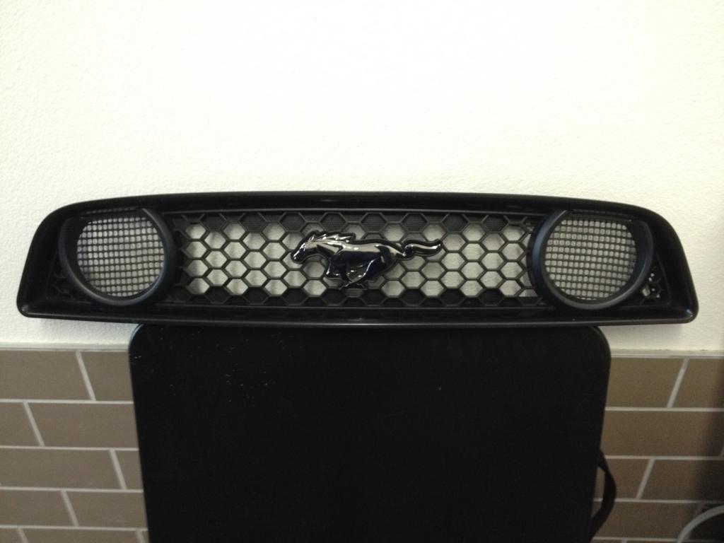

This is what I did. It was free for me. I got the mesh from my neighbor. I had to take the front bumper off to remove the fog lights since I didn't want to cut the brackets but it was easy. This is the only pictures I have right now the car is in storage right now.
