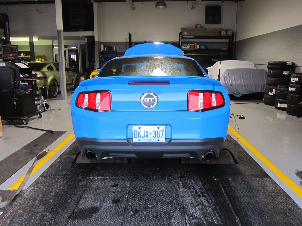

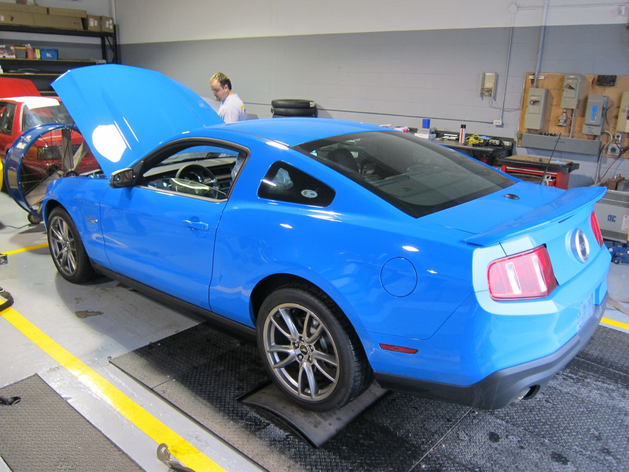

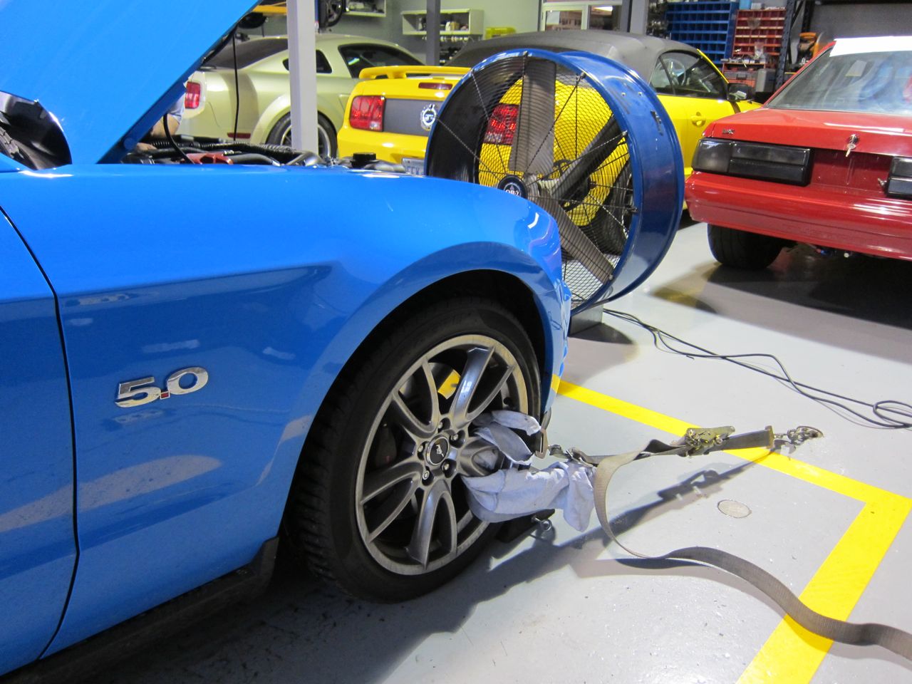

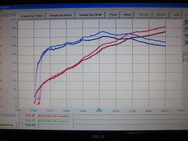

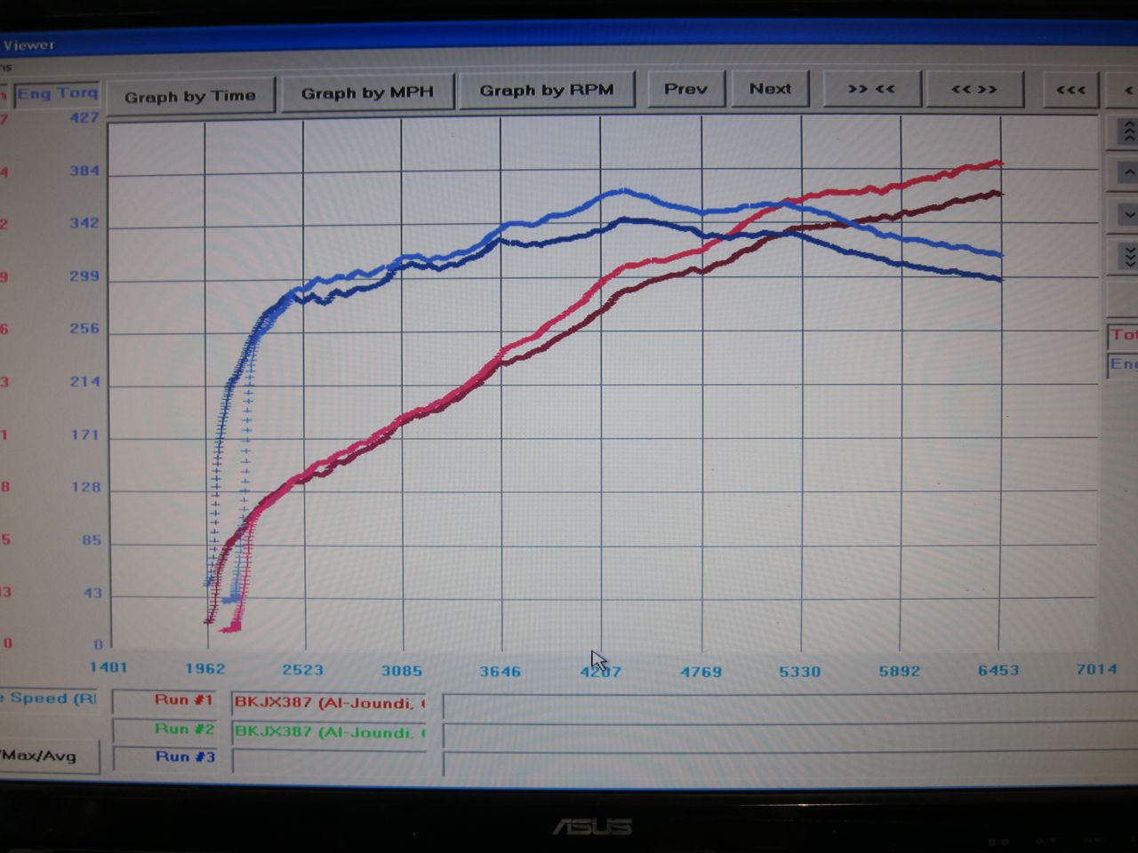

Since the CAI wasn't in, Steeda put my car on the dyno for a baseline pull, then hooked up the tuner and flashed with their 91 Octane optimized tune and then put the car back on the dyno for a second pull. In a week or so when they get the CAI in stock, I'll be back for the install and for a 3rd dyno to compare the results.
My Car is a 2011 5.0 with 3.73 gears and M6 transmission, bone stock with the exception of a GT500 axle-back exhaust.
Both dyno pulls were in done in 4th gear with 91 Octane. It was about 65F out and was humid. Dyno was set to pull to 6500rpm.
BASELINE - Stock car with GT500 axle-back
HP = 364.9 @ 6413 rpm
TQ = 344.5 @ 4331 rpm
2ND RUN - Add Steeda 91 Octane TUNE
HP = 389.3 @ 6429 rpm
TQ = 367.1 @ 4328 rpm

Those are good results and looks like it will be a good experience over all. Can't wait to see the Vid, since I'll be running the same mufflers once my car shows up.

Wow, nice gains! I'd be very interested to see what kind of gains you will get with the CAI. Thanks for posting this, very informative!
