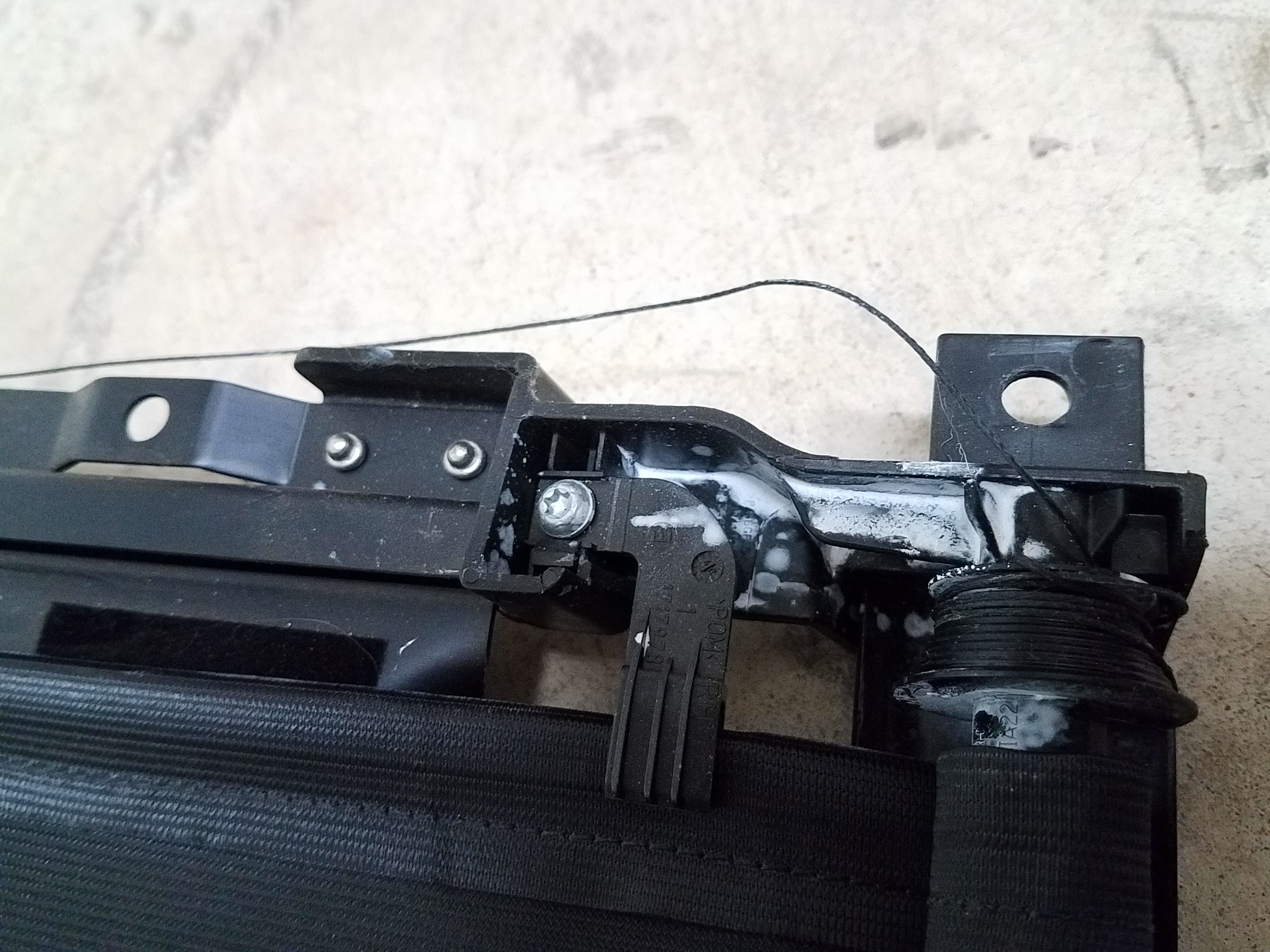

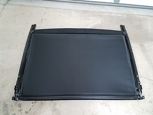

Well I fixed it! I'm gonna slap a video together later but it wasn't too bad. There's a tiny cable on a spool one each side and one of the cables got misaligned and pinched and caught in the roller. Realigned and reassembled and it works!
Attached Thumbnails Glass top Mustang sunshade removal?-20170210_211000.jpg   Glass top Mustang sunshade removal?-20170210_211012.jpg

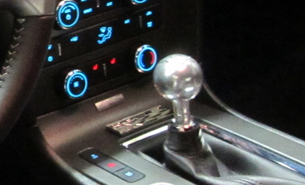

I can't say I have never used mine, but it has only been a few times. Only when it gets over 105° and my shift **** is so f'n hot I get an image of the shift pattern on my hand when you grab it. Got to love that aluminum shift ****.
