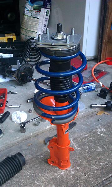

I lowered my car about two weeks ago and installed P spring, Konis Str Struts and Steeda HD mounts. The driver side has been plagued with a squeak ever since. I tore it all own greased ever thing, reassembled and the squeak disappeared for about two weeks. Then it came back today as bad as ever.
Frustrated I took it to Ford and the tech was nice enough to help me identify where the noise was coming from, the top of the drivers side strut. So its narrowed down to being one of these two items. I followed Steeda's instructions to the "T" during install. I have tried everything I can think of to fix this.
My next guess is to take the drivers side strut mount off change it to a Ford one and see if that fixes it. If it does its the Steeda HD's if not its the strut. Or at least thats my logic.
Has anyone had a similar problem? I tried searching and can't seem to locate much info on the Steeda HD's squeaking and anything I turn up on the Koni's squeaking seems to usually be caused by something else. Any help is very much appreciated.

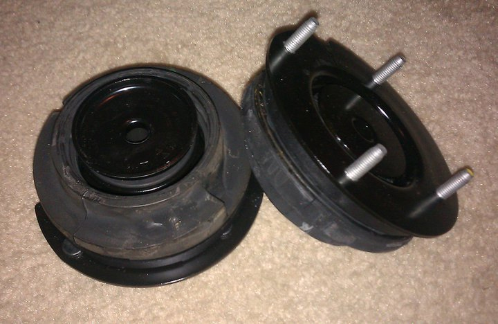

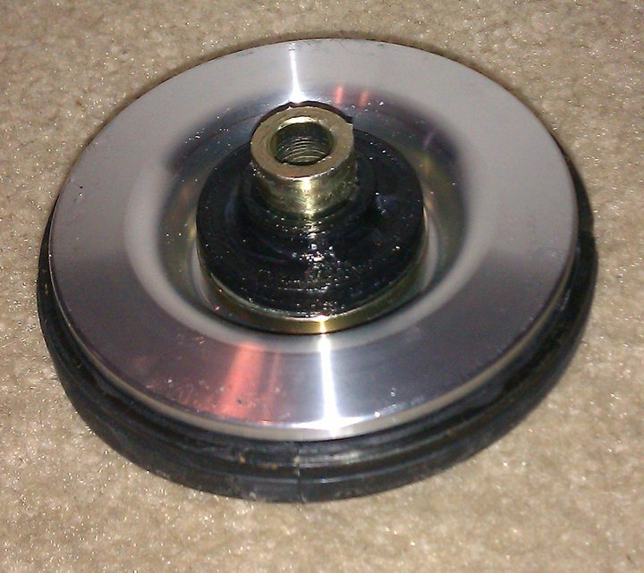

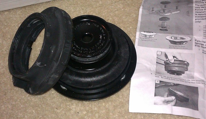

It should be the correct isolators. I ordered them directly from Ford. I have attached pictures of the Isolators and the Steeda Mounts being assembled. Please let me know if these don't look correct or like I missed something.
Attached Thumbnails Font Squeaks - Either Koni or Steeda HD-1.jpg   Font Squeaks - Either Koni or Steeda HD-2.jpg   Font Squeaks - Either Koni or Steeda HD-3.jpg   Font Squeaks - Either Koni or Steeda HD-4.jpg
Old May 11, 2011 | 02:09 PM
Modshack's Avatar
Joined: July 15, 2010
Posts: 532
From: Greenville NC
They look right..

Looks like the bottom of the spring isn't seated right in your video. I maybe looking at it wrong .
