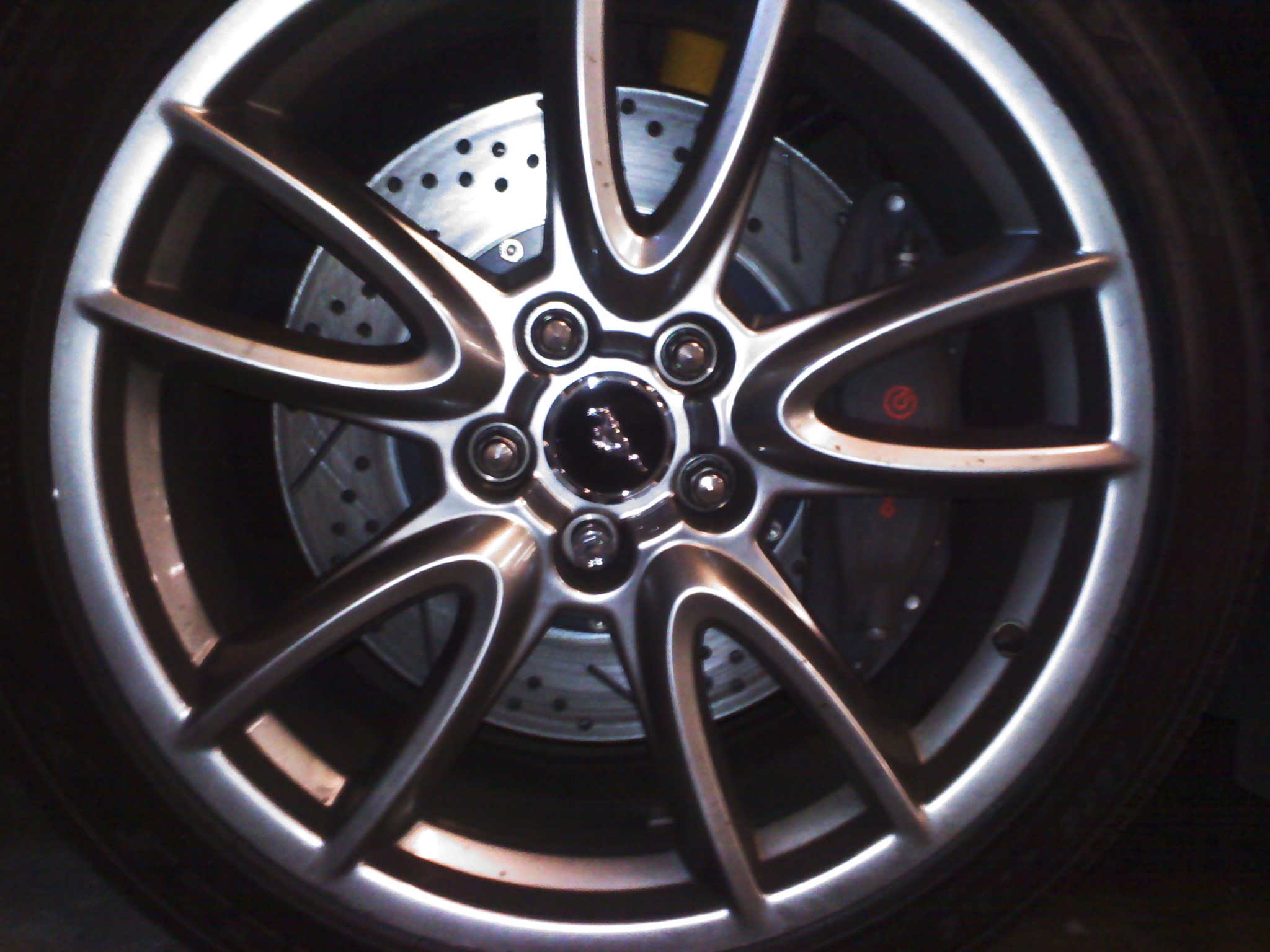

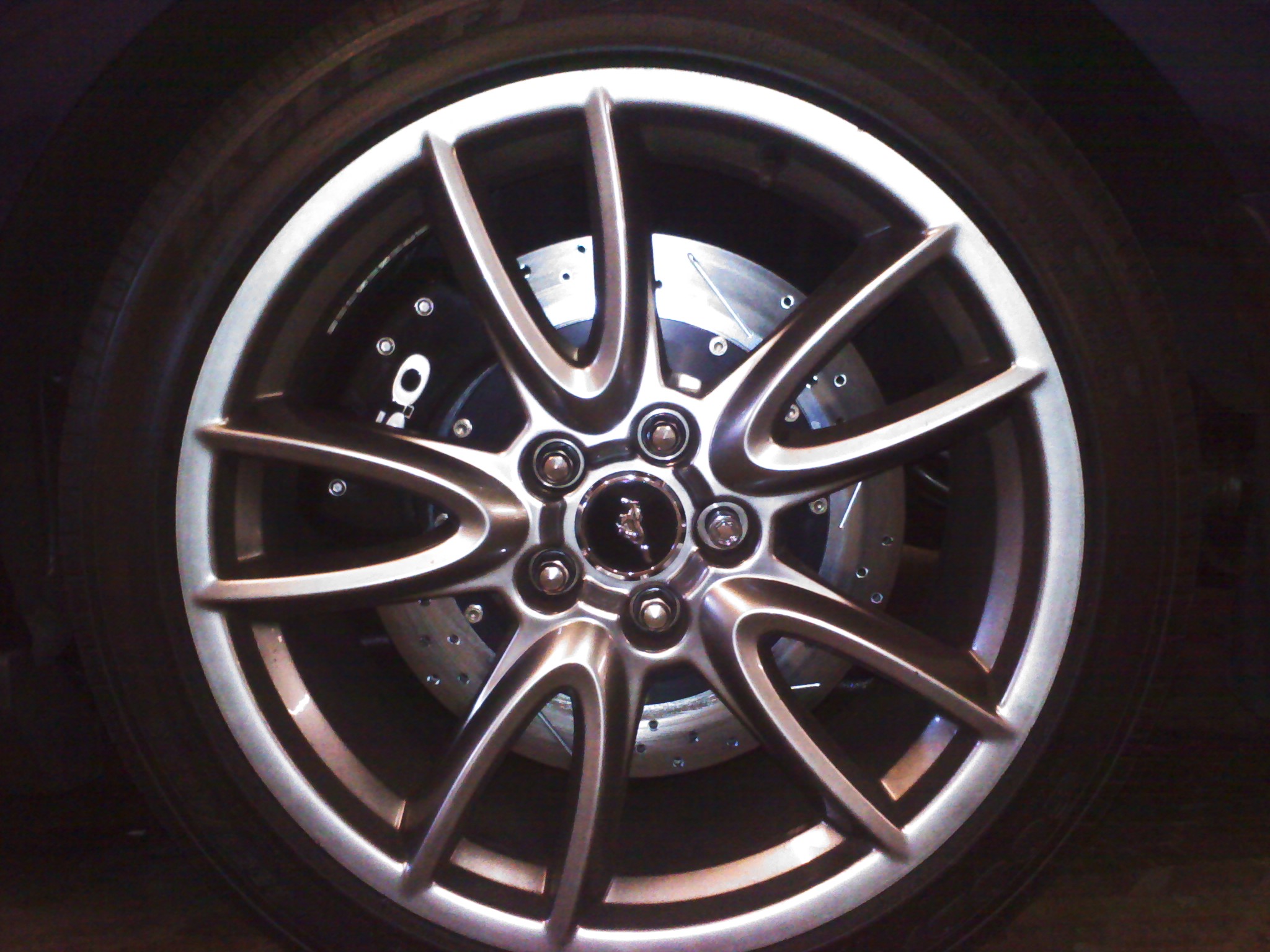

Finally installed my 14in front/rear 2 piece drilled/slotted rotors
Front/rear

What brand rotors? Hope they get put to good use! Interested why you chose drilled?

Looks great. I have the one piece drilled and slotted on a few of my other cars and trucks. They never fade and seem to last for a long time.
What brand?

Baer. Ordered from the Shelby Store

Keep them cool better and while slotted removes the gases.

Yes, agree on the cooling benefits, but the drillings are stress risers. Just curious if you track the car much, and if so I'd be interested to see how long the rings last before you get propagating cracks.
What pads do you run with them?
Look great though, 2-piece rotors are in general very nice and the big rear rotors vastly improve the look of the car in my opinion!

Looks killer! I like the matching caliper covers too.
I have the same set of Baer Eradispeed Plus-Two 14" rear rotors waiting to be installed.
They weigh the same 13.5 lbs as the dinky 11.8" one piece factory rear rotors. Much larger, more leverage/brake bite, same weight. Sounds good to me. I don't track my car, so I am not worried about stress cracks from the drilled holes, especially on the rears that see less heat.

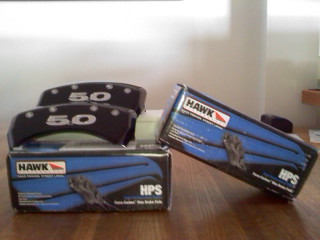

Sounds good !!!! A little advice with MGP rear caliper covers thou. Having experience with mine, you are going to have to play with the bracket when installing them. They want to rub against the rotors. I tried everything and cant get them to stop squealing !!! They sound like when your brake pads are getting low !!! Right now I got them as quiet as possible, but not 100%. It gets annoying !!!

I appreciate the heads up. I have heard the same thing about the covers rubbing the top of the rotor but thought it was related to an individual installation issue. Not good to hear.
Is there any way you can think of to better shim them away from the rotor? Let us know if you are able to resolve this issue, thanks!
