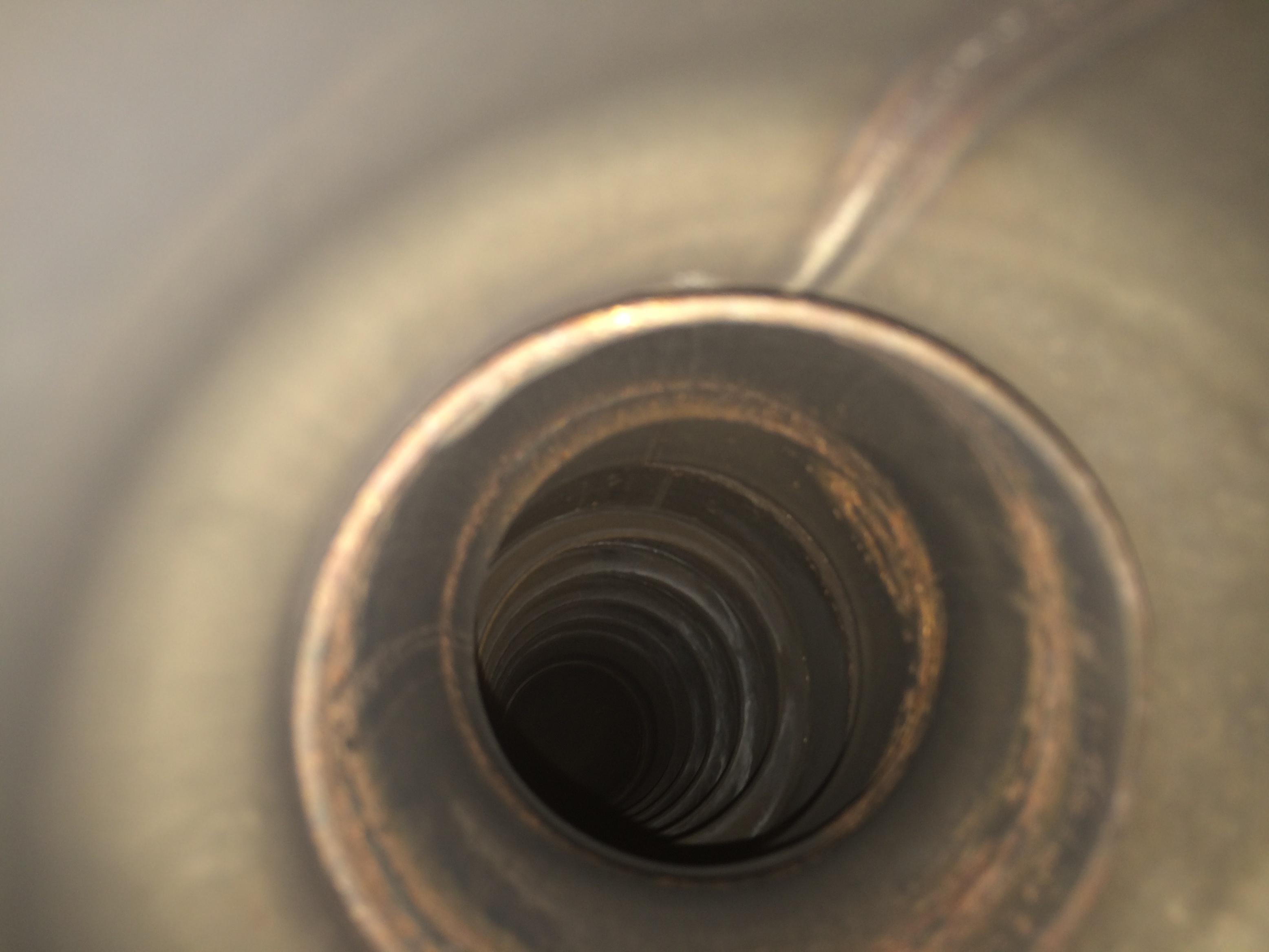

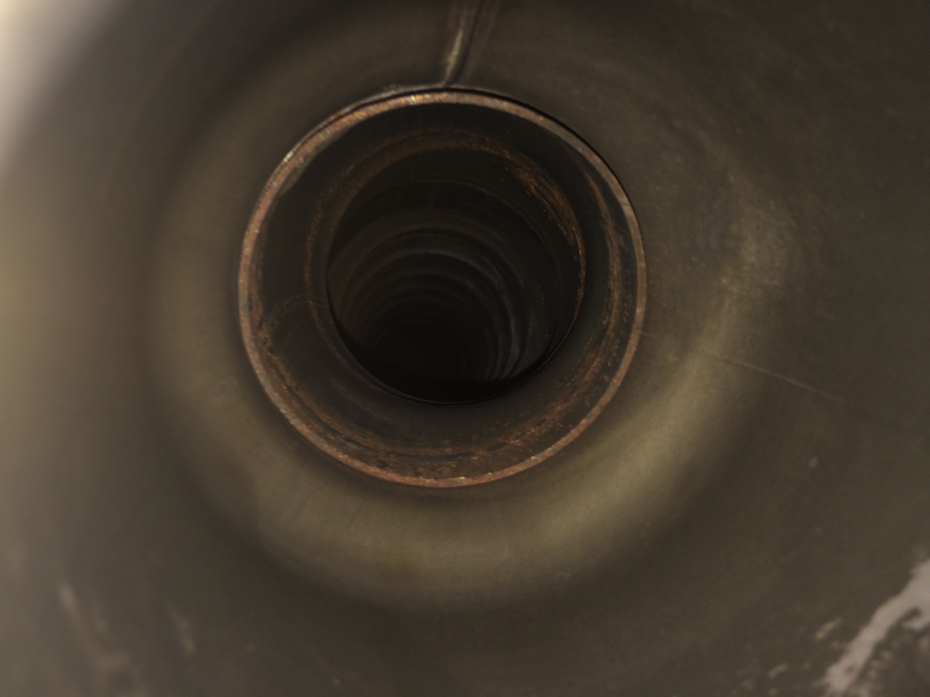

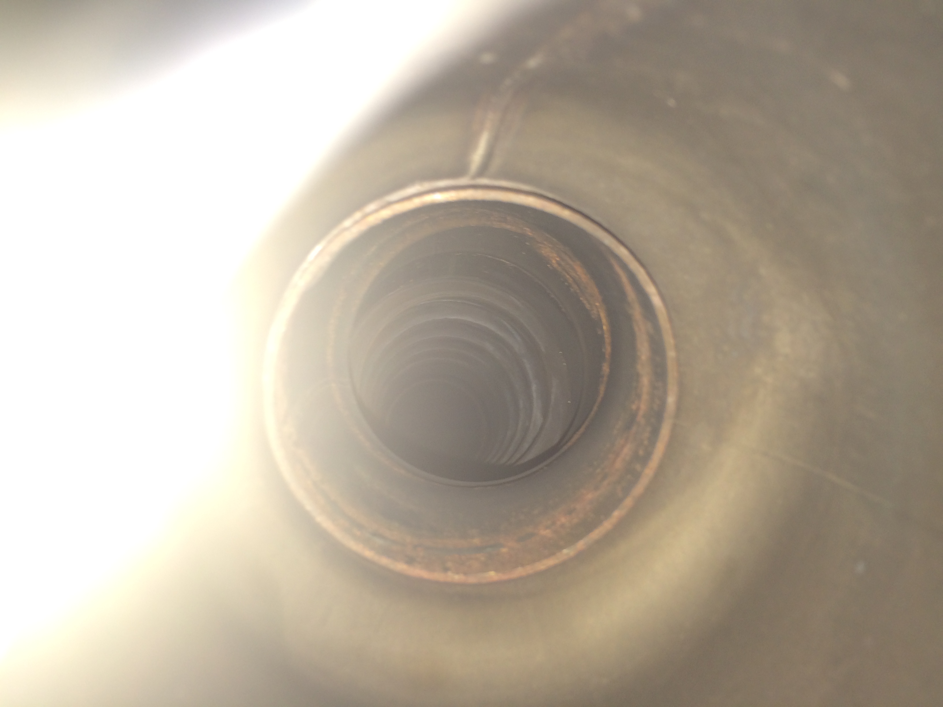

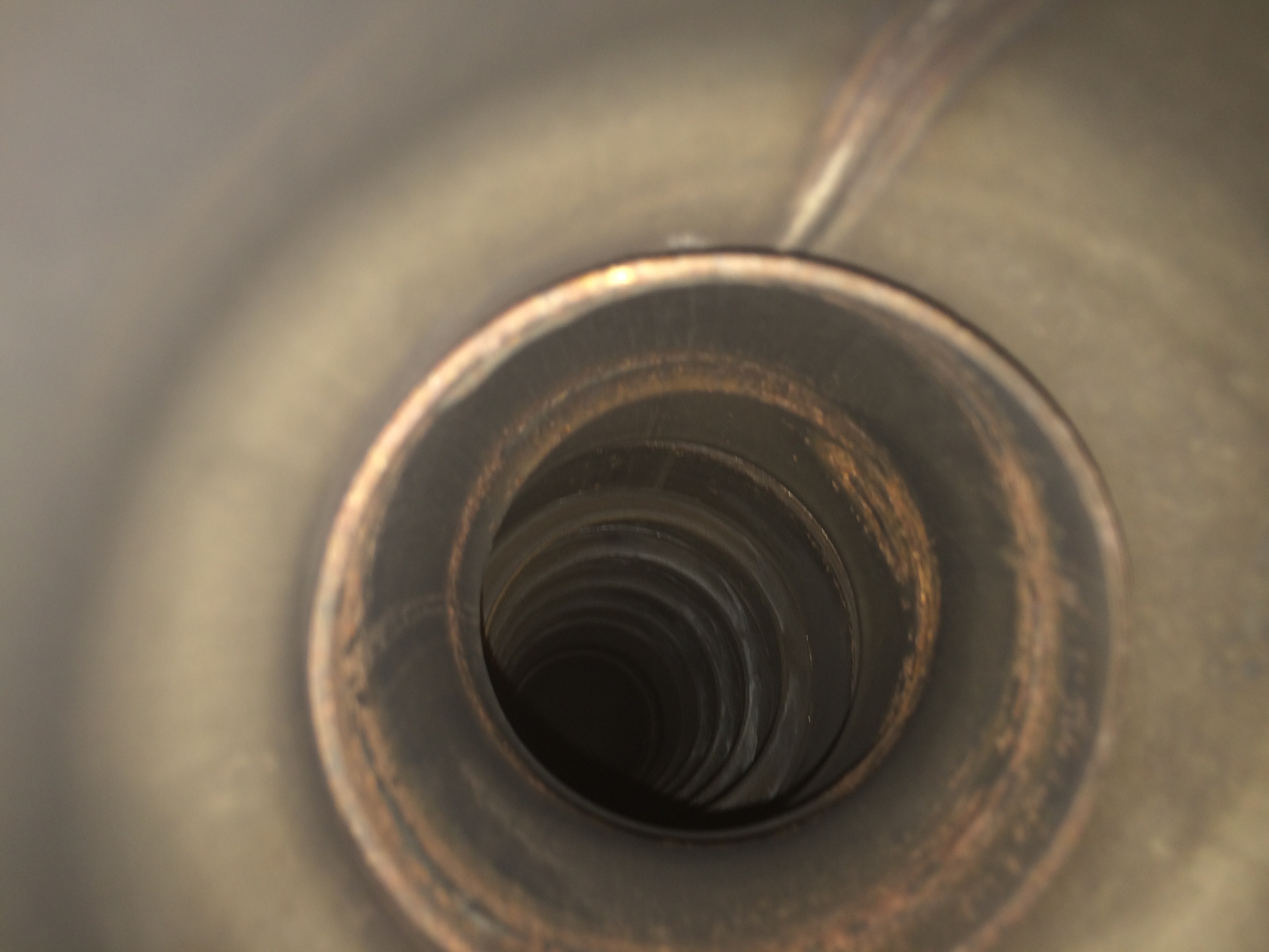

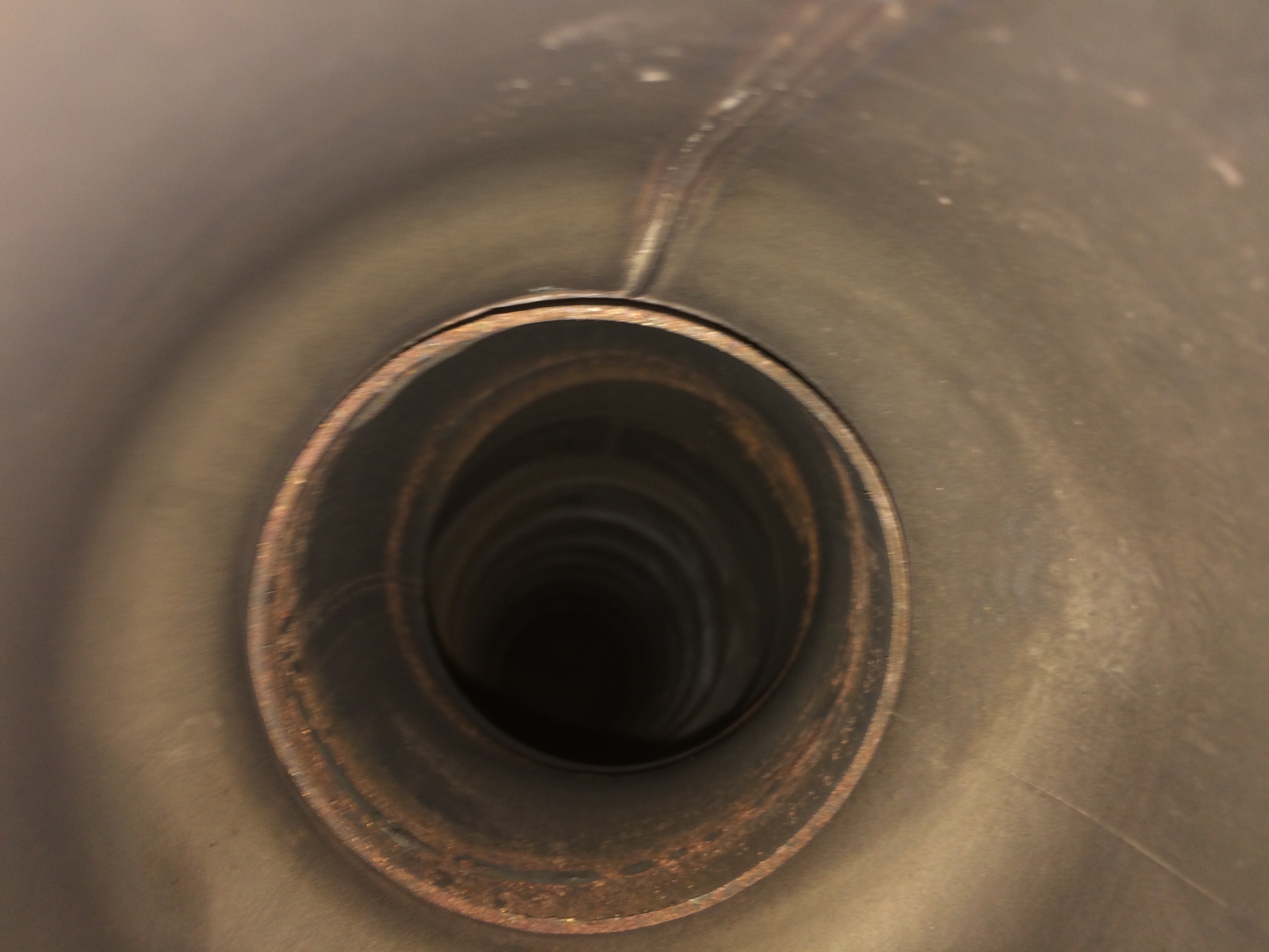

I did look inside and found something that looked odd. I posted some pics but I dont know how well you can see it. Basically down the muffler where it curves I saw something might be blocking or just there for some reason. It looked like some sort of mesh (or maybe it seemed mesh like from the light ) but I am sure there is something in both mufflers. Should I try poking it and see what happens?
