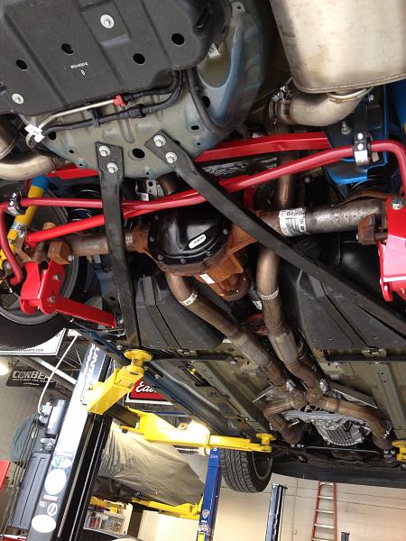

Old Sep 27, 2013 | 06:36 PM
rk2112's Avatar
Joined: December 26, 2009
Posts: 295
From: Pittsburgh, PA
Here is a pic of my setup.
