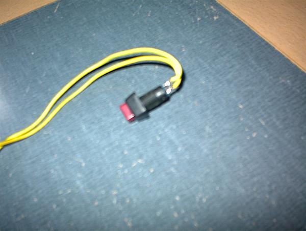

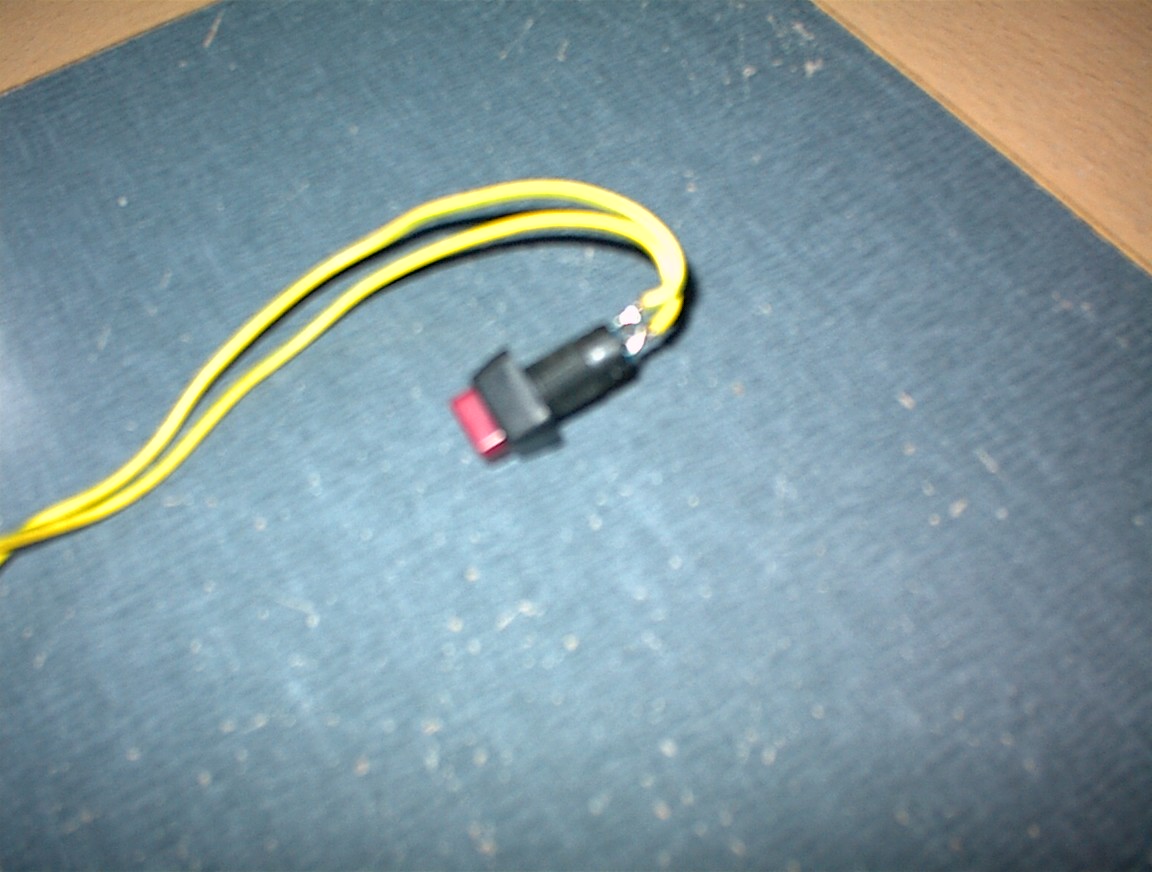

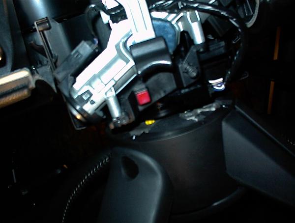

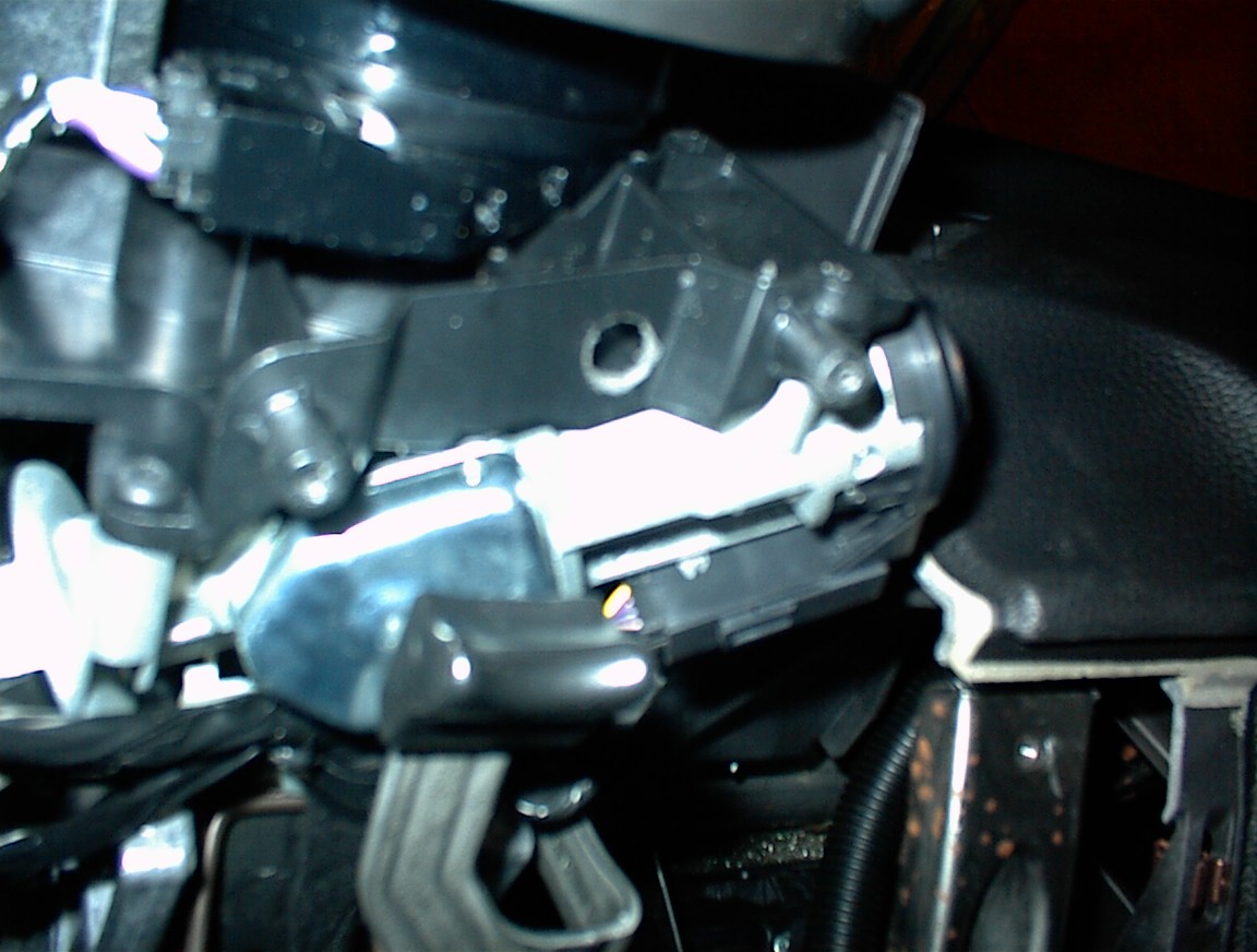

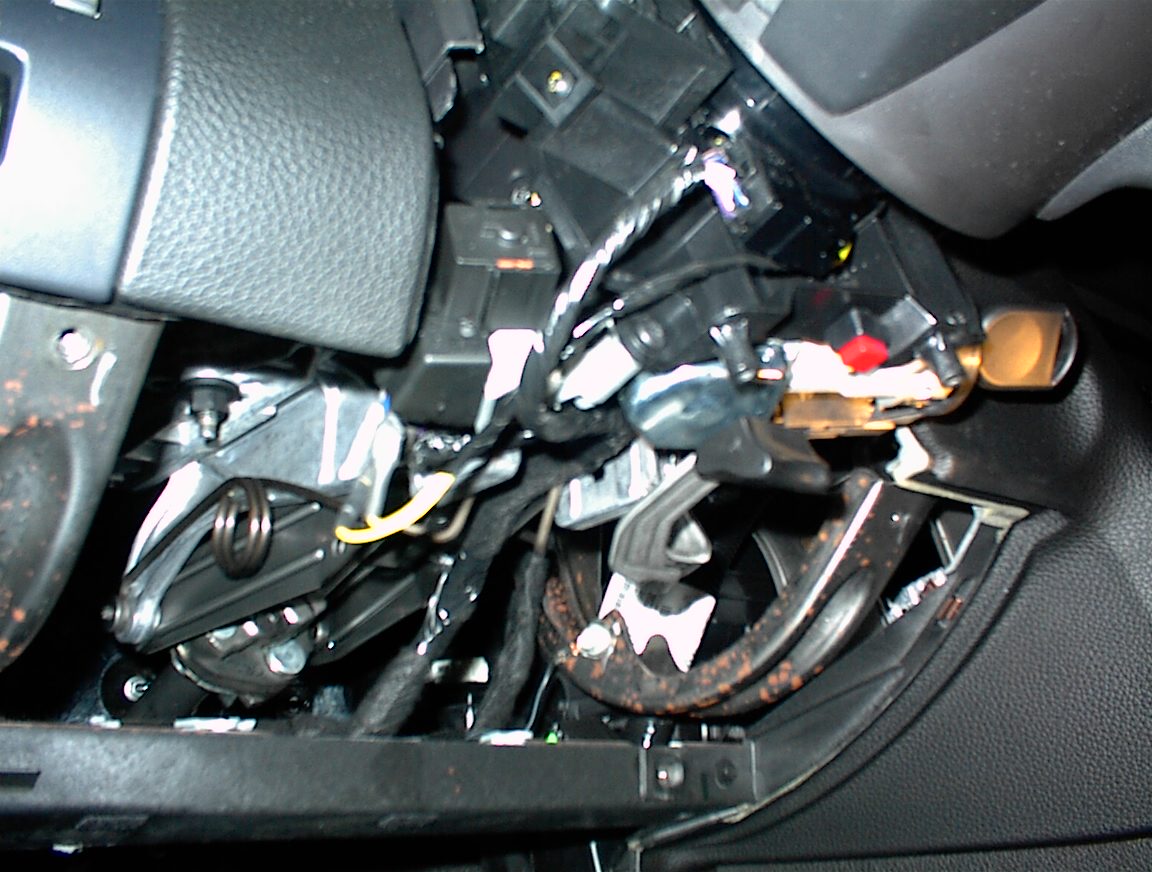

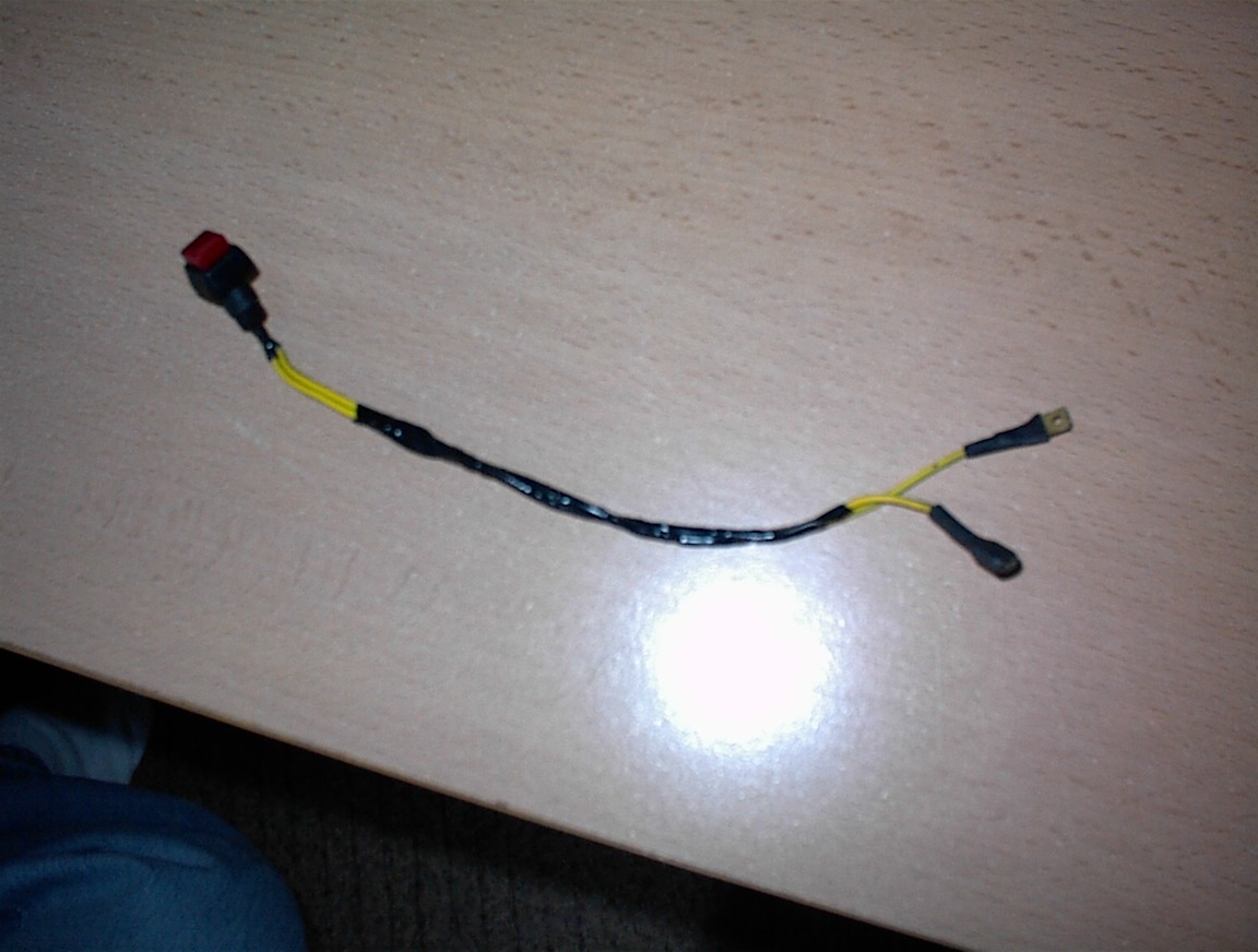

UPDATE ... spliced Key-In-Ignition sence wire and ADDED a switch
Wanted a "push on / push off" type switch and one as small as possible. Went to 3 different auto parts stores & searched McMasterCarr.com and found nothing so I finally went to Radio Shack. They actually had 3 different "push on / push off" switches. # 275-1565 was the most compact and thought it would be best and cost only $2.99.
I did not want to drill a visible hole to mount the switch so I was hoping to find a spot under the dash. I then noticed that the tilt lever slot was longer than the lever so I wondered if it would be possible to somehow mount it inside the tilt lever slot ... here it would be within reach of the ignition making it easy to find and push.
Well, I think I found the perfect spot ... there is a plastic structure just in front of the tilt lever and there was a hollow area above it for the switch body & wires. Carefully drilled a 3/8" hole in the bottom of this and the switch fit perfectly. Only problem is the retaining nut would have been pretty tough to tighten ... luckily switch is tight in hole so it is more or less friction fit and nut is not needed.
Spliced a pair of Male & Female spade terminals into the Blue / Gray Stripe wire in the ignition switch harness and plugged my switch assy's. Male & Female teminals into these.
Pics pretty much tell the rest of the story ...
Doug
