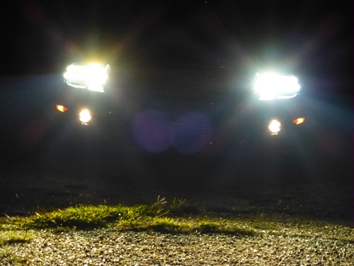

What's most impressive is how bright this dang thing is. Even with a DECHROMED/BLACKED OUT fog light housing, the brightness comes through. I can't imagine this on a regular fog light housing. That would be killer. My VLEDs that were on there I "thought" were bright, and you can't even tell they were on, with my new housings… With the XML2's, I can now turn my fogs on at night again since they "work"

Halos and XML2's on.
Halos only, far view.
Halos and XML2's on, far view.

In the GIF above, the total output is much greater, but there's not a lot of light shining way above the stock cutoff line, because the LEDs fire into the sides of the reflector instead of out of the front of the bulb.
This still isn't good enough to use as a headlight bulb, but it does quite well in factory housings because it doesn't put light directly forward, it still relies primarily on the factory reflector.
