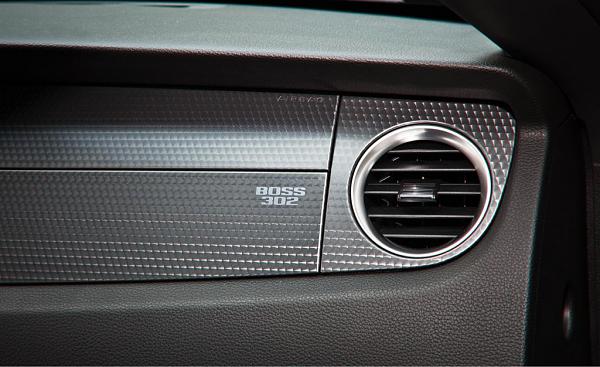

Hi folks - I saw a thread from a couple of years ago where someone swapped out their dash trim pieces and replaced them with the Boss 302 dash trim (dark aluminum - engine turned appearance).
I have searched on both fordparts.com as well as fordpartsgiant.com and none of the parts' descriptions seem to match what I'm looking for.
Any ideas?

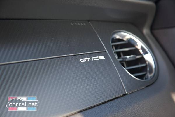

Originally Posted by Blown CS
Isnt the boss trim on the dash the same as a CS. You might look up CS parts.
No, the CS has faux carbon fiber. The Boss 302 dash is dark spherical brushed aluminum.

Thanks imeyers. So all you need is the left and right dash board air vent, and the dash panel in dark aluminum? How hard would they be to install?

It looks like it's a separate piece, because they want $11 for it. "Instrument panel cover w/ Boss 302"
Also, they don't show #5 witch surrounds the speedo, tach, and left vent. Where is that at?

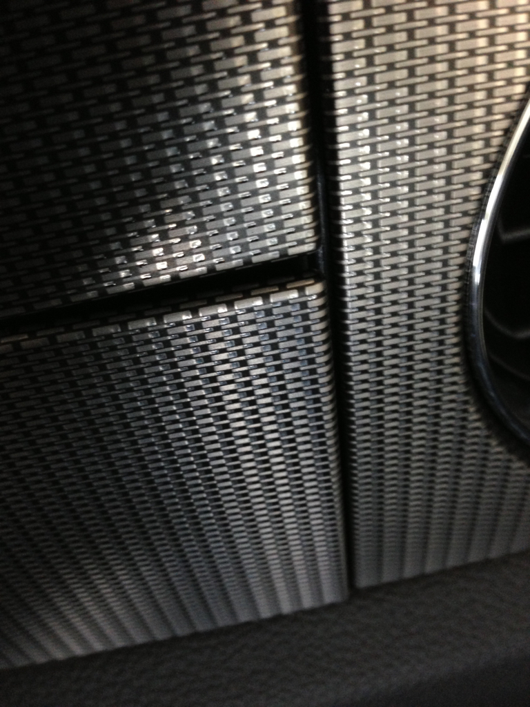

I'm thinking about just doing the 401A panels too. I don't want the Boss 302 logo on that panel - I wonder if it's etched or a sticker.
The 401a panels are different than the premium? Ok I have those then. I've seen two others in person like mine too. A boss with the top piece lifted and another 401a with the bottom lifted.
But when I see stock photos like above with it all flat it makes me crazy.
I wonder if it's just an install thing. Maybe a clip is off. Even though I push on it and it doesn't help.
Guys:
Instrument pops right off.
Remove the glove box
Remove the two screws for the airbag
Gently push passenger airbag out
Remove screw for passenger vent
Remove both screw for middle vent
The airbag cover is one piece and held together by fabric. Little you can do, except a new one. Or try to take the unit out and bend it in place
